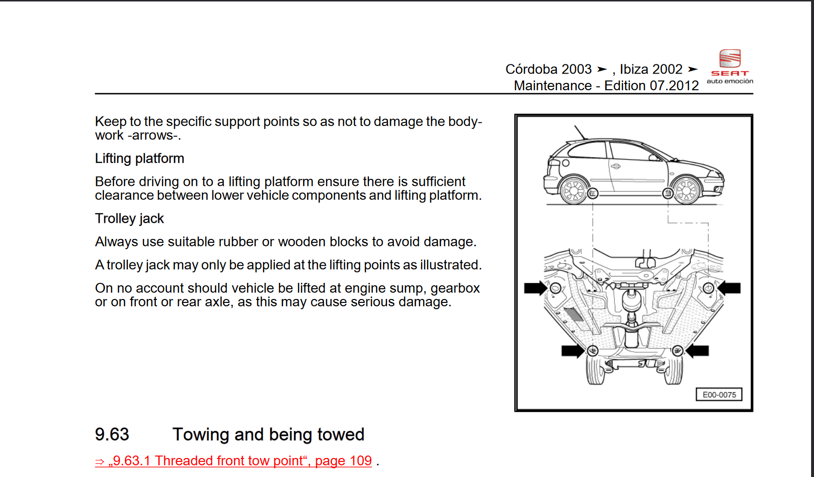

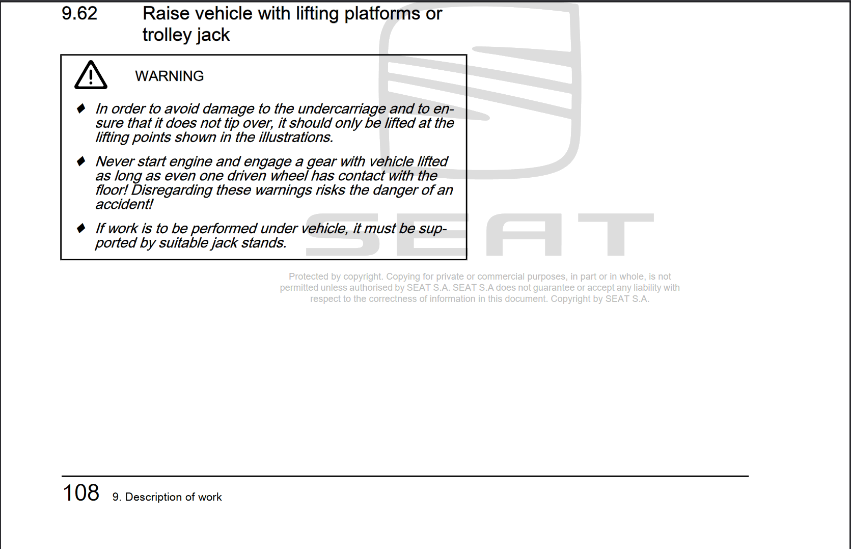

According to the official repair manual these are the locations,
Screenshot 2023-05-10 at 01-50-01 VSSZZZ6LZ4R215951 - Ibiza 2004 VSSZZZ6LZ4R215951.pdf.png
Screenshot 2023-05-10 at 01-50-13 VSSZZZ6LZ4R215951 - Ibiza 2004 VSSZZZ6LZ4R215951.pdf.png

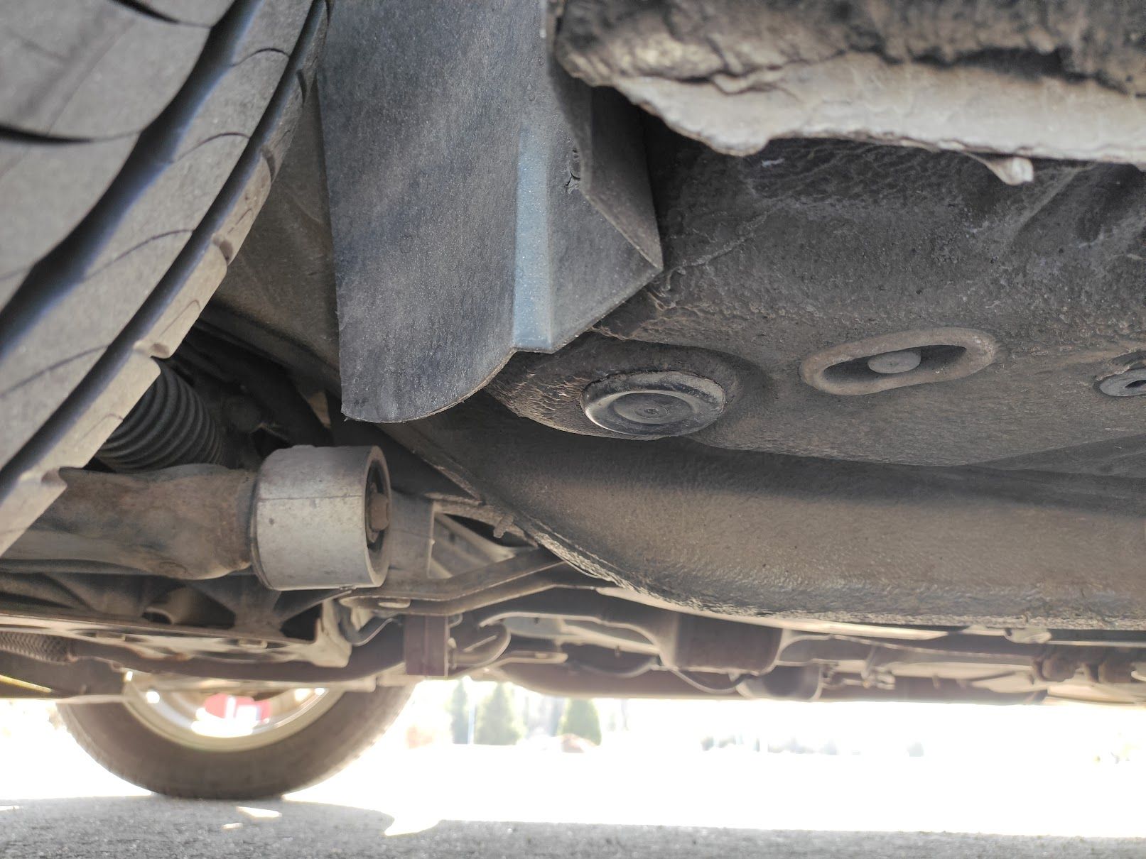

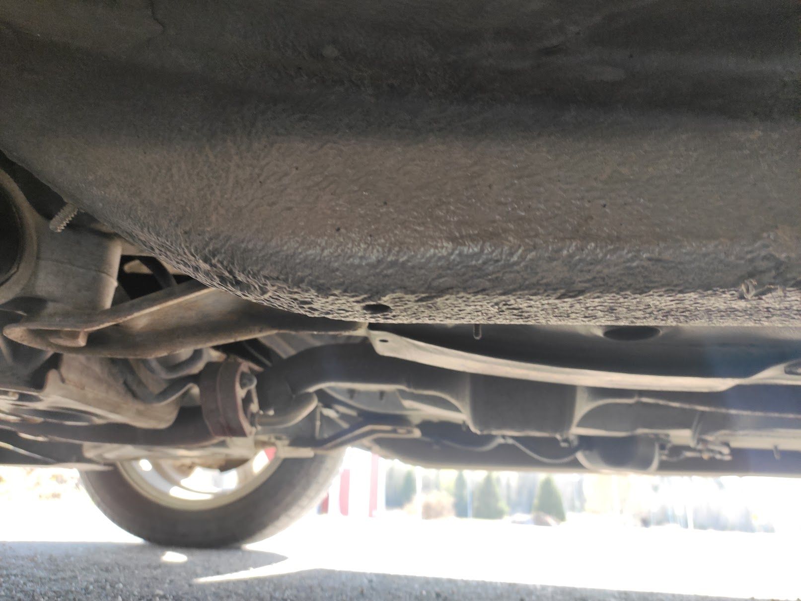

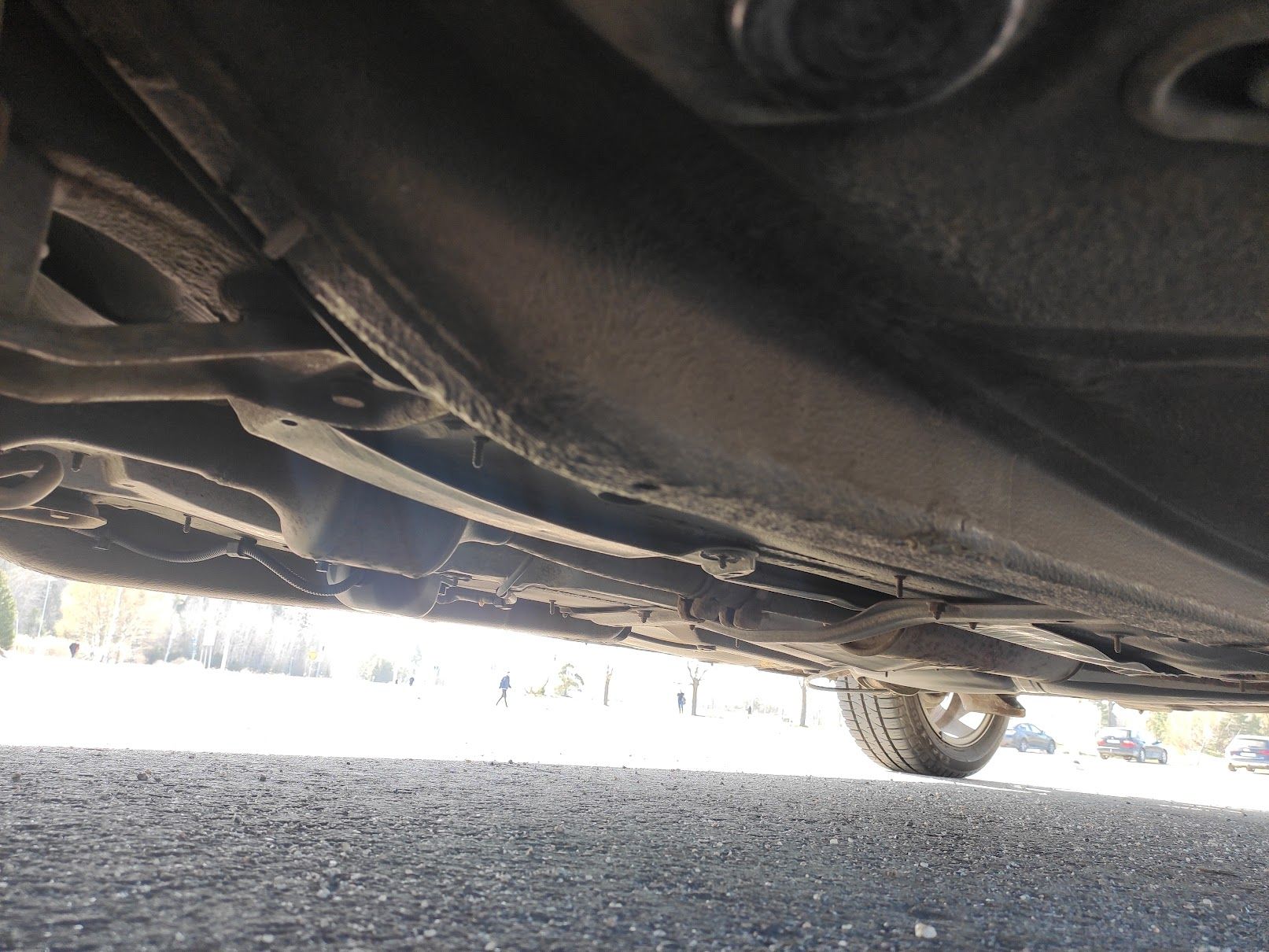

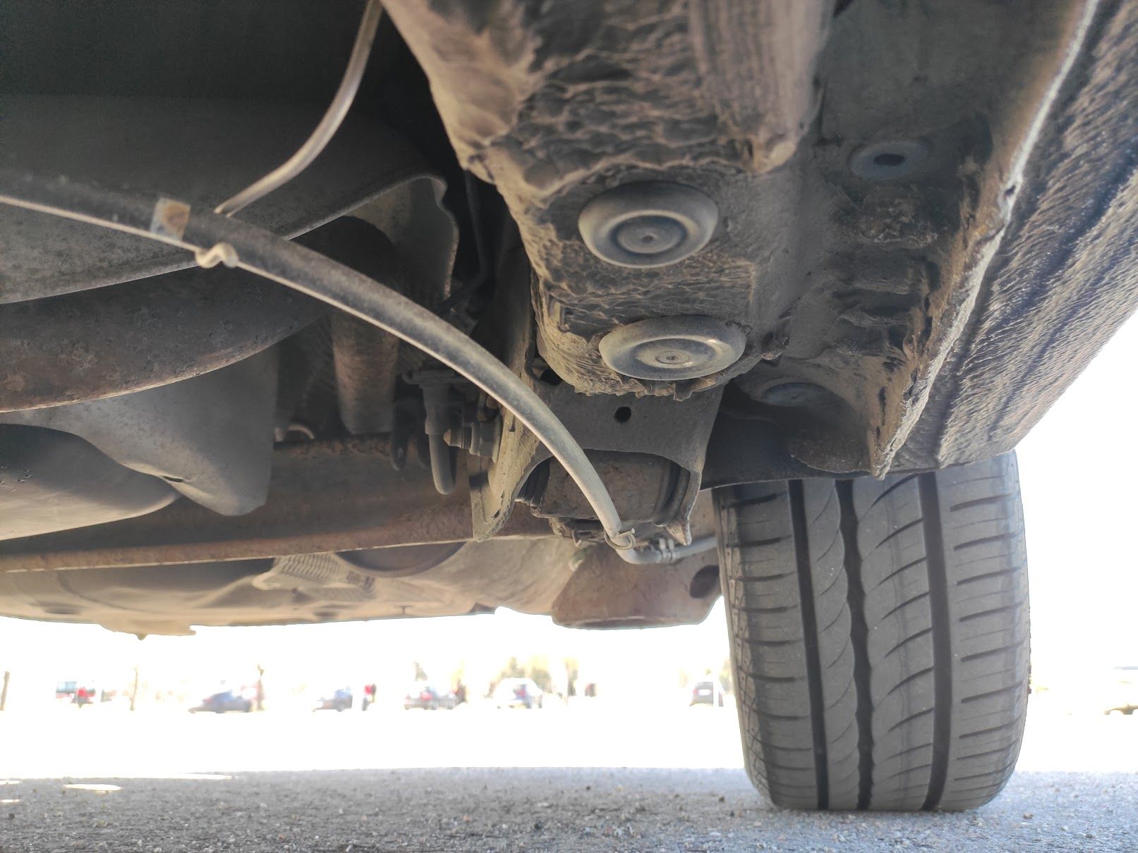

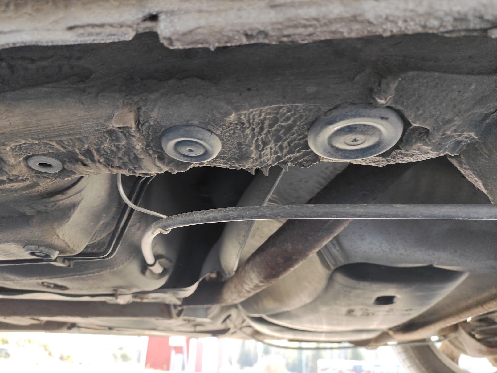

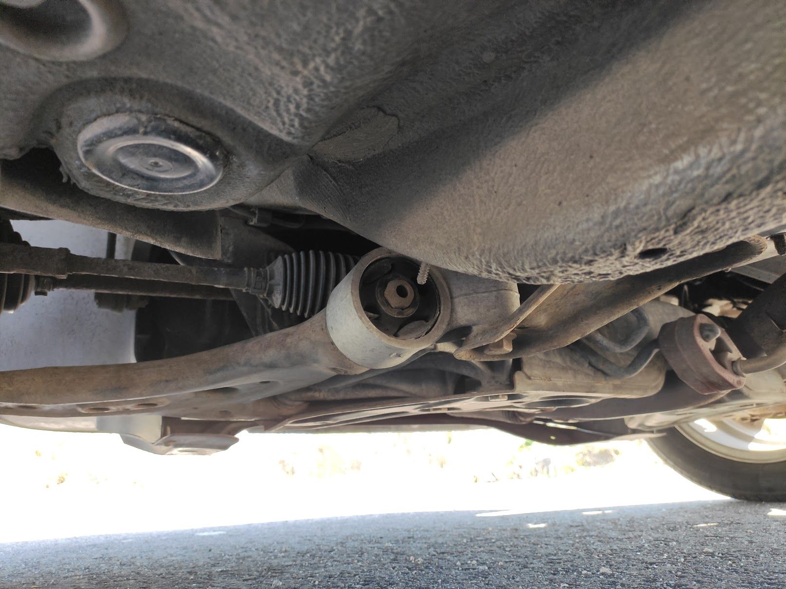

As you can see the image is extremely unclear, where exactly are these points located? Here is a few pictures from under the car of where I suspect they should be, covered by rubber pads. Assuming they're the correct locations for the trolley where do you then put the jack stands?
Front:
Back:
Also according to some videos I've seen it seems that you can put jack stands under the chassi rails even though it's not on the official manual

I see what looks like rubber bungs all over the underside of the car, but you mean that those big round ones in the picture are plastic bungs you can lift from? Do you need to install any adapters or can you safely lift from those bungs as is?
RUM4MO
Jun 4, 2008
8,099
1,117
South Scotland
I think initially, VW Group designed into the body shell of their cars to make it easy to lock onto or secure the car body shell as it moves around the initial build areas of the assembly plant, but that also means that the body shell is stronger at these 4 points. This has meant that all the smaller cars, Audi TT maybe Golf etc and smaller, can when fully assembled, be lifted and/or supported using these 4 points.
I've always fitted jacking point adaptors so as to not cut through the protective paint and coatings that were applied in the factory, if I was going to lift up these cars without fitting jacking point protectors, I'd just try to find strong points closer to the outer edges of these cars, usually close to or on the ends of the subframes at the front and close to the swinging arms attachment points at the rear.
If you look under the car you should find some areas that look like they are stronger/safer to use than others - if not, play safe and buy and fit a set of 4 Audi TT Jacking Point protectors.
