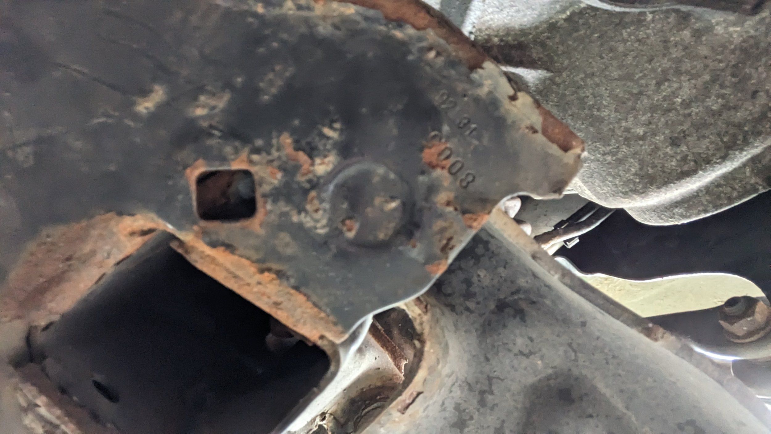

Anybody know what and where I can something to fit these rectangular holes, please??? They clearly line up with round bolt holes in the engine heat shield but can I hell work out how to "put a round peg in a square hole" so to speak!! Thanks in advance.

Maybe it is a sort of snap in plate with a self tapper style threaded hole in the centre that you need.
I've forgotten which part these plates are fitted to, so until I find that out I would never manage to find a part number, if you know exactly which part they are fitted to then maybe get your local VW/SEAT/Skoda dealership to order some in for you and report back with the part number so that others know it.

Is there a bolt missing or is it just a plug that goes in.
Is it supposed to have anything in it?

Many thanks for the advice......both on the car and the thread!! I think I "may" have found something.....it helps if you look for "skid plate" fixing kits rather than "heat shield" ones! If only I knew what I was talking about!🤣🤣

I've found a "skid plate fixing kit" rather than a "heat shield" fixing kit.... There's 3 fixings within the kit that look promising.....the things you do for your kids when they have a crash!!

Ah ok, there are plastic push in thingies which open up when you screw a self tapper in.
The ones for the under cover are made from steel as they need to be stronger than the ones that you have described which tend to be used in/under wings etc to secure plastic wheel arch liners.
