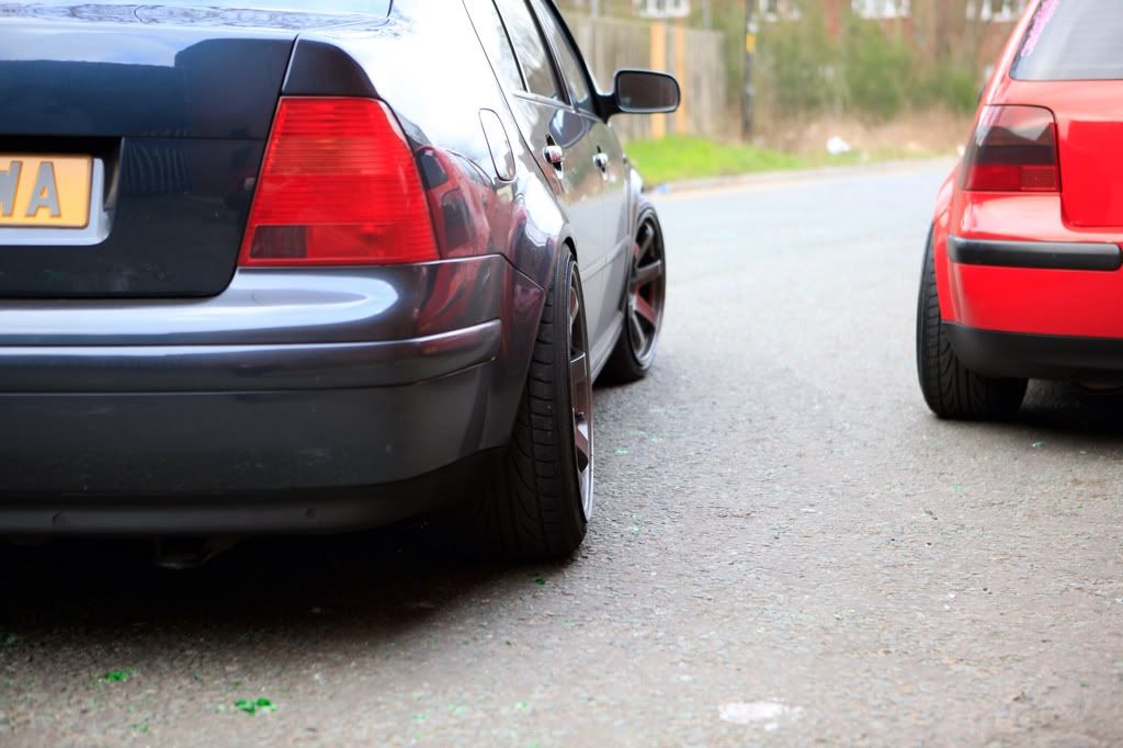

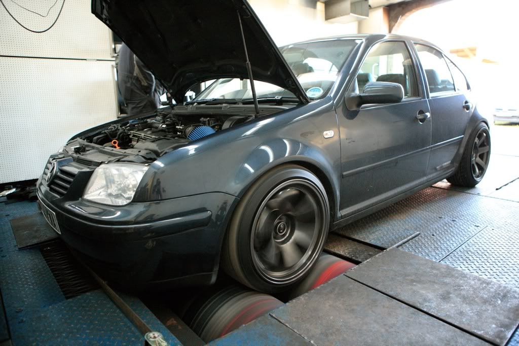

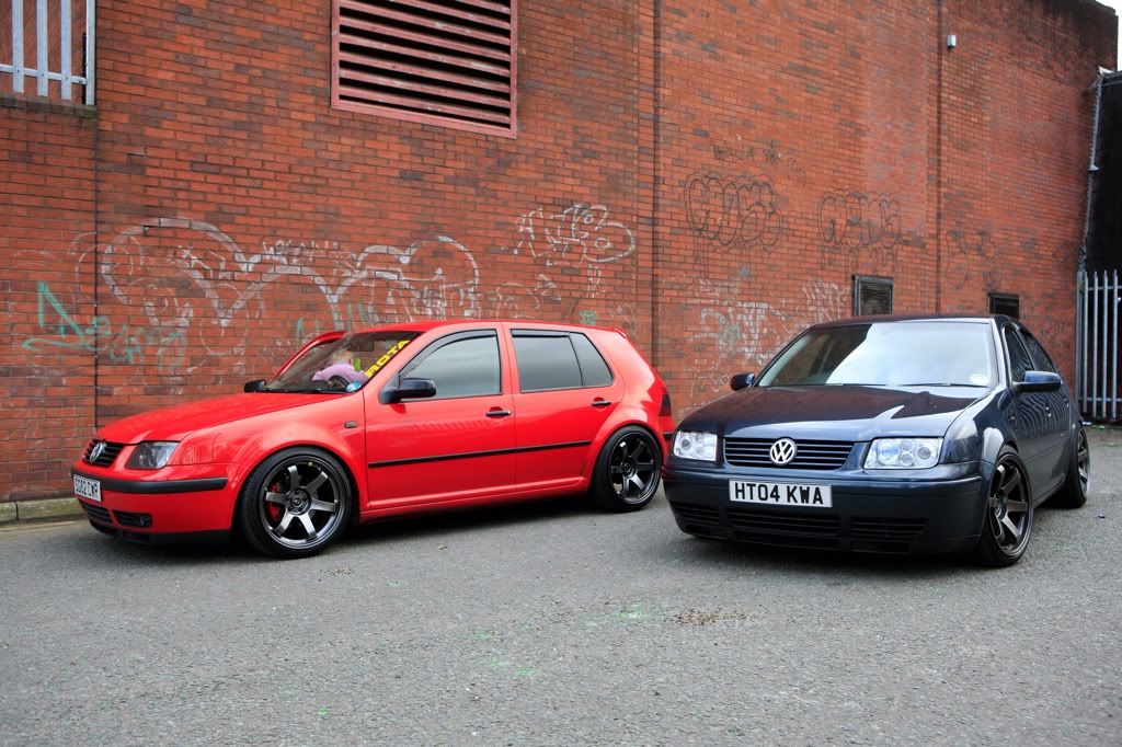

Here's my Bora, and my Brother's Bolf, on 18x9.5 et35. No spacers, the inner lip of the front wheels touched the coilover body slightly, I solved this by grinding away the threads at that point.
In these pictures I have 2.5mm washers under the bottom bolts of the rear stub axles on the Bora to give some camber and allow more clearance at the wheel arch. I don't recommend running that much camber though, it ****ed the tyres in 6000 miles and handled like a half filled bath.
Note, these wheels are not for drivers, they're for posers, don't expect to be able to corner very quickly unless you're planning on pulling the arches a fair bit.
No Rear Camber shims fitted in these pictures:
