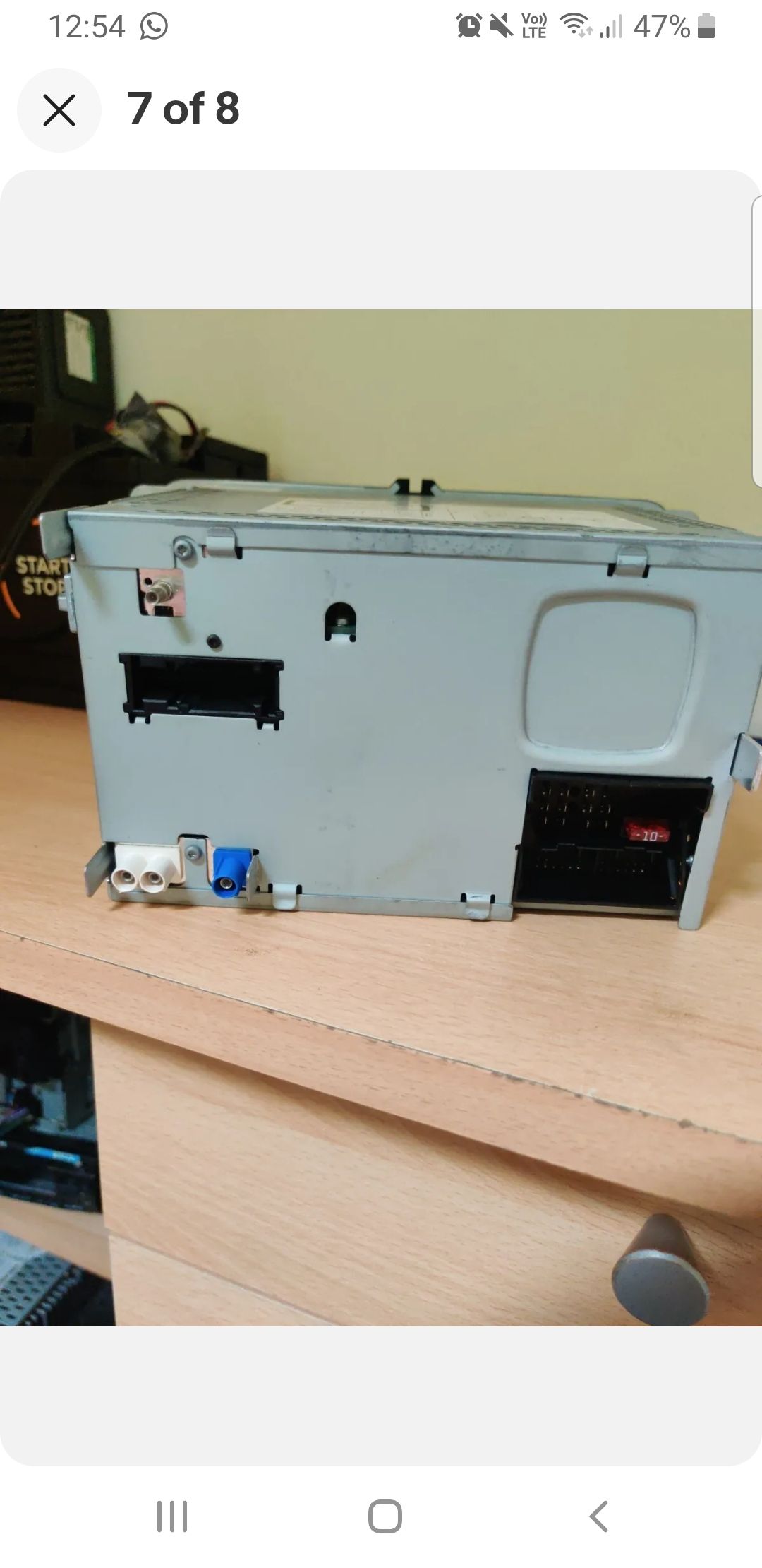

Looks like female. Thanks for the links and info. You've been a massive help. EDIT - infact that's male isn't it! So I'd need female to male

I can't see inside the connector is there a hole or prong. It's not the plastic part that denotes male or female on those

I can see the top connector(nav) is male so assuming the blue dab is the same you need female to female.
Bingfu Fakra Z Water Blue Female to Female Vehicle Aerial Antenna Extension Cable 3m for Car Stereo Android Head Unit GPS Navigation FM AM Radio DAB Radio 4G LTE TEL Telematics Bluetooth Module https://amzn.eu/d/97baTdS
I think 3m is the best bet, I can measure but you are looking at the rear to the a pillar, down to the footwell and to the centre of the dash

White double connection is your fm radio. Depending on what you have when you take it out its either like for like or you need an adapter

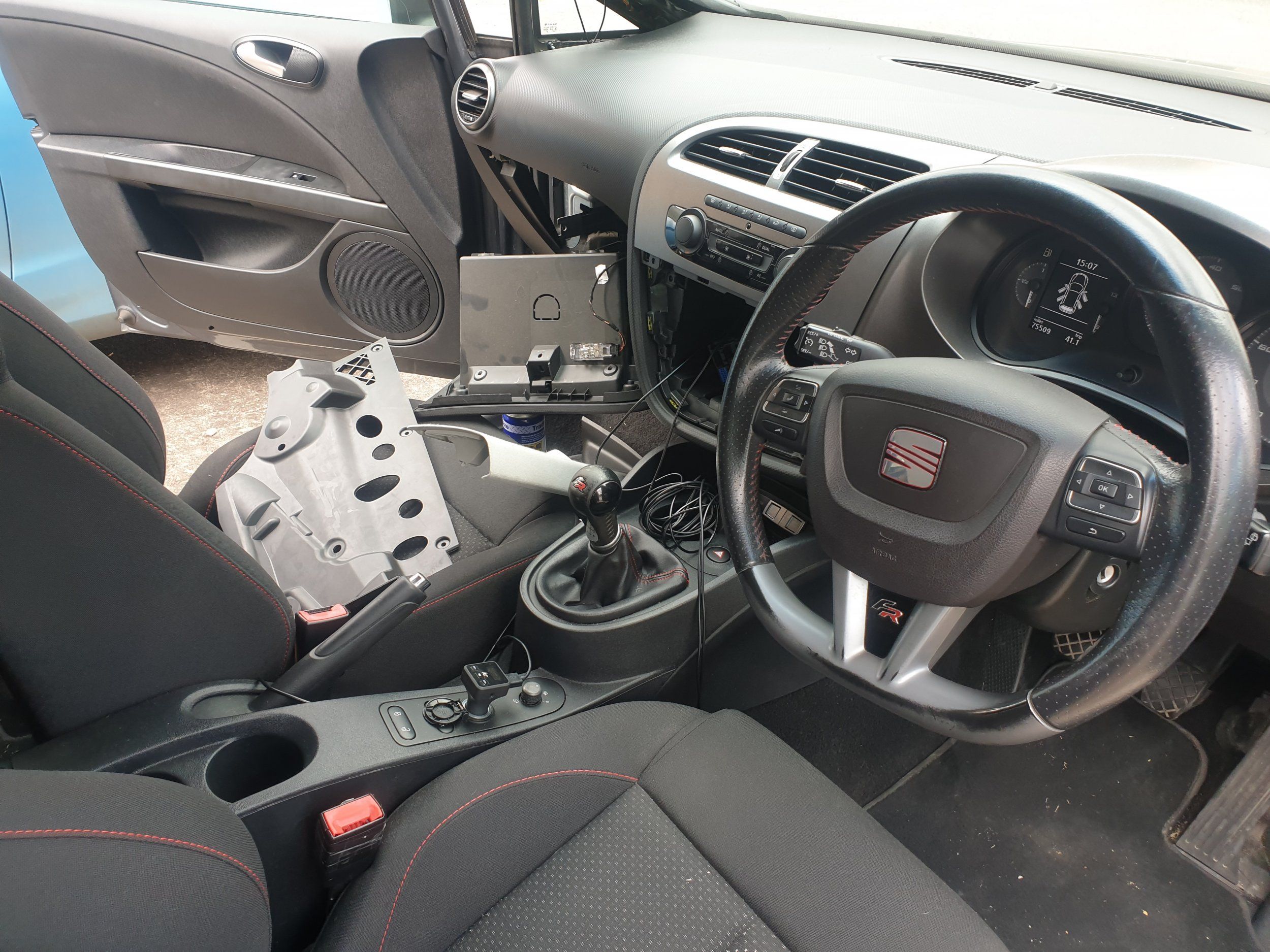

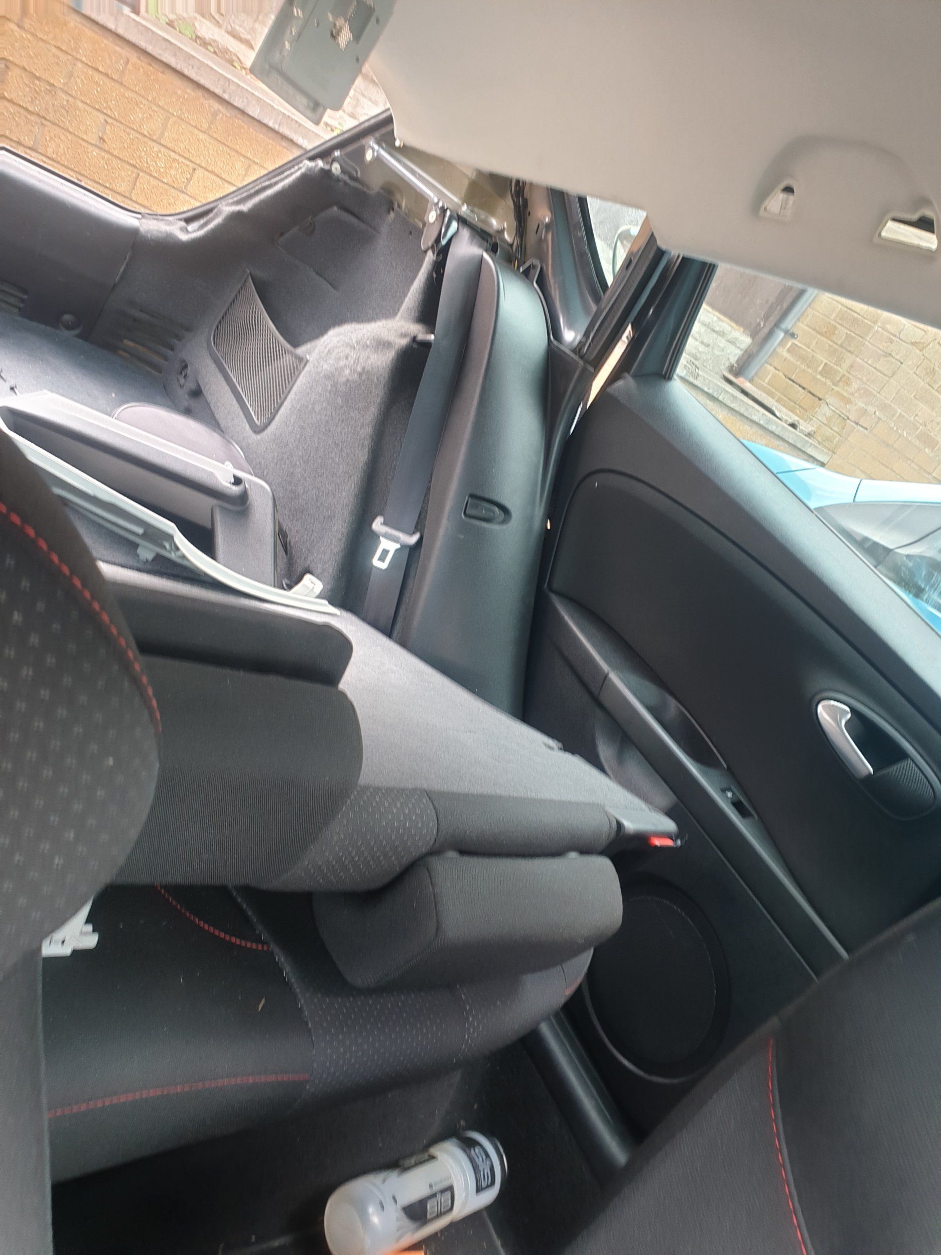

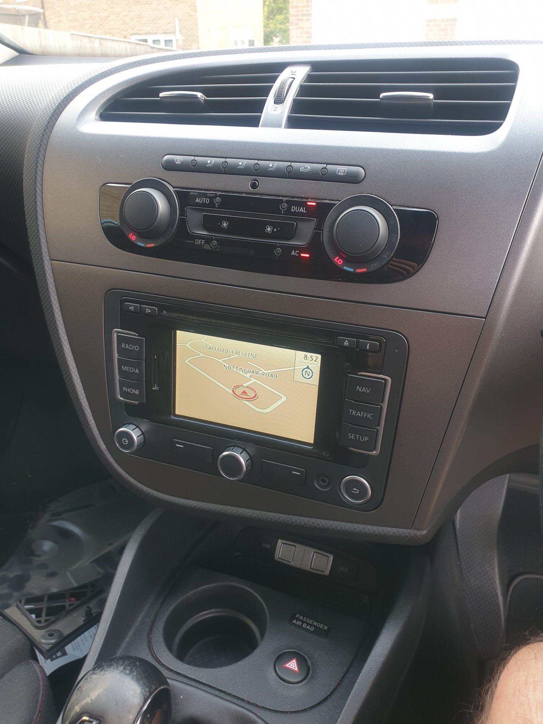

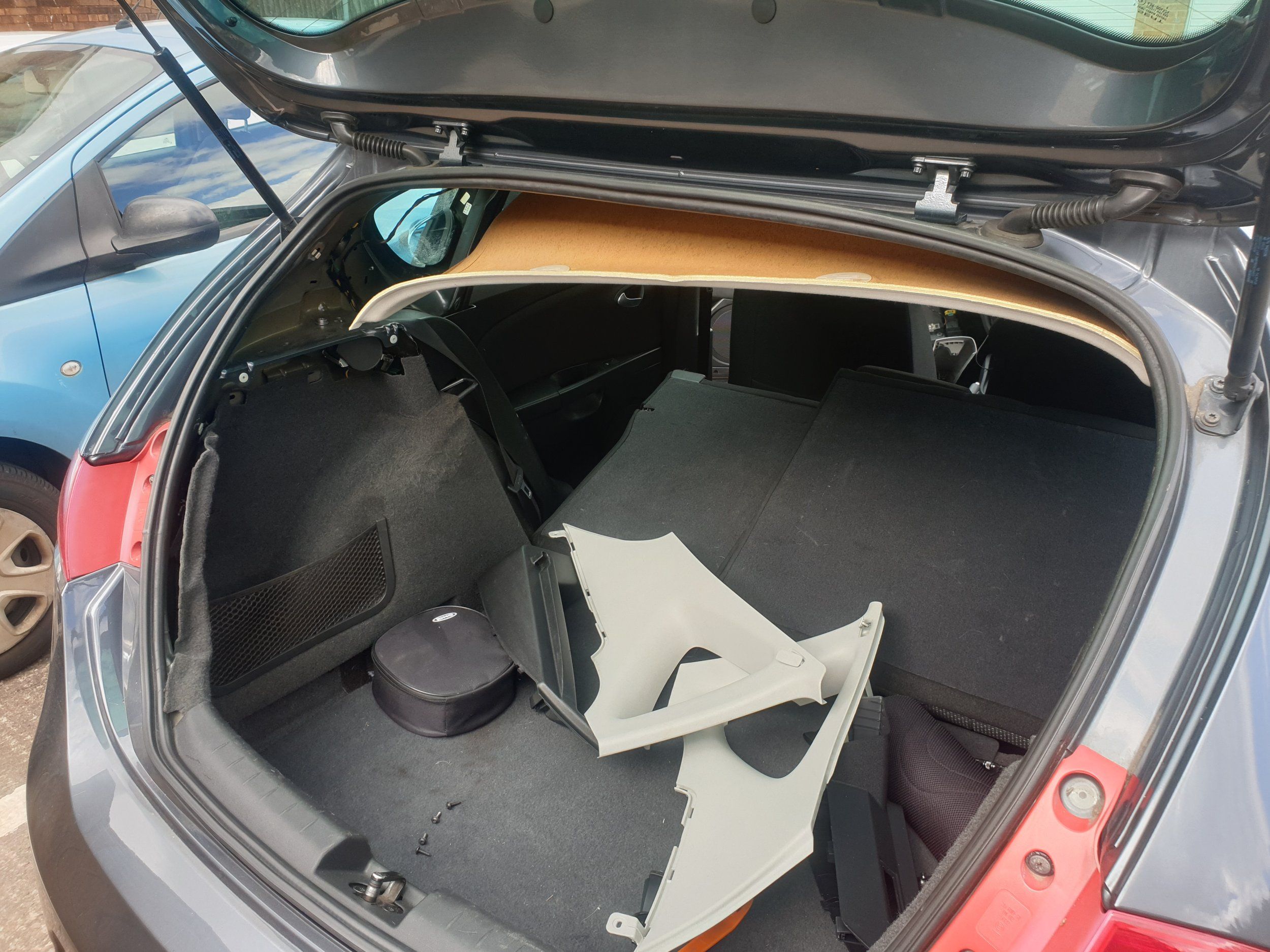

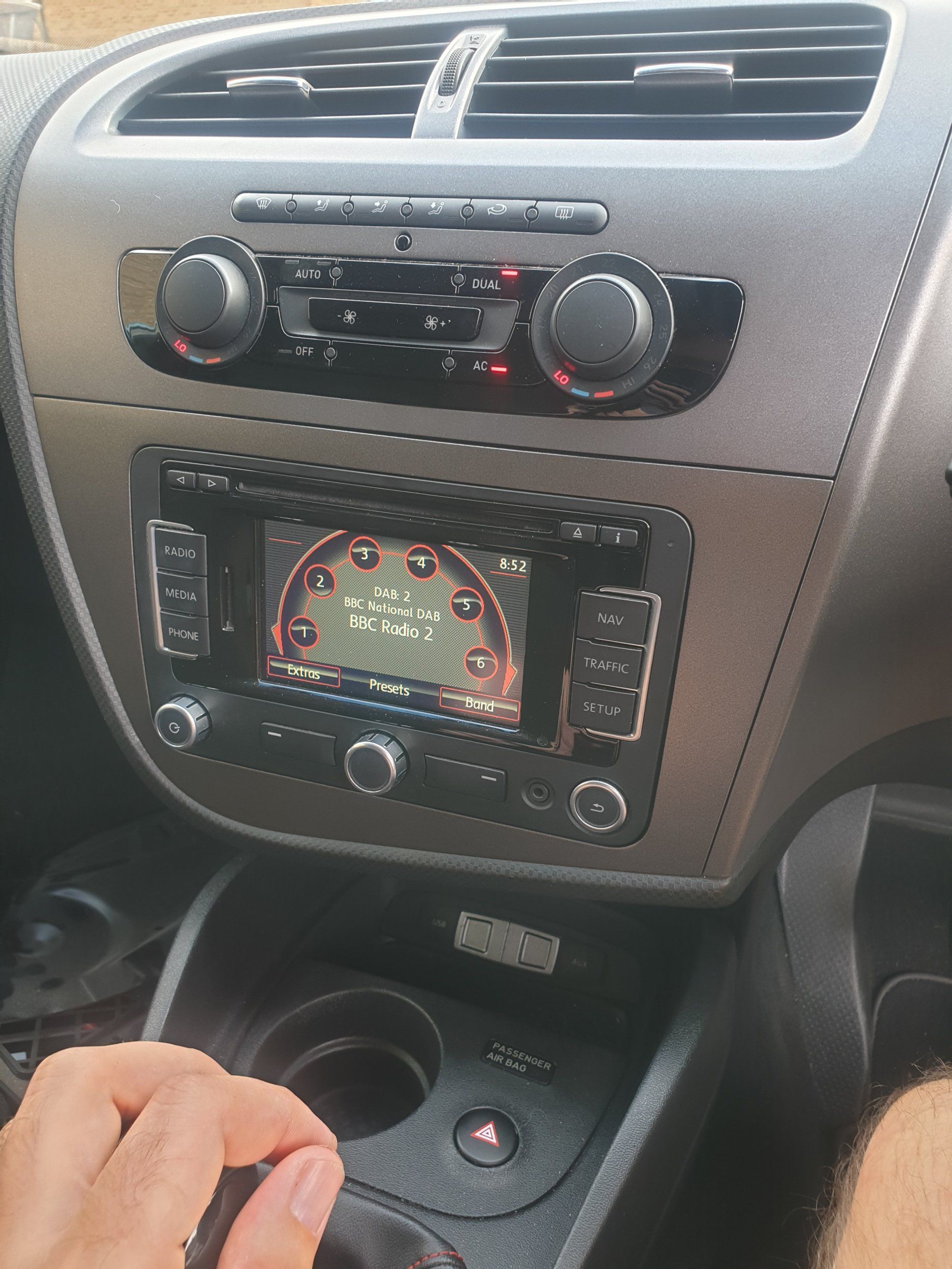

Update!
That's it all in, fitted and working! What an absolute pig of a job! Has basically taken me all day yesterday and a bit of this morning...
So first impressions are great! Sounds much better, sat Nav works although I'm guessing it'll need an update?
I've managed to connect my phone via Bluetooth but when I call someone they can't hear me?
Am I going to need to use VCDS to set unit up properly... I've heard you can make it so that your revering sensors pop up on screen?

Looking good, epic job to do in the end.
I used VCDS to put my sensor as a visual display. It was a long time ago and I'm not sure what I did now lol. I'm sure there will be a guide on here or elsewhere as that's how I knew about it.

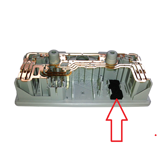

I wonder if you need an external microphone? My 310 is factory fitted and I believe there's one in the A pillar.
R3k1355
Oct 30, 2014
1,817
258
Yorkshire
Microphone should live in the plastic trim bit by the rear-view mirror/cabin lights.
Run the cable up the A-pillar
