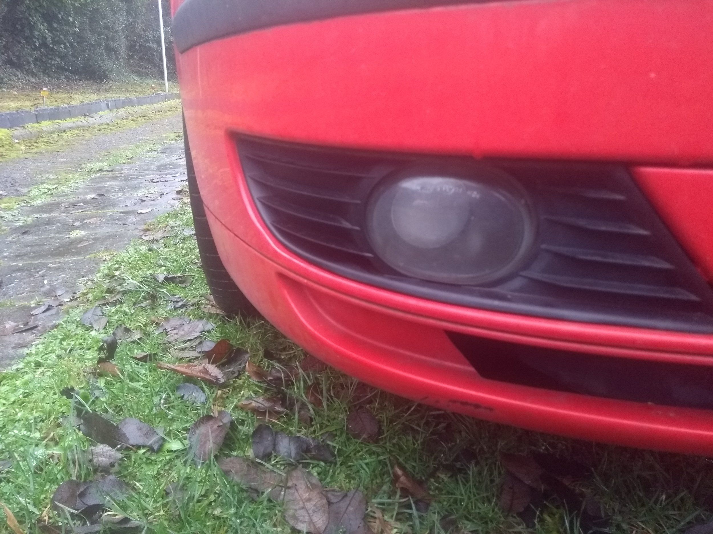

I do have a multimeter, but I have no idea how to get to the bulbs in the front fogs.

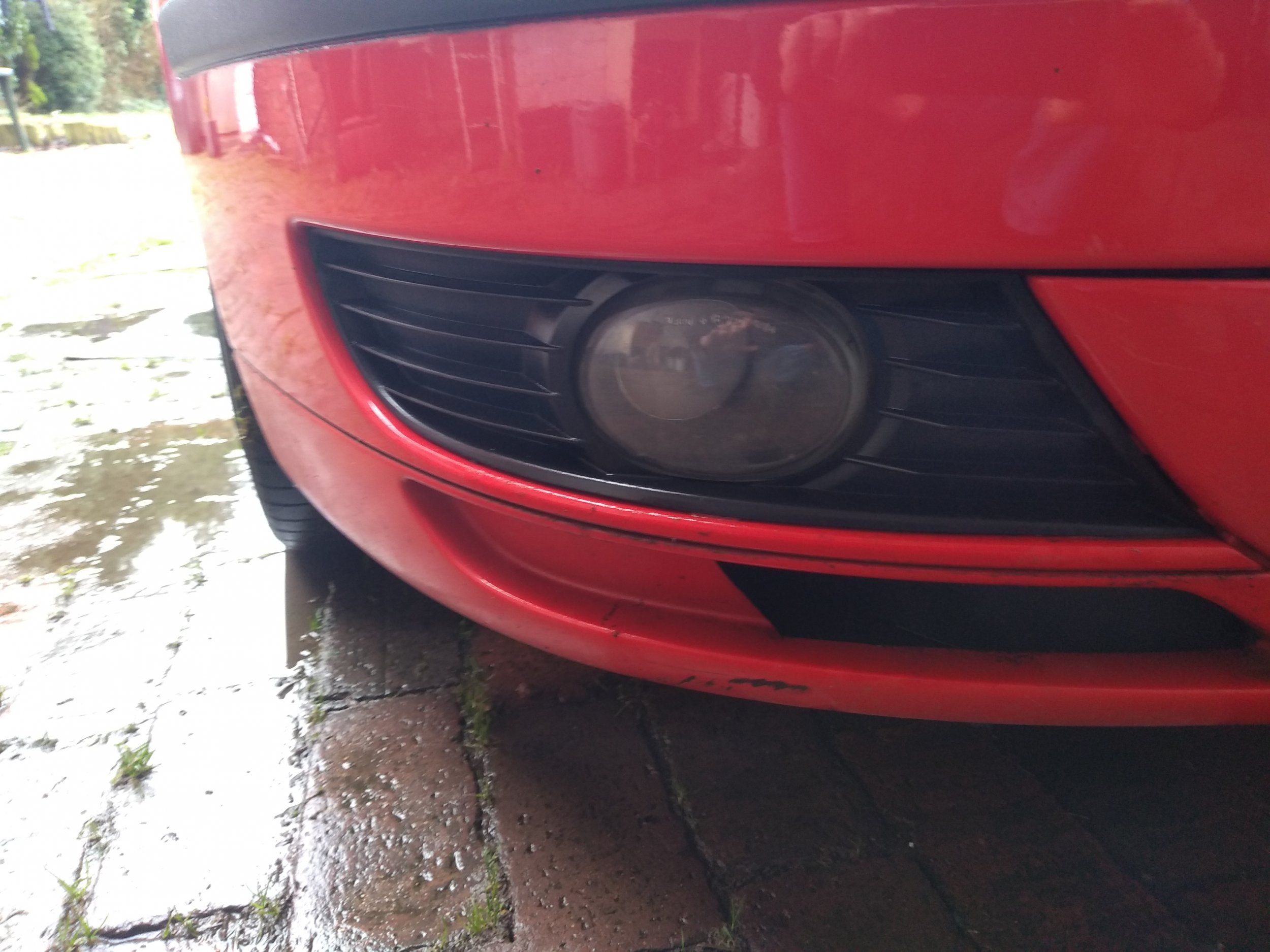

Well, I've tried a brand new switch and it's made no difference.
All the rear bulbs and connectors are clean with no corrosion.
Do I have to access the front connectors from underneath the car ?
