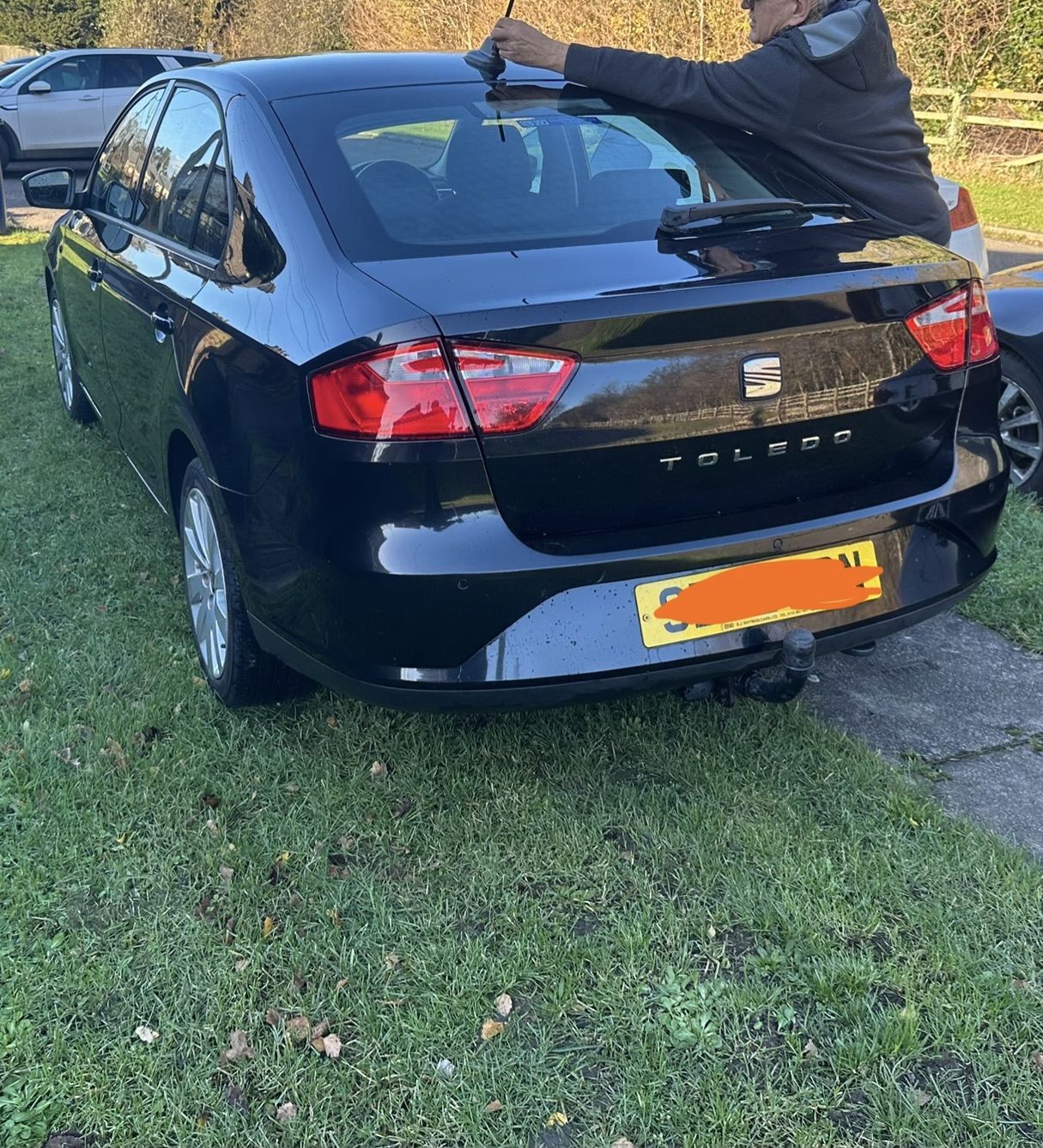

Hi, I recently purchased a 2012/2013 seat Toledo IV 1.6tdi, after taking it through a car wash the rear driver side footwell had a small but pretty wet puddle on the carpet, anyone with a Skoda rapid or Toledo experienced this, if so where did you find the water ingress coming from?

blocked vent holes bottom of door. 2012 2013 notorious for wet interiors
either too much sealant or rubbers around drain need trimming.
