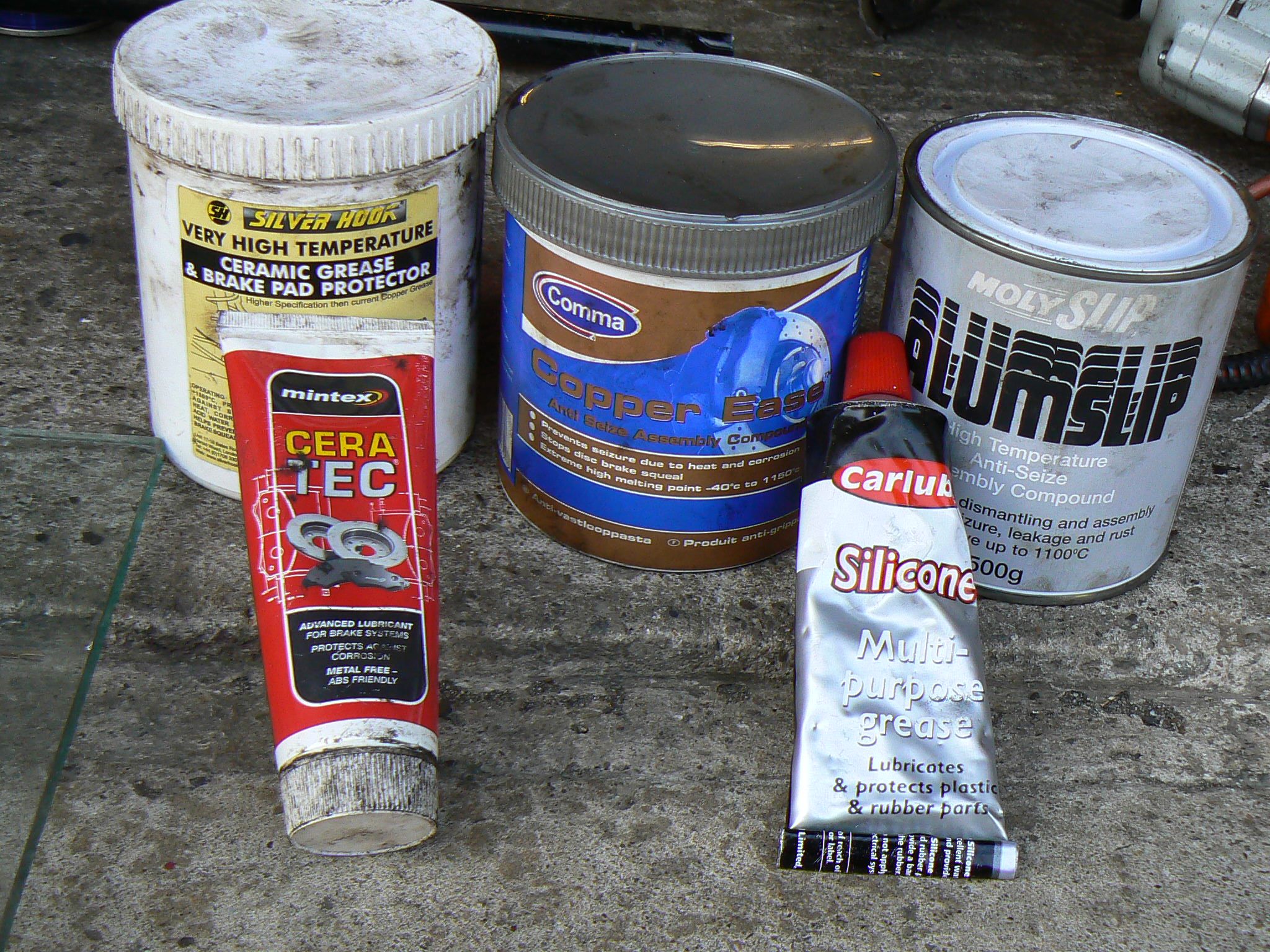

Hey, I did exactly that (the return spring thing) on my older boy's Fabia. Worked a treat!
Enclosed is a wee "pick 'n mix" of my anti-seize "helpers" Not too sure how to do the picture thing yet so hoping it'll come through

I recently bought a tin of the aluminium loaded one (not MolySlip branded though) but so far it has not been used, my silicon one was a cast off from when I worked, it had reached its QA expiry date so I saved it from being binned, a bit like many of the Loctites I acquired the same way!

I bought the Alumslip when I took the injectors out of my old 1.9 VE tdi Cordoba. I wanted to minimize the possibility of them corroding in place and thought an aluminium product in an aluminium head was just a good idea. Despite owning the car for several years after overhauling the injectors I never needed to remove them again so I've no idea how effective it was! Just another "soldier" in my cohort now. You'll notice my Copper product is not the Moly brand and I have to say I much prefer the consistency of the Moly product.
