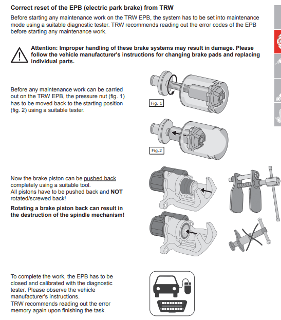

You can in theory un bolt/pull the actuator off the back of the caliper and wind back the screw - and then push back the piston to fit new pads, this is called an emergency release.
The problem though is re-assembling as you need to do an "Electronic parking brake (EPB): initialisation" with a scan tool - which re-calibrates the actuator.

That is what the work shop manual states.
I have no idea on the actual algorithms and the process the EPB goes through during this initialisation process, or if the caliper will eventually learn the correct pressures/time/distances etc.. But they aren't cheap calipers - so I wouldn't want to find out the hard way!
Some cars have some button presses/clicks sequence to carry out this initialisation process without needing a scan tool - but not aware of this for MQB cars?
VAG use a TRW EPB - see their datasheet also stating needs to be closed and calibrated using a scan tool:
