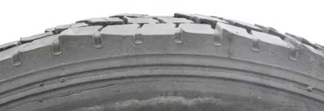

Check the inner tread on the rear tyres. If they’ve worn in a stepped, sawtooth pattern they’ll produce a sound very similar to worn wheel bearings. You can often see the stepped pattern - if not you should be able to feel it if you run your hand around the inner tread of the tyres. I had this issue on a mk5 Golf many years ago.
Sawtooth tyre wear - also known as cupping - is quite common on cars with independent rear suspension.

Yeah that's never right, the PS4's are a pretty quiet tyre - so definitely wants investigation... SRGTD has definitely pointed to the likely culprit, you shouldn't need extra sound proofing to filter it out!

Checked this morning. Not immediately obvious visibly. Run my hands around seem the same front and rear. Blocks on the inner and outer have a very slightly sharp edges all the way round. No distinct raised bits as the cupping.

My bet it is the tyres. I had this on a Golf and as soon as I changed the tyres it went away. Try swapping the tyres front to back to see if the noise moves.

I had this from new on my Mk2 Leon. Turned out the wrong suspension geometry was used out of the factory and caused sawtooth wear on the tyres.
New tyres solved the issue but would have come back if I hadn't had the suspension reset.
I'd get that checked first before changing tyres otherwise the same will happen to those!
