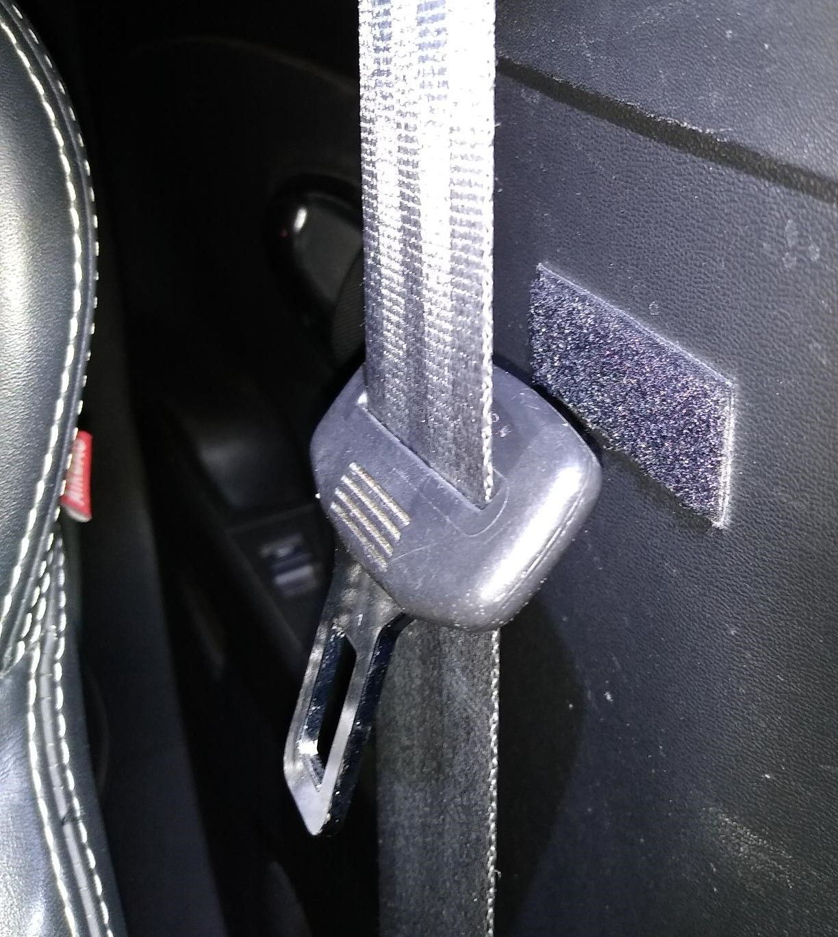

I've just remembered another rattle find and fix that I did years ago. It was an occasional light tapping sound over rough ground, worse on slopes, and not all the time.
Fairly quickly I worked out the same sound was made by the unused passenger seatbelt buckle knocking into the door pillar plastic. There's not enough tension in the belt to prevent a small swing in the buckle when the car gets a bit of a wobble on, and the door pillar is made of hollow plastic so easily sounds off.
To fix my problem I stuck a strip of velcro (the soft loopy side) in line with the buckle top, which then has just the right cushioning to keep it quiet but not otherwise get in the way.
