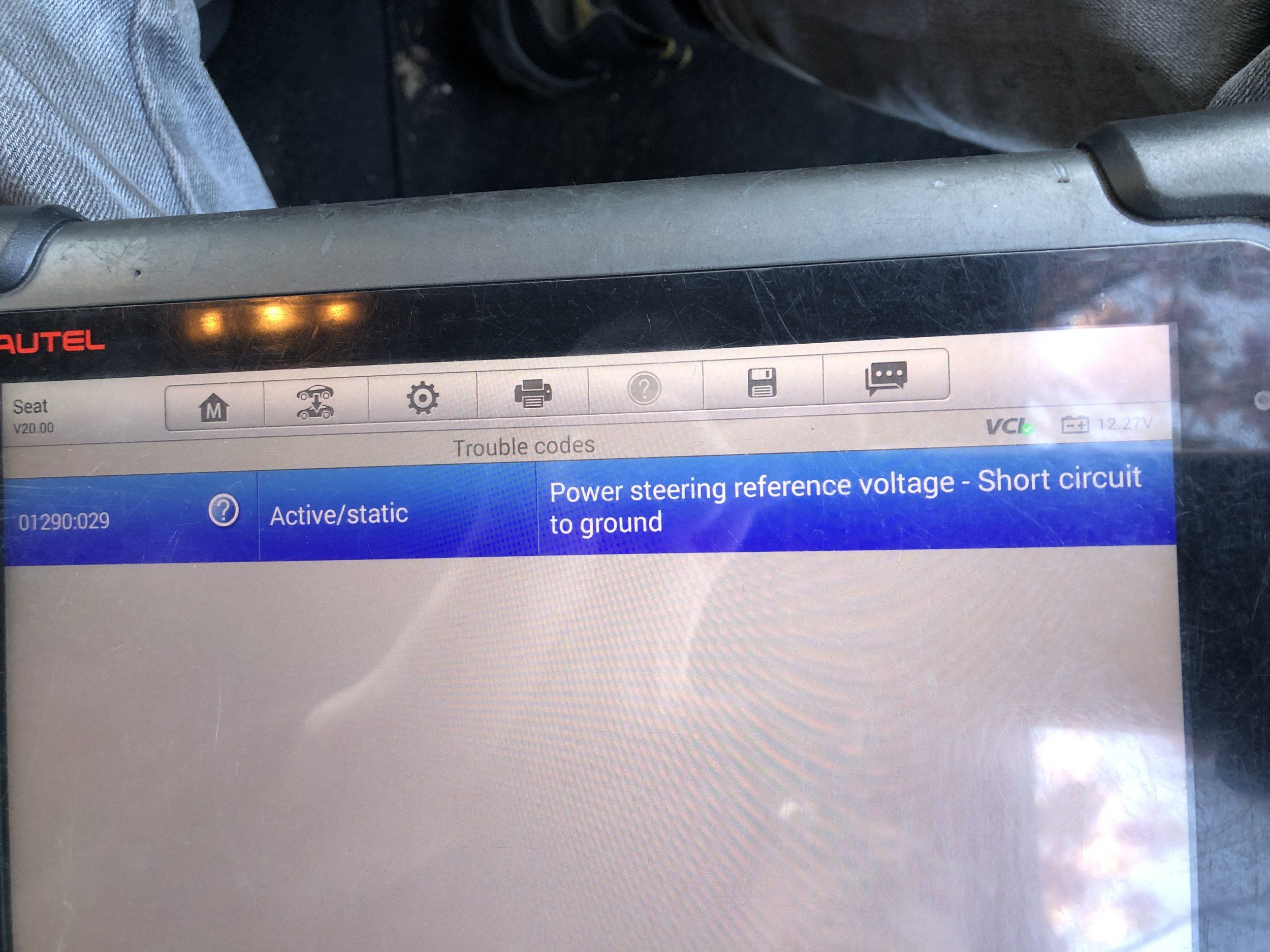

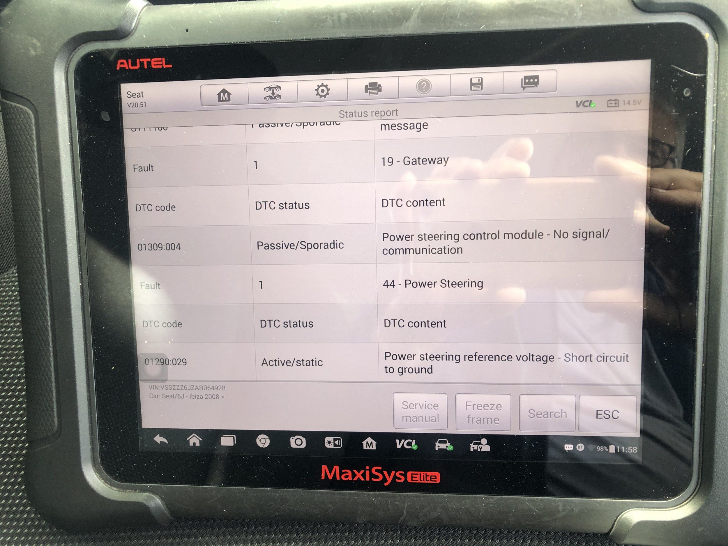

The only common, and pretty much permanent fault stored is this:
Note the battery voltage in the top right corner, at this time it was as the car arrived and reflects a lower state of charge, so I charged it and rested voltage went to 12.7
I checked battery terminals, I also took off the NS arch liner and under tray to check a wire/connector in front of the gearbox to see if it was chafed or damaged as well as those to the PAS pump having read in general searches on it that there was some issue for that connection on some cars
I've not checked any continuity for anything, as I have no info on what to check from/to, or if I did, what I should expect to see, although I have probed the pins to see where there is battery voltage, which seems consistent even if the connectors are moved around implying a lower likelihood of a break right near them, albeit a vague approach

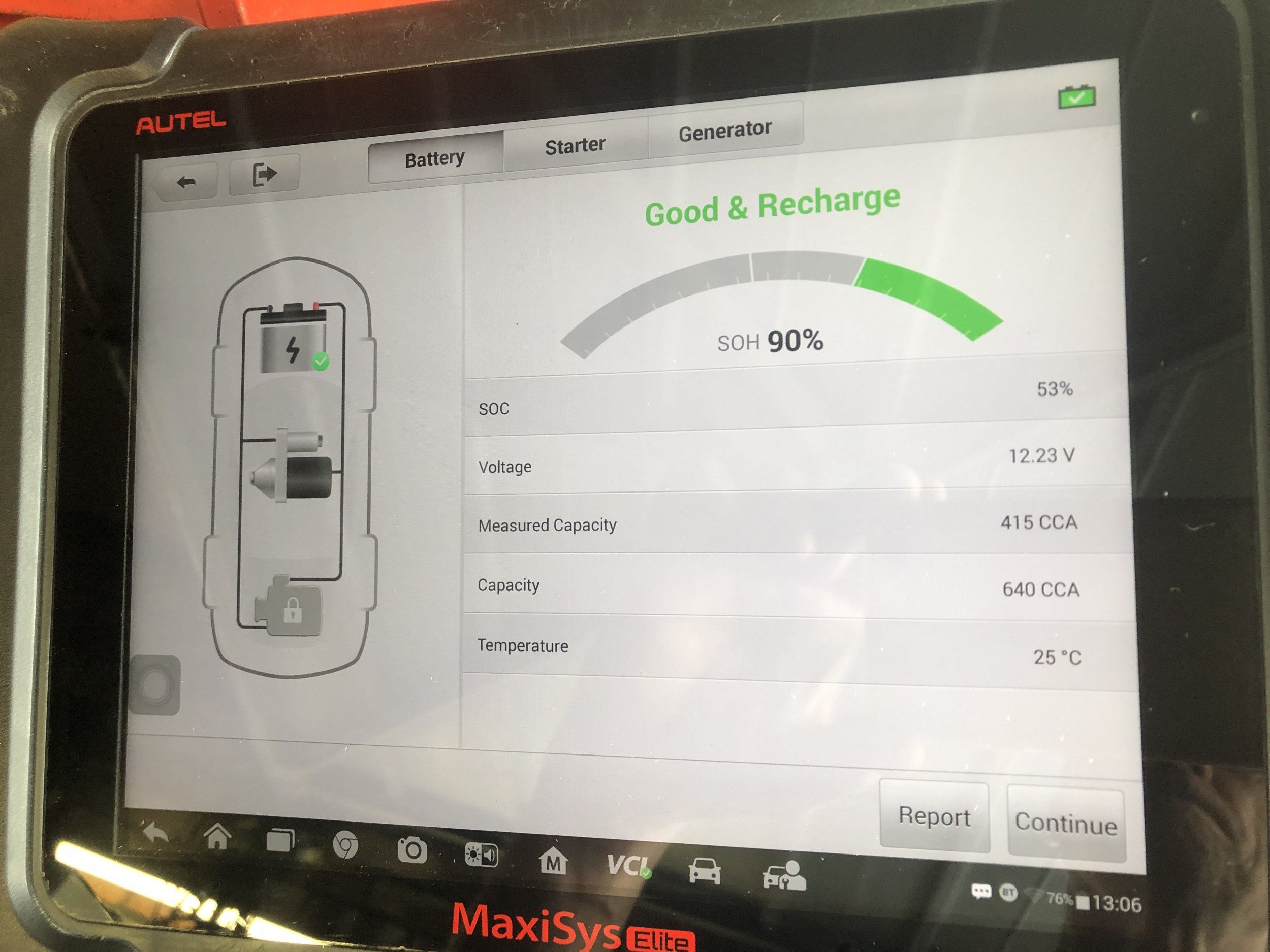

I have run a battery test prior to charging:
Noting state of health apparently good but a low state of charge, and a third of it's CCA being down

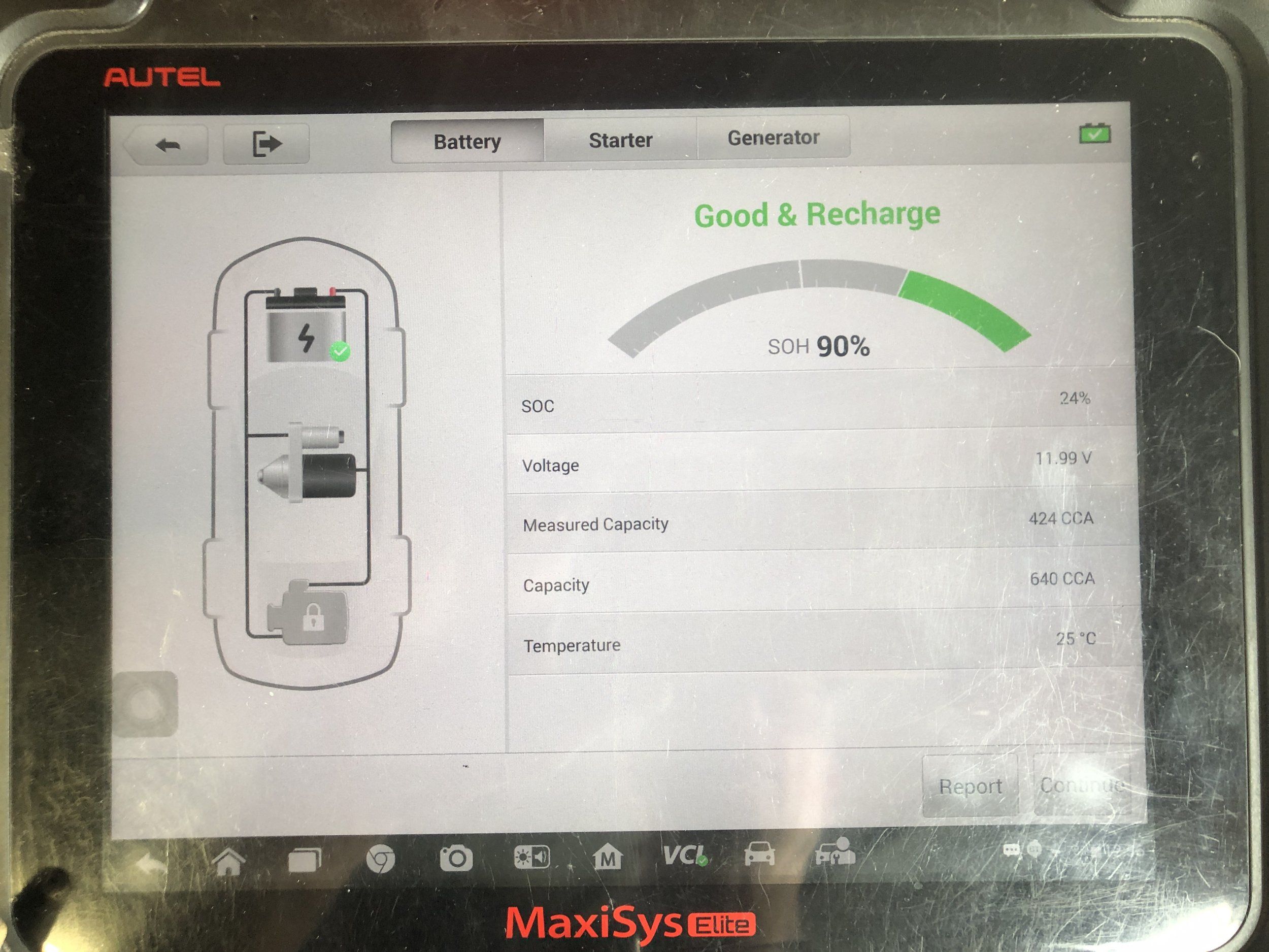

10mins later:
the jump ~25% suggests a bit more than just a rested battery after several start attempts in combination with lower CCA and a 12.2v reading, 'imo'

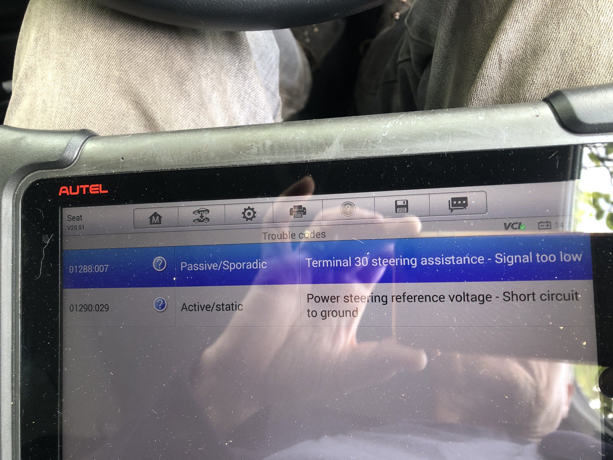

I did re-scan it though, and this time got additional faults, which are what is causing me some reluctance to just fit the new battery and alternator I have here just yet, even though they are likely to be put on, one being this terminal 30 code, I get that it might link to battery weakness but it wasn't there before with charge being lower....
neither were codes like this:
while these point still to the symptoms mentioned and voltage etc, it interests me why they didn't show in any prior scan

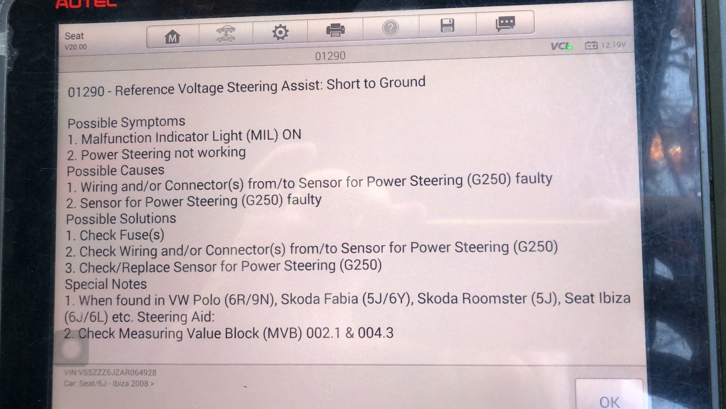

going back to the first fault, Autel suggest possible causes and mention something specific to a 6J at the bottom, I have no idea what it's referring to:

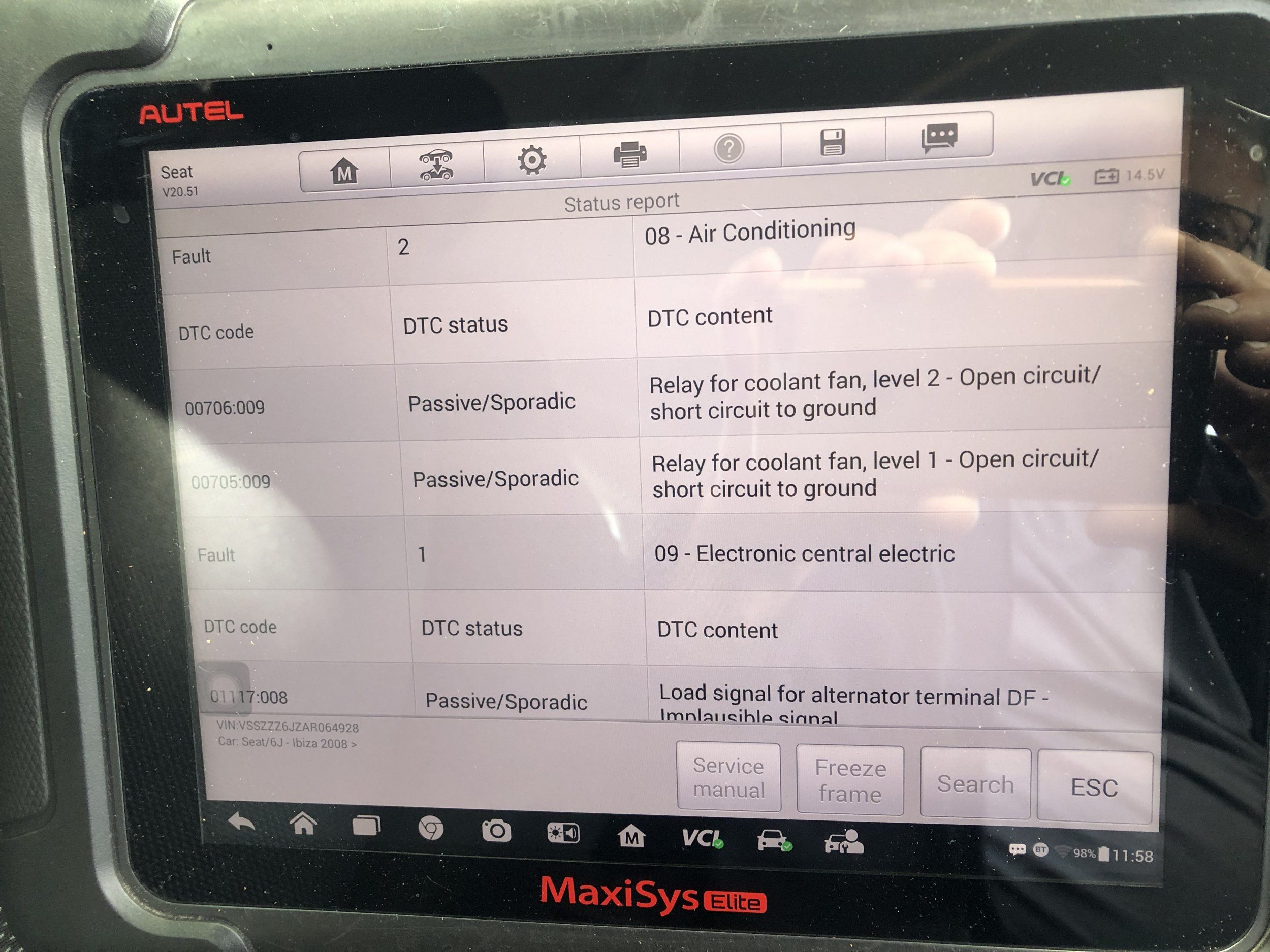

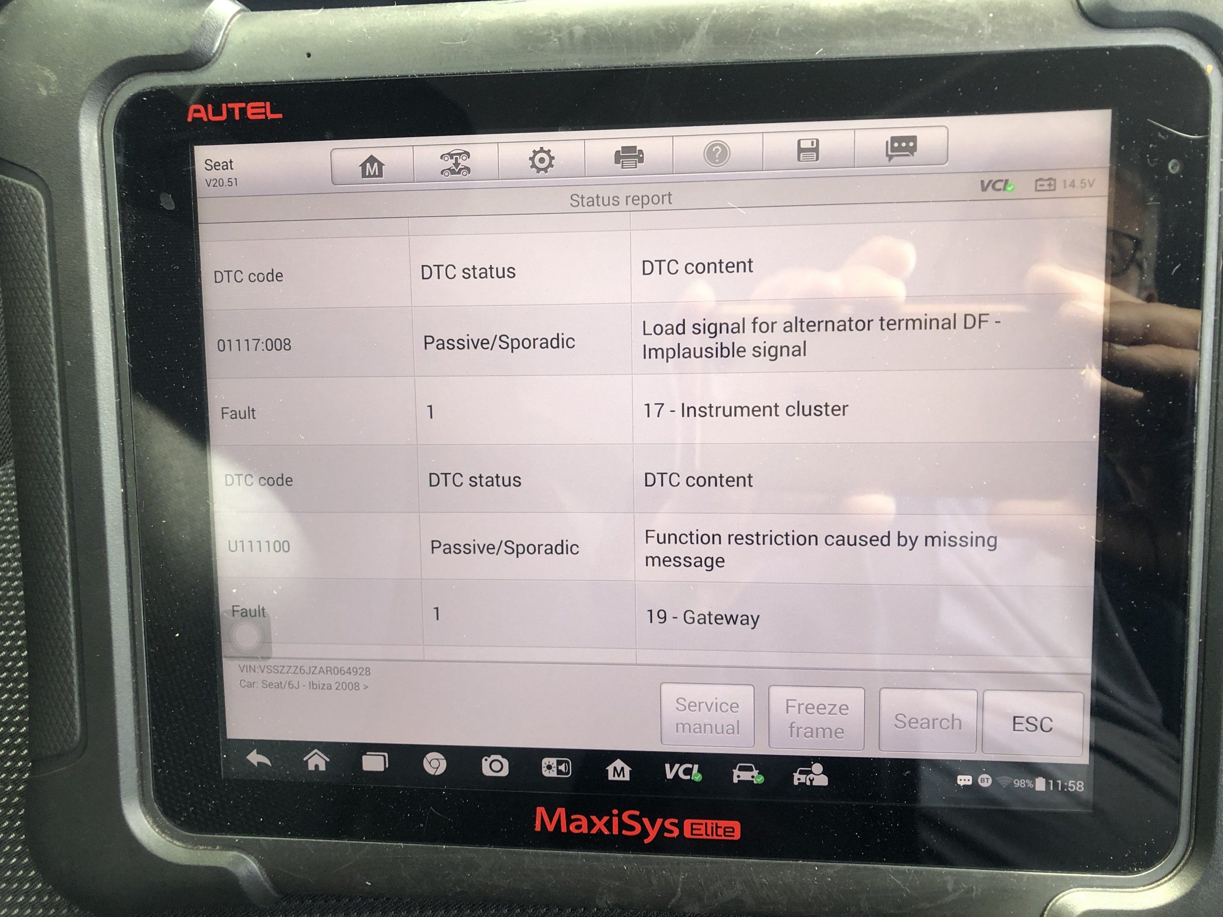

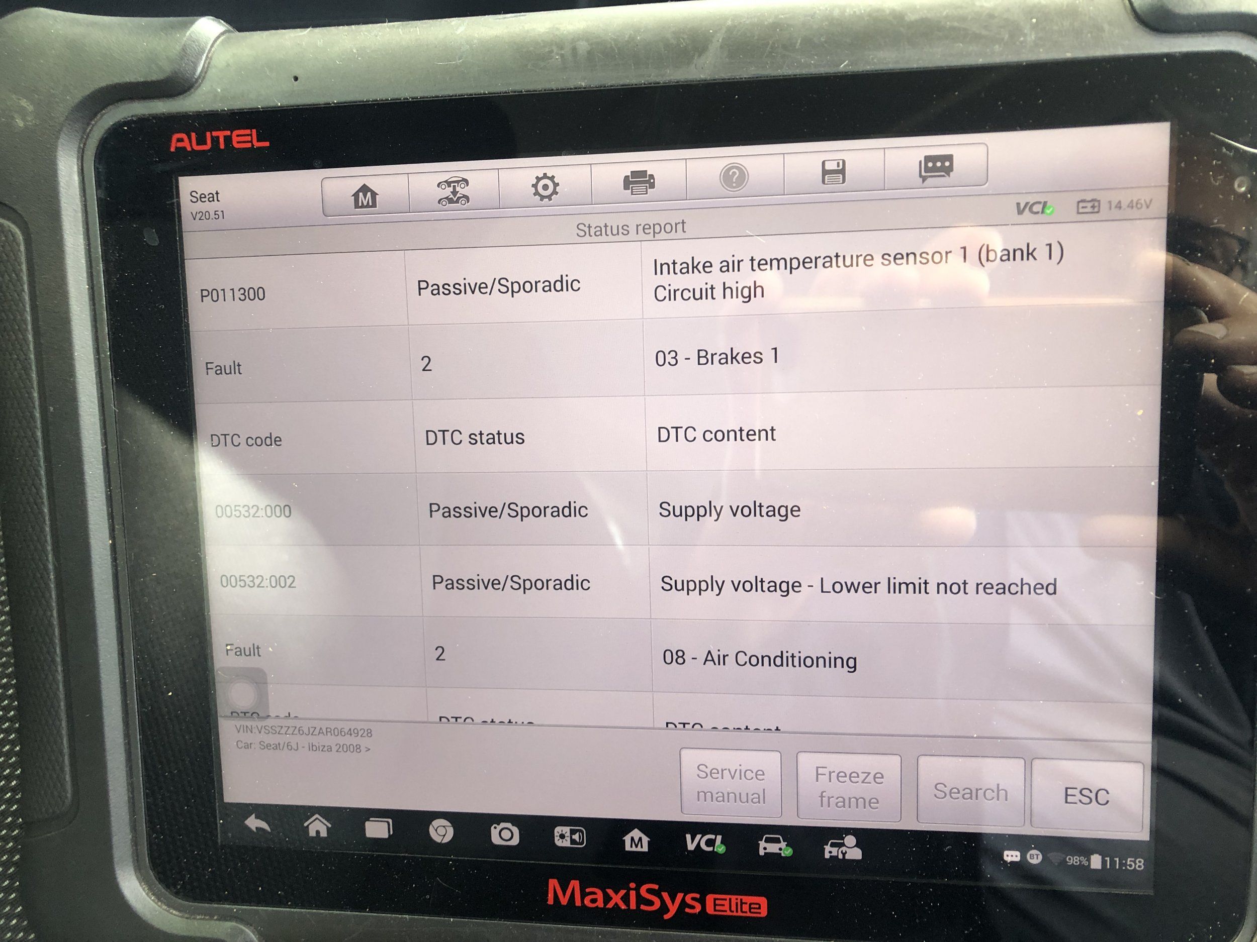

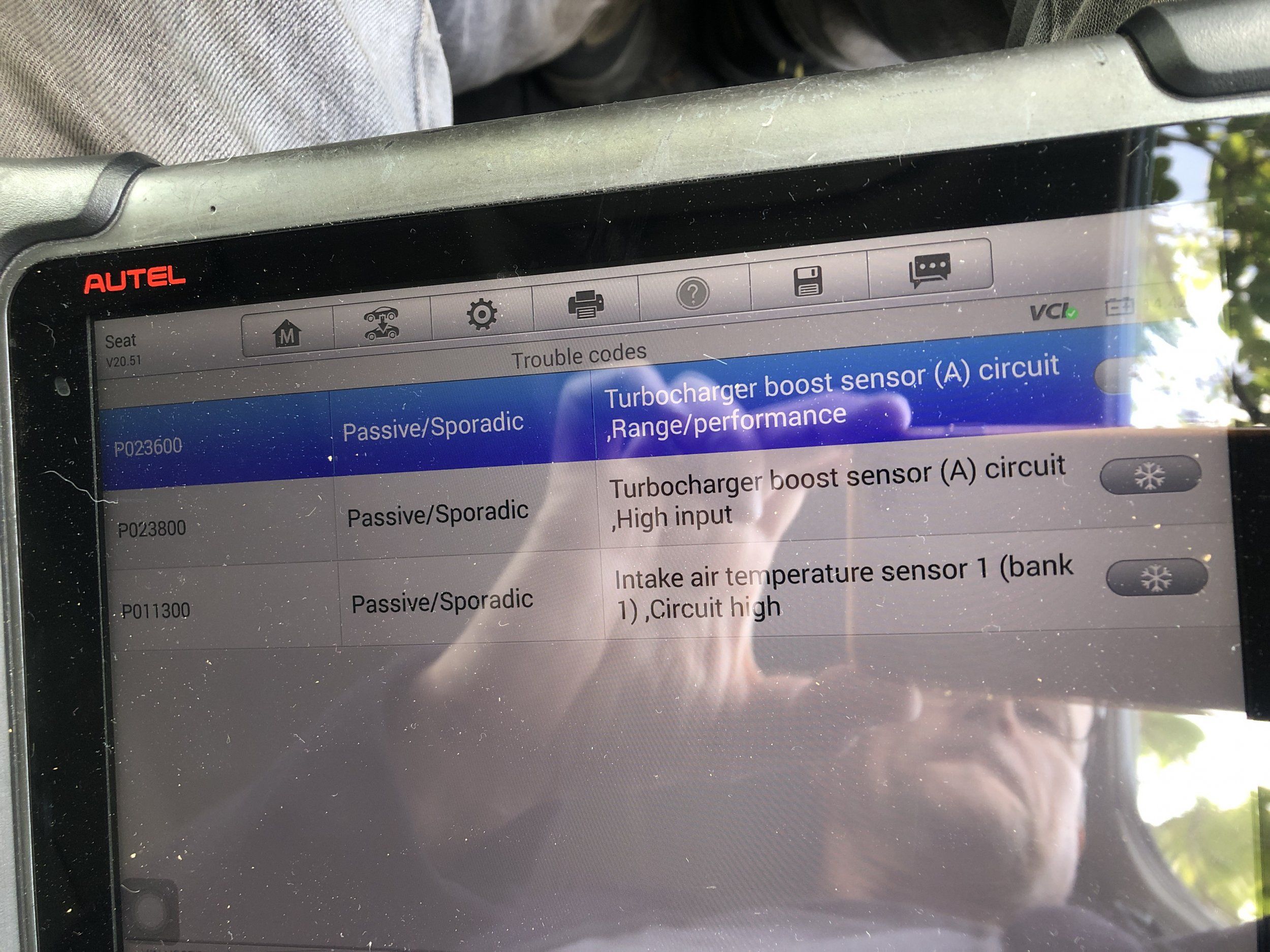

of course now the other codes showed up, which are the likes of codes I expected to see before, given the symptoms I see....
