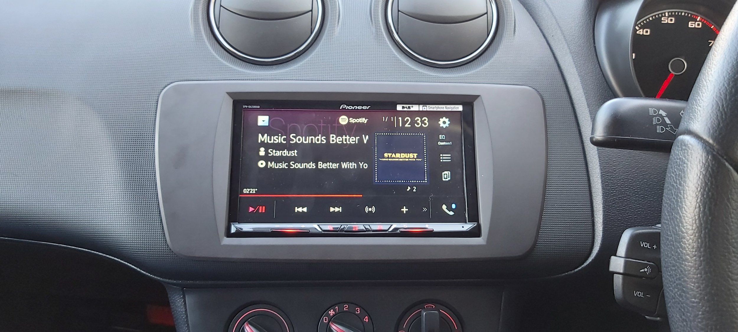

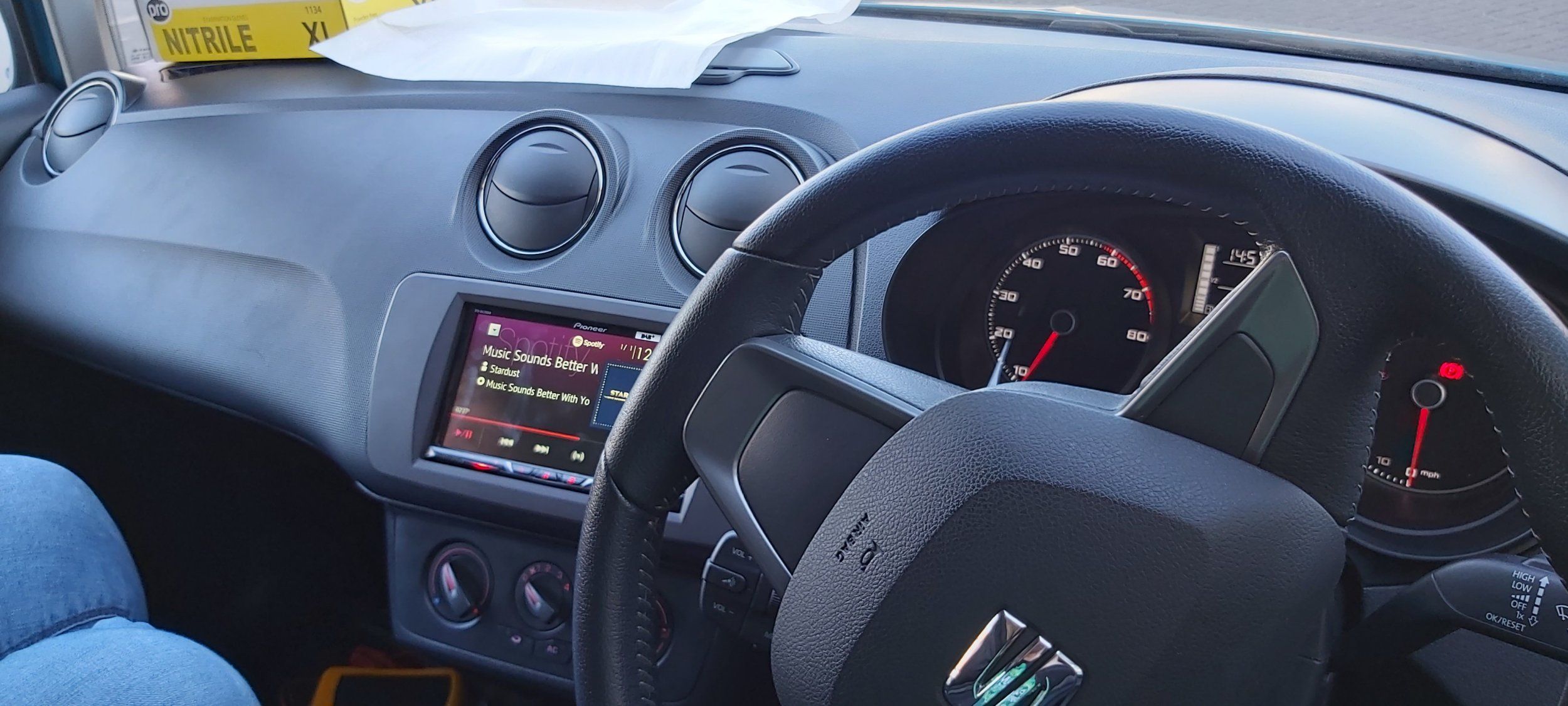

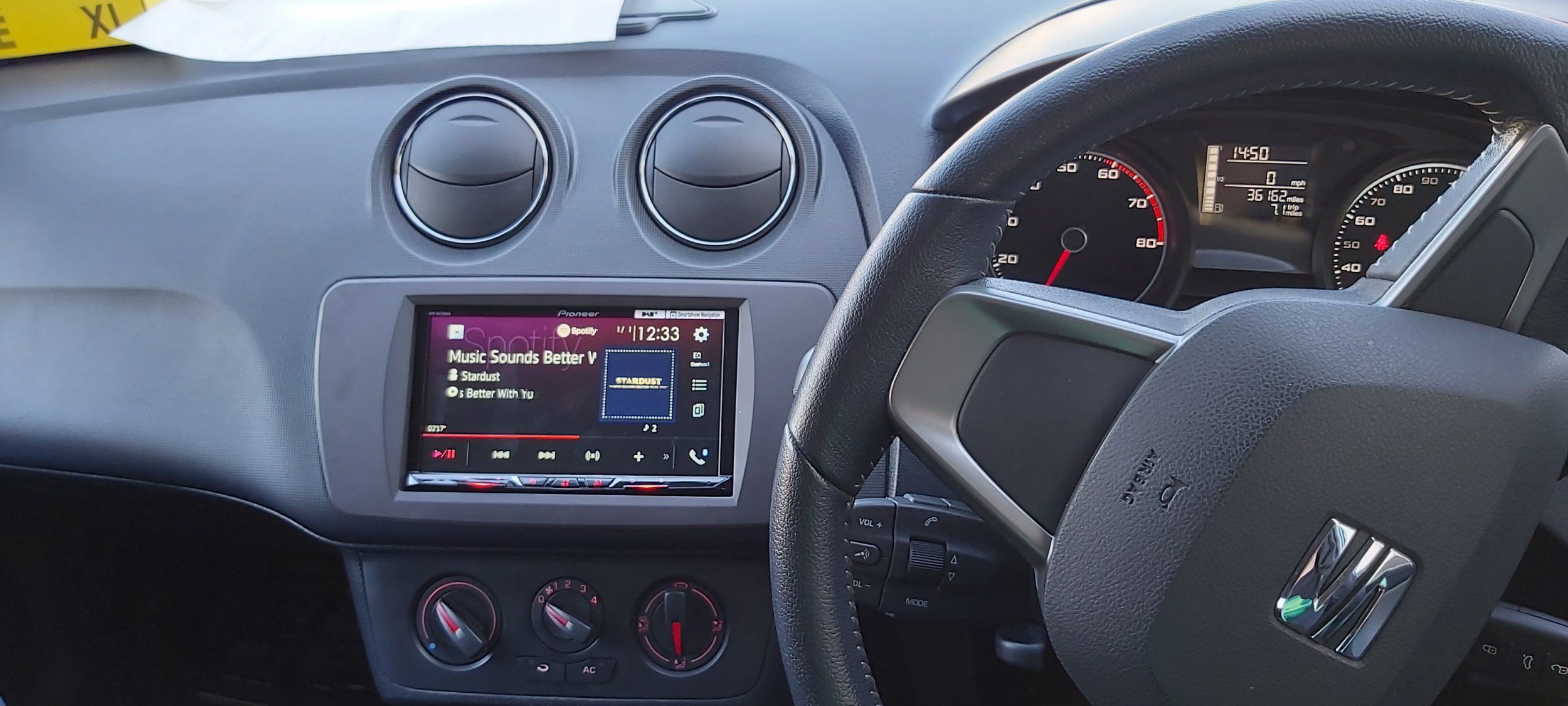

I've got a Pioneer SPH-DA230DAB fitted in mine.
It laregely depends on your budget, what you want/need from a Head Unit and how much you're able to do yourself. I can tell you from experience (as I'm sure others will) that putting a double DIN unit in any Ibiza can be a real pain.
That being said, I'm very happy with mine and it was worth the hassle.
