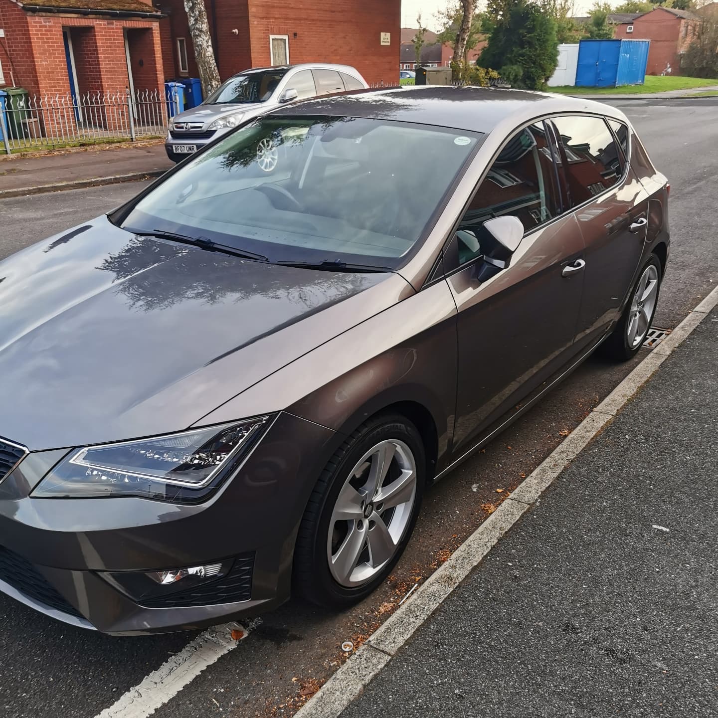

Can you show a picture?

Thank you, they just look really dim when on. Is there anything I can do to make them better.
