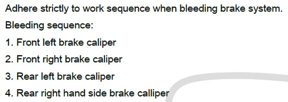

I saw it mentioned in the workshop guide that you start at the front wheels. That surprised me as I have always understood you should start at the furthest caliper from the reservoir.
Do you know the reason for starting at the front?
From the Seat workshop manual:
There are many different ways to do brake bleeding, if your just flushing clean fluid through as long as you are getting clean bubble free fluid out of each caliper i'm sure it will be fine.
If you have air in the system and you are activating the ABS module then I suspect the sequence is more important.

Thanks for that. I do however notice that there appears to be a note in the workshop manual that on right hand drive cars, you should start with Front Right caliper ( I presume it then goes FR, FL, RR, RL)

Hi @mjgreen81, t'was me who replied to you on facebook. I'd have elaborated abit more but I was out and about at the time.
As other have already discussed you'll get away without cycling the ABS pump to change out the fluid. It's actually a job I'm considering doing myself soon so it would be awesome if you could give your afterthoughts on the bleeder you used as I'll be purchasing one to do it.
If you want access to the workshop manuals by the way they're hosted on this site right here:
The images I posted for you on FB are in one of these documents (D3E804FD4C3-Maintenance in particular)
