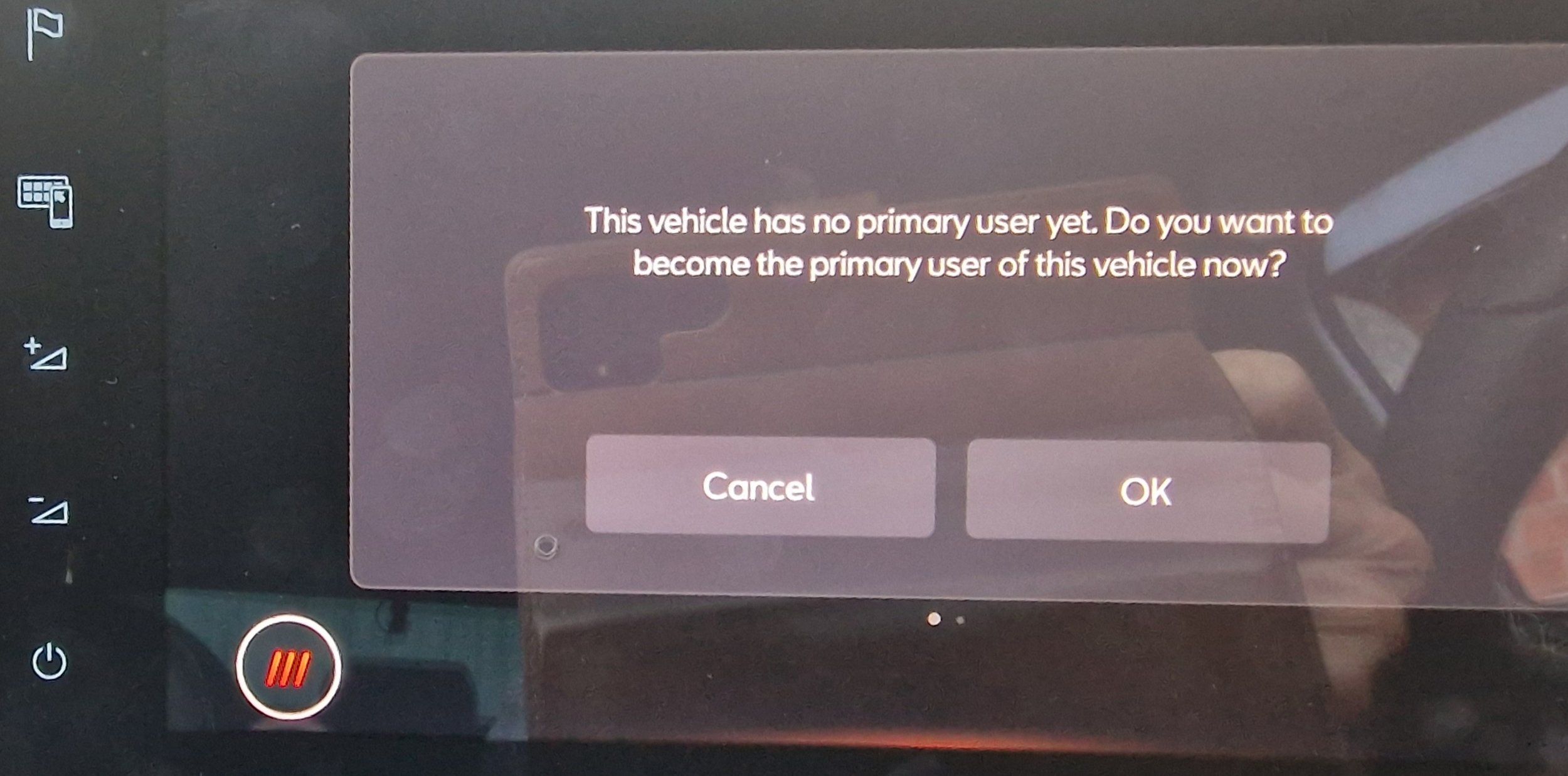

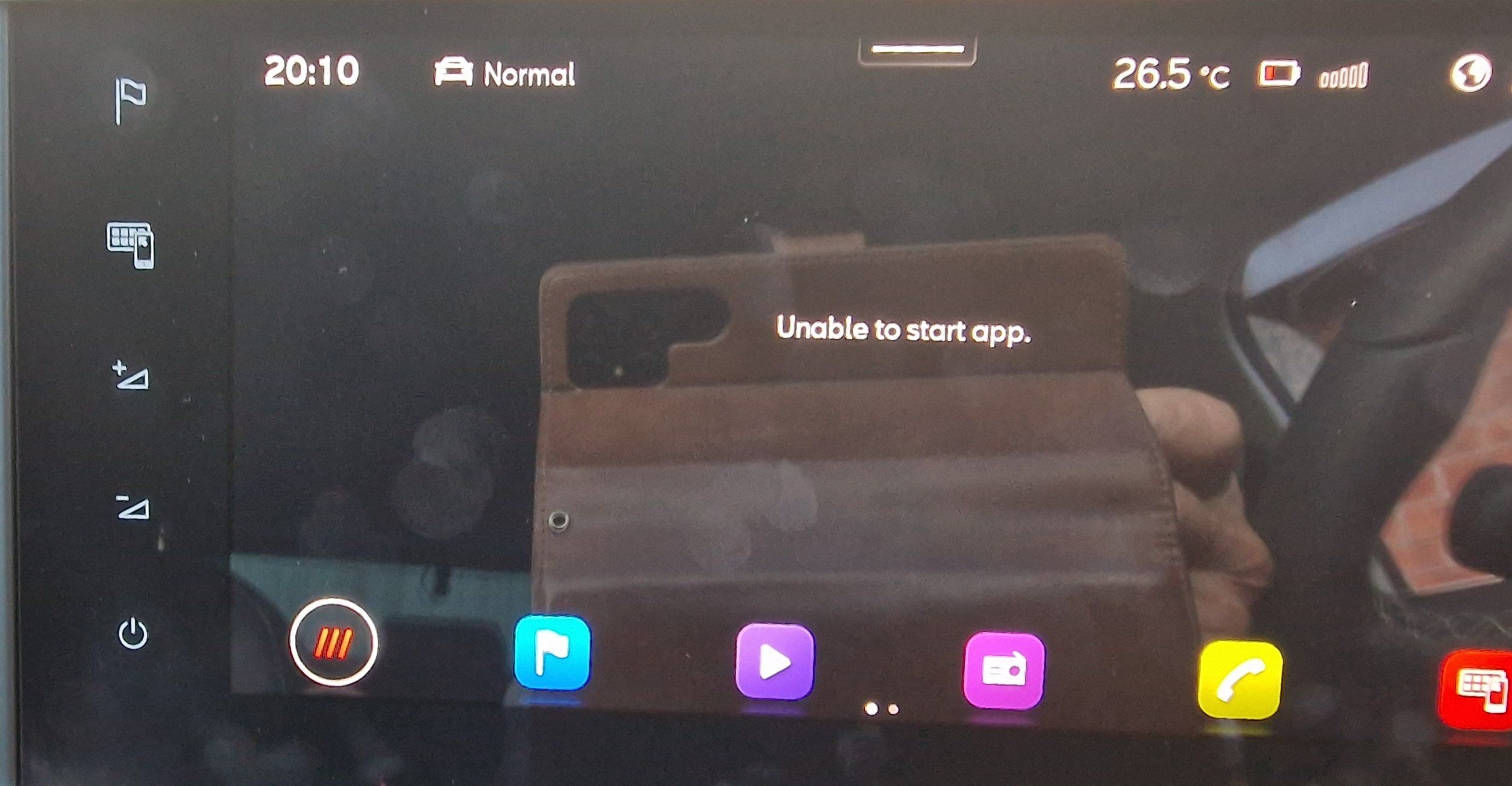

Unable to become primary user. I am registered connected to WiFi on Bluetooth and the infotainment system is OK in every other respect except Seat Connect can't get past the 2 key set up. Emailed my dealer here is there reply
Thank you for the email. I have had a chat with my service manager and he has advised we have three cars at the moment on site in which need this same fault rectifying. I believe the part that is required is part of the vehicle hardware which when ordered is on back order. What I would recommend is getting the vehicle diagnosed at a SEAT dealership to confirm the fault. Have Worcester been able to get yourself booked in so they can diagnose the issue?
Kind Regards,
That's as far as I have got. Seems like a hard ware problem. Do I need Seat Connect at £125 per year?

Doesn't sound like a hardware failure if it occurred right after the 1896 update like for many other users. I was able to set myself as the primary user until the update brought my infotainment from 1672 to 1896, now I can't.
By the way, what model is that? The icons on the left don't look like MIB3.
Deleted member 123864
It's the smaller 8" screen I think
aggie
Apr 28, 2009
264
I'm booked in at Seat Worcester 30th August for them to investigate bring two keys they said. I'll report back. But, they don't think it's a hardware problem the mind boggles.
