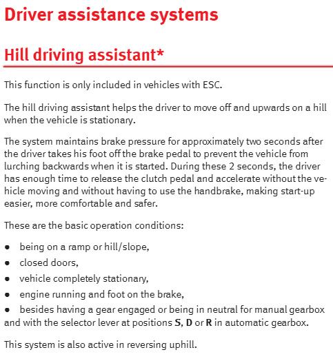

It has hill hold - but uses the ABS system rather than the rear caliper.
When it detects you are on an incline and you take your foot of the brake - it maintains pressure in the ABS system and brake calipers and keeps all brakes applied for a few seconds - enough time for you to select 1st and pull away.

Yes, according to the manual:
