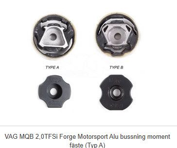

I have Forge Alu insert (harder than plastic) in my Cupra R 2018, no problem with NVH. As H Rafiq says, there are 2 options. See pic..
PS - mine is Type A :).
