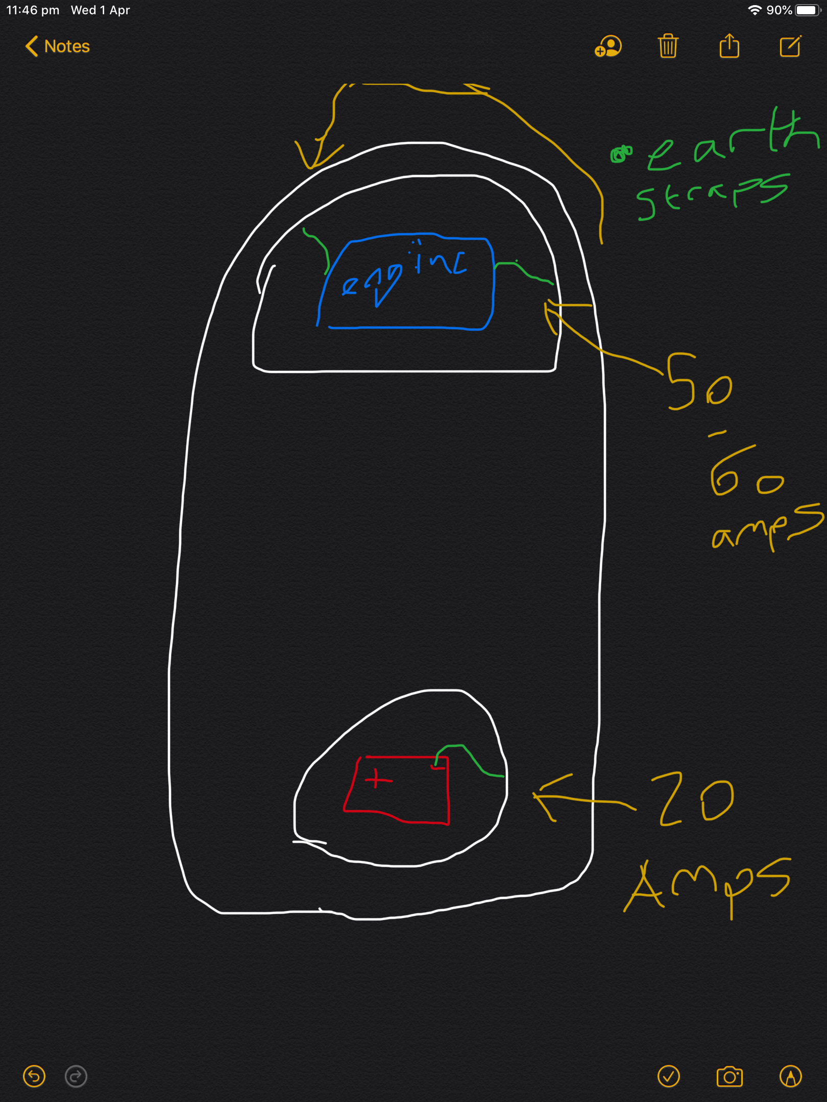

I actually got a question if you might know, so you know the groundings of the vehicle, well when it’s running and I put everything on it pulls like 50-60 amps on the earths to the body in the engine bay. The battery is in the back and the negative is connected to the body but there was only like 20 amps running through that earth. Is that normal for there to be much a amp difference from the engine bay to the back where the battery is

One reason maybe logically would be that you are not seeing the alternator's contribution at the rear mounted battery - does that make any sense, the battery by itself could never supply the current that system needs at peak demands, which is why that system gets disabled if the battery is weak.
Yeah it makes sense, it seems to be working with the original pump... so weird. I just wish I could connect with vag com but it just says short to ground intermittent
