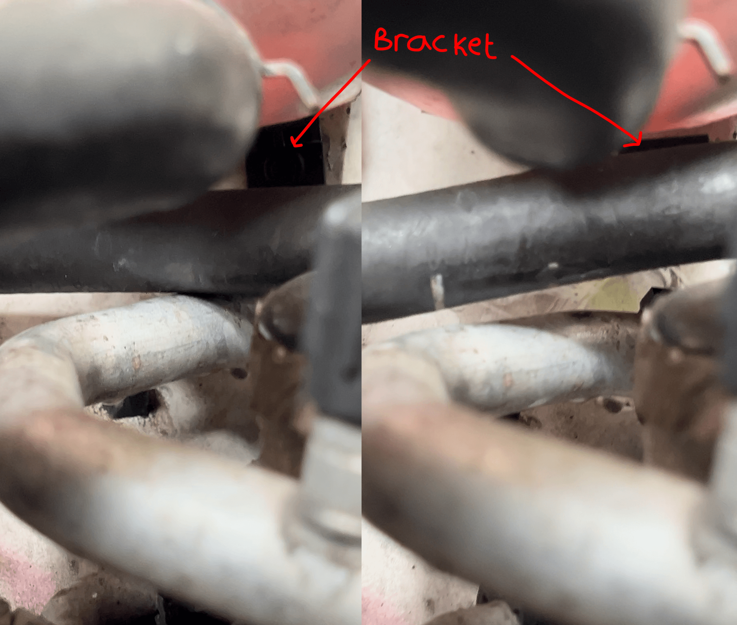

Had a look under the bonnet at the weekend, and made a discovery. The rubber coolant hose wasn't seated into its horseshoe bracket. It was fully loose, and was doing this:
It has been resting on top of the AC refridgerant pipe. The hot rubber pipe had bonded itself quite nicely to the cold metal one. I got them apart, and luckily the rubber pipe hasn't been split or melted, but you can see in the pic that it's left a mark from its time sat where it shouldn't.
Anyway, I put the rubber hose back into its bracket. Now, the car gets to temps of 105-110c, and when idling, comes back down to the mid 90s almost immediately. It's back to cooling itself as intended (thank god!!)
