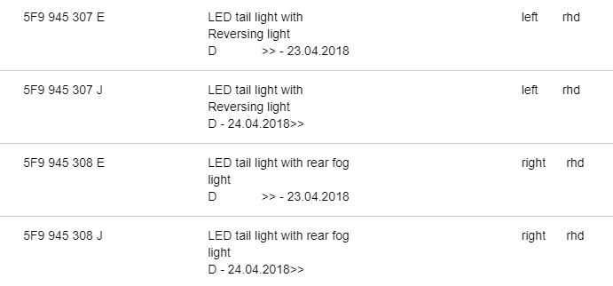

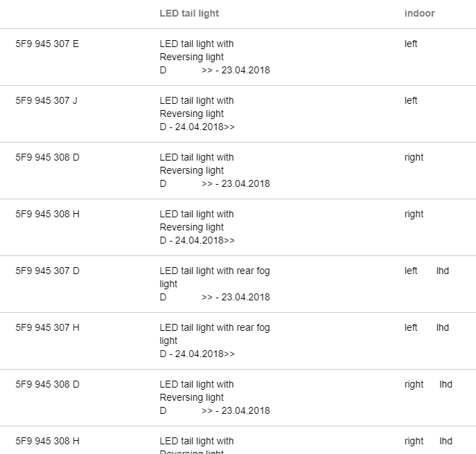

Looking at the 2020 Leon parts catalogue there are left and right versions of the indoor reversing light/fog light side.
The bulb PN is N10591501 (bulb crystal clear) W16W-12V
Looks like the same bulb PN is used for the fog and reversing light - depending on its side.
