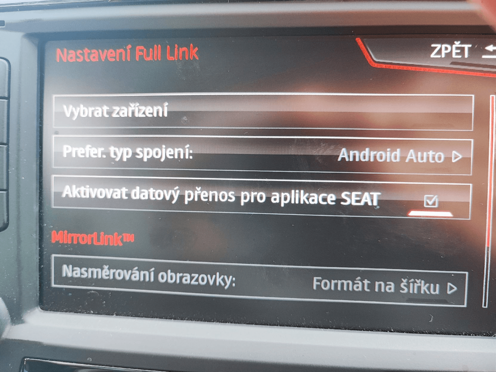

I own 2016 (2015 manufacturing i guess) Leon Cupra. Bought it second hand . Full LInk is activated but I cannot connect my phone.
I connect it via cable.
Phone says "connected via android auto".

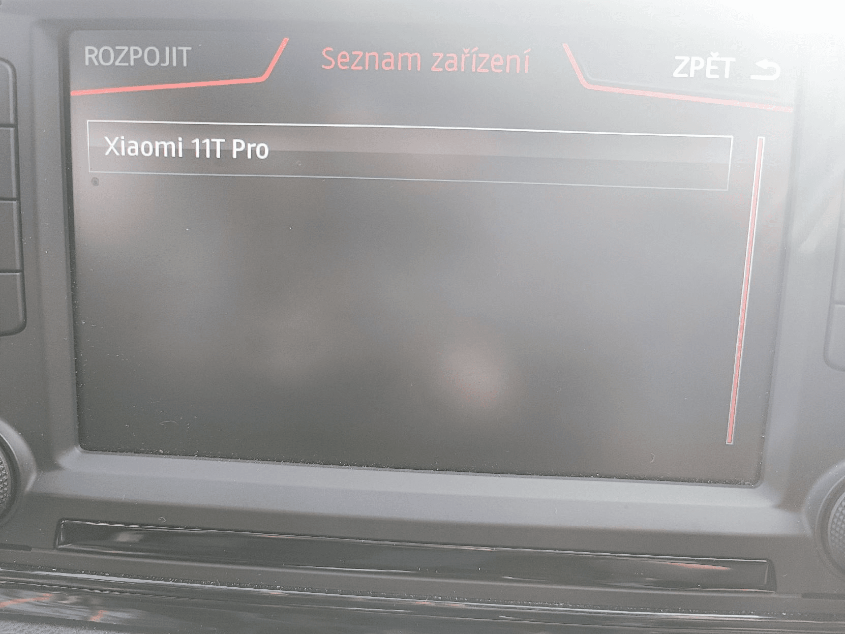

I locate the phone in the list and try to connect to it.
I get "Connection not possible, check if your device is not blocked"

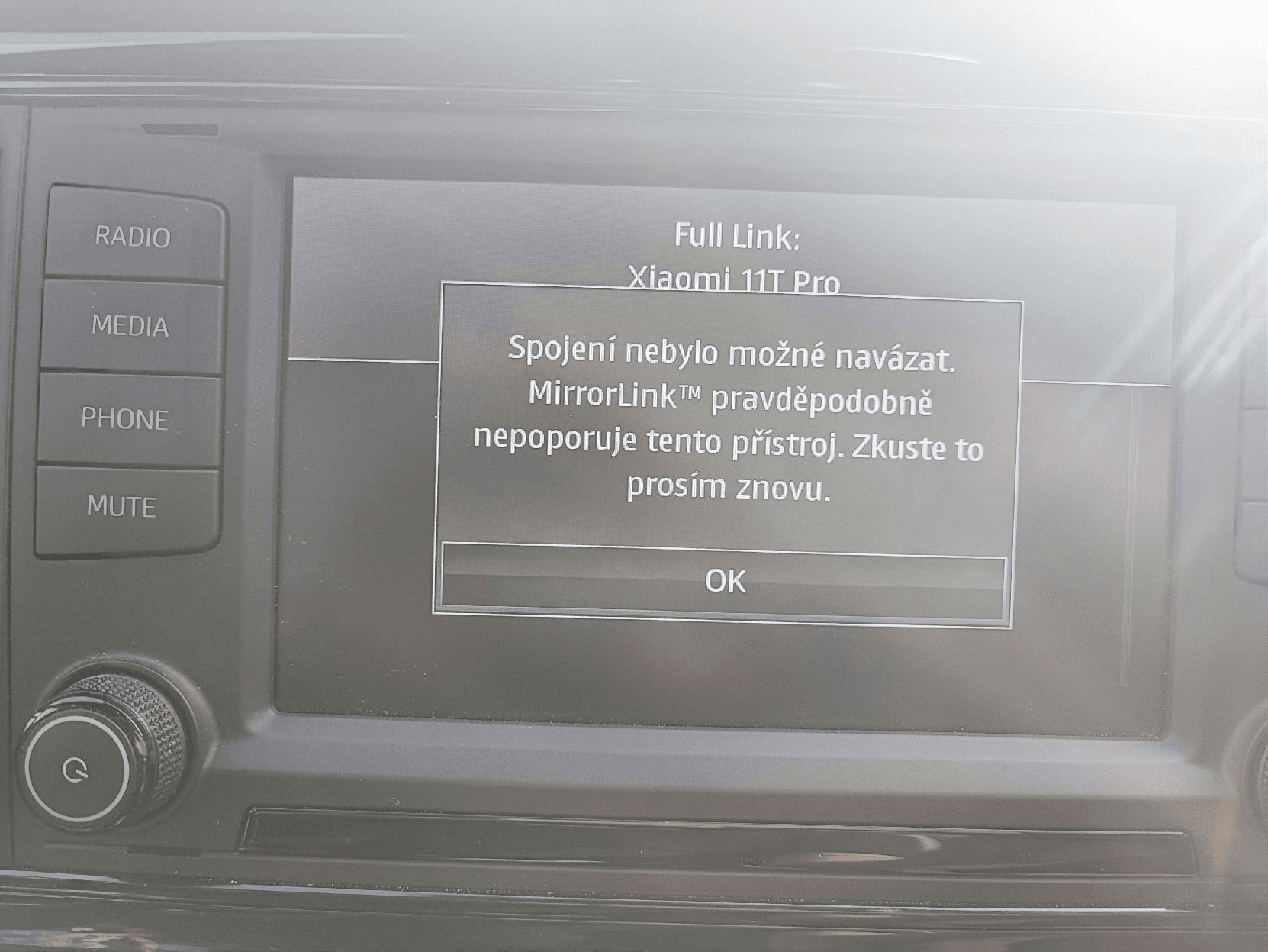

Then the system tries to connct to Mirror link and says "Unable to connect, Mirror Link most likely does not support your device. Please try again"
The translations are rough but you get the idea.
I have Xiaomi 11T pro. I think full link does not support it. Do you think update would help and if so, can you point me to a comprehensive guide? Thank you very much!

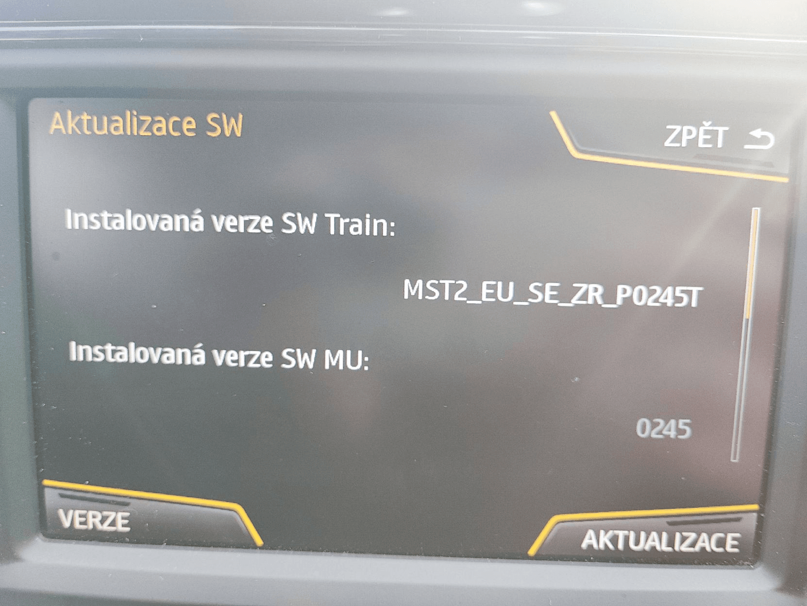

Tell

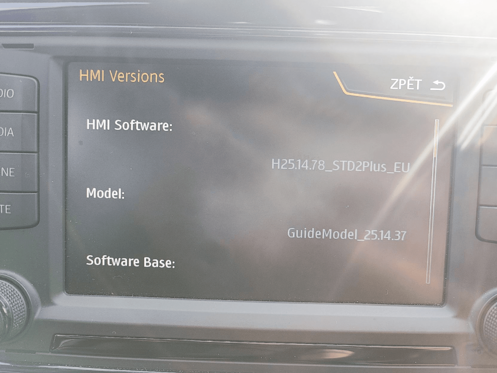

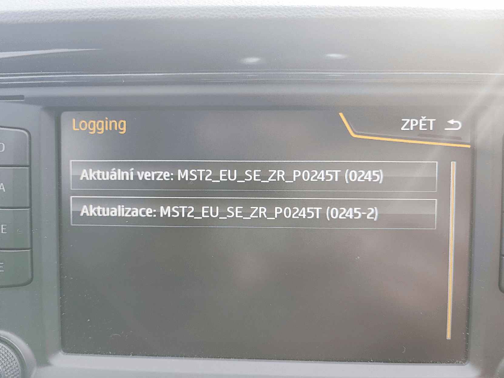

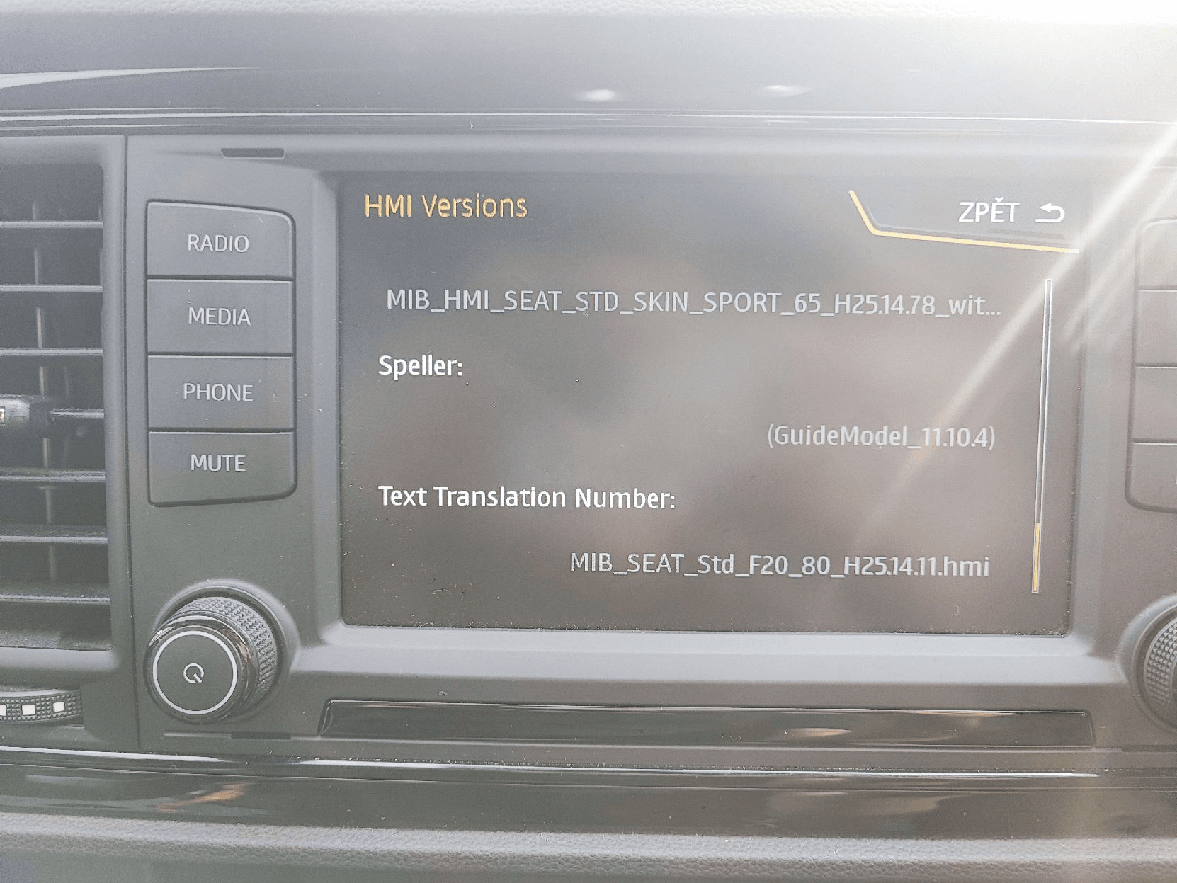

From the software release yours could be a candidate for a software update. You have a mib2 standard. You have to keep within train. You are on the 2 train. You cant / not recommended to go above that. The software thread is here:
The mibsolution website contains the firmware releases in the public domain. The ones that end with T are generally the original ones. Does contain ones that have been edited. You can kill your unit if you get it wrong.
253T would be the update
guest guest
I'd study the post on there. Ask questions on there. Important you keep the engine running during the update or battery charger on. Any failure in the power will suspend the update and probably lock you out.
You can buy the updates form East Yorkshire Retrofits online and they have PDFs on the process.
