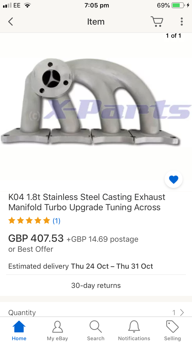

I saw this on ebay that looked promising but cant vouch for it
Look at this on eBay

i had that one but sold it, it gives good flow but all ancestor where prone to cracking over time so, i didnt want to gamble it.(other than that it takes around 4 hours to fit) . iwent for a oem manifold, but my aim was 300hp. i would go for the chinafold like mamic said and port that one.

yeah i felt the same. had a xs one second hand. looked fine but i sold it. not gonna waste 4 hours to put it on. even the JBS manifold had good reviews but a dutch guy here had one that cracked. the chinafold is based on that one.
