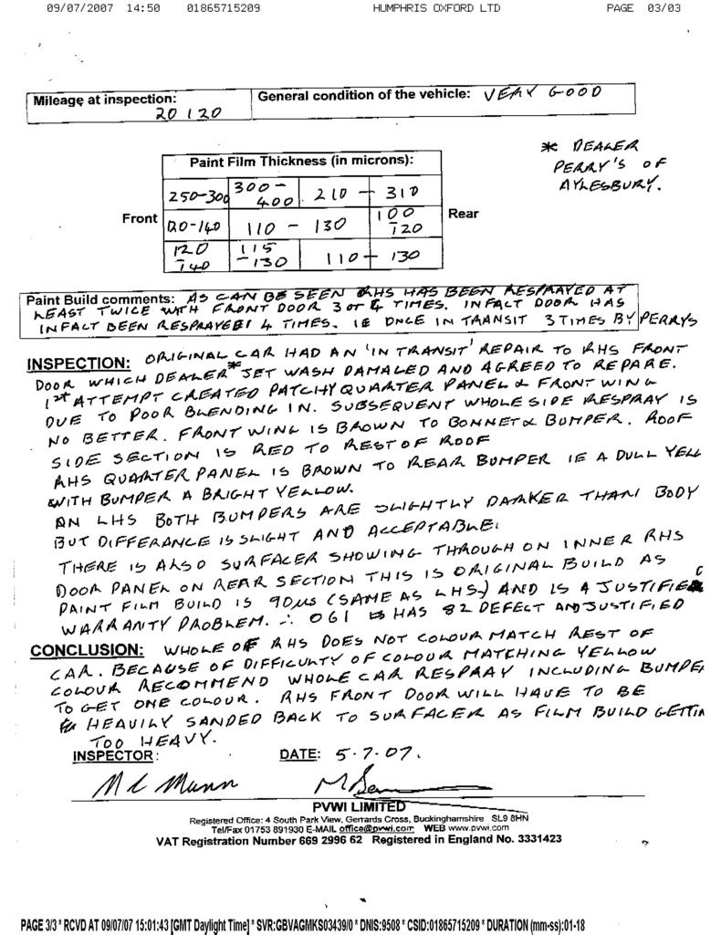

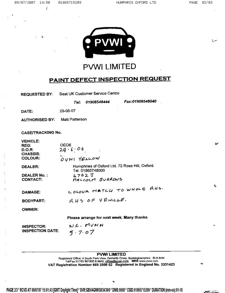

For what it's worth you are not the only one with a paint issue.
By the time I had the inspection done on my car it was more than 12 months old.
Page 1 of the report.
http://i108.photobucket.com/albums/n25/joonspoon_2006/SCN/Page1.jpg
Page 2.
http://i108.photobucket.com/albums/n25/joonspoon_2006/SCN/Page2.jpg
Page 3.
http://i108.photobucket.com/albums/n25/joonspoon_2006/SCN/Page3.jpg
Click on the images to make them bigger.
SEAT UK paid for the report once I had contacted Trading Standards and then quoted this in an e-mail to SEAT UK.

OK it was after the dealer had attempted to correct the fault but the point is SEAT UK paid for the inspection because they accepted that it was a warranty claim to begin with.
