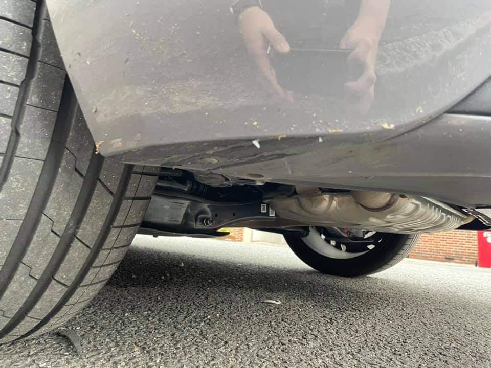

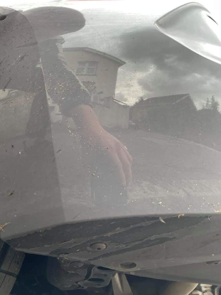

Behind the rear wheels paint is starting to peel because in my opinion, the paint is too shallow and is exposed to the stuff coming off the rear tyres.
My drivers side has just started to peel.
Another guys on the MK4 Cupra Leon Facebook group is really bad and he's in discussion with Seat UK about it.
There was also another member where it was just starting to peel.
I've attached some pics of the damage to one members car.
Keep and eye on this as I think this is going to be a common issue.
PS, does anyone know of some rear mud flaps that fit. I'm of the understanding the standard Leon ones don't?
It could be to do with an issue in the painting process for painting plastic components or incorrect prep of the plastic bumper prior to painting rather than the thickness of paint used. I can recall reading on a VW forum a few years ago of a few instances on a previous generation of the Golf (I think it was the mk6) of peeling paint in vulnerable areas on plastic bumpers. From memory, the issue was attributed to the painting process or incorrect prep prior to painting.
Another possible explanation might be substandard repairs following damage sustained whilst vehicles were in transit from the factory to the dealership. Unfortunately, damage to brand new cars in transit does happen, and repairs might not always be to factory standard.

Yeah mines started peeling at back as well like the guys on FB mine is 2k miles I've bodged it to stop it happing more and goes to dealers in Jan. My front bumper has some stone chipping as well in odd pattern did a few touch up's today, it's candy white so blended easy. I seem to get stone chips that rather than head on hits it hits then seems to go across the bumper so look like little cuts, at first thought it was something else but them on both sides now think it's shape of bumper that does it.
I think paint too thin or incorrectly prep on the pealing bumpers like other poster said, on mine the paint is litterally pealing a way with hardly any key to the plastic, once the paint is broken that's it pealing starts. Would avoid jet washing car in that area and no auto car washes.
