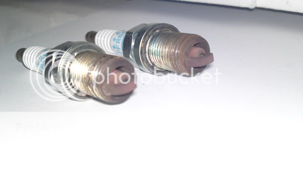

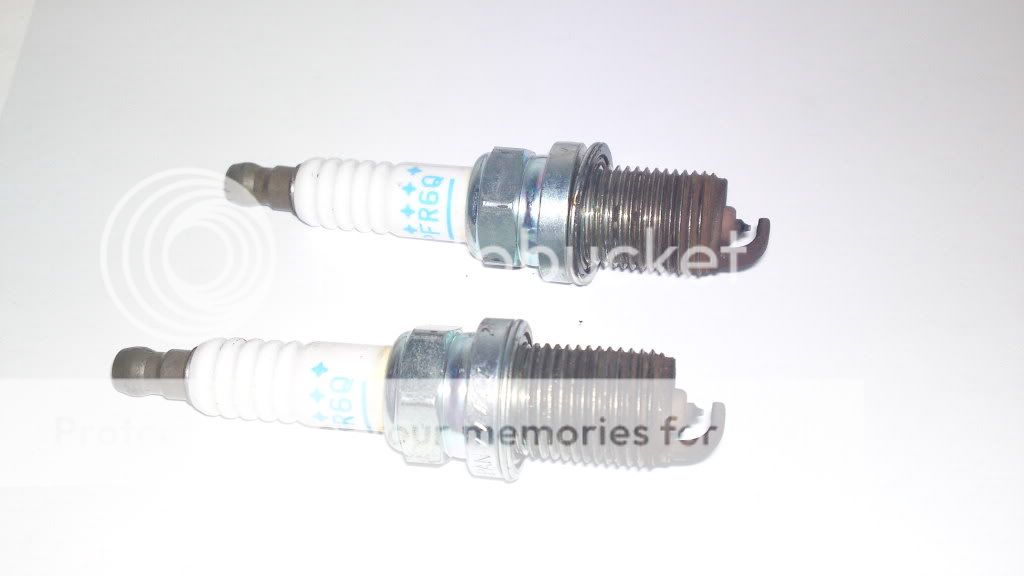

There is a very strong smell of petrol that surrounds the car. And yes, MPG has dropped massivley. I havent checked the colour of the plugs - would you reccomend it?

check plugs yes, I would expect them to be very sooty
