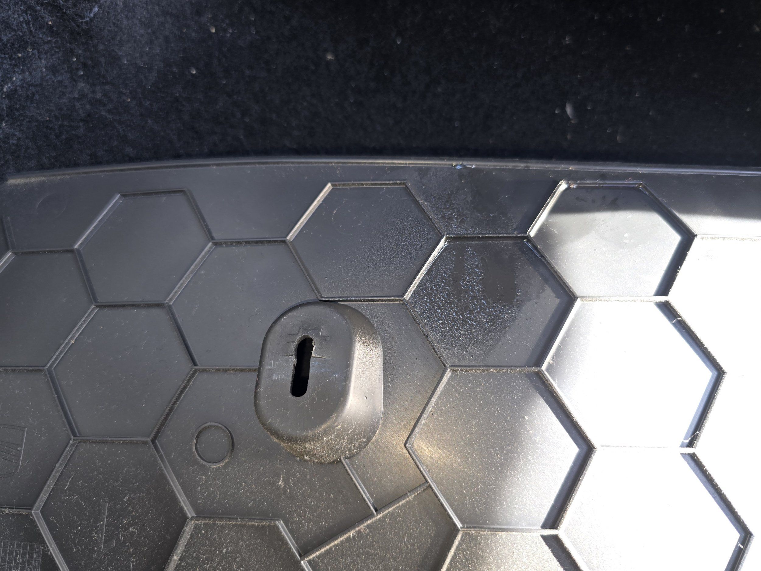

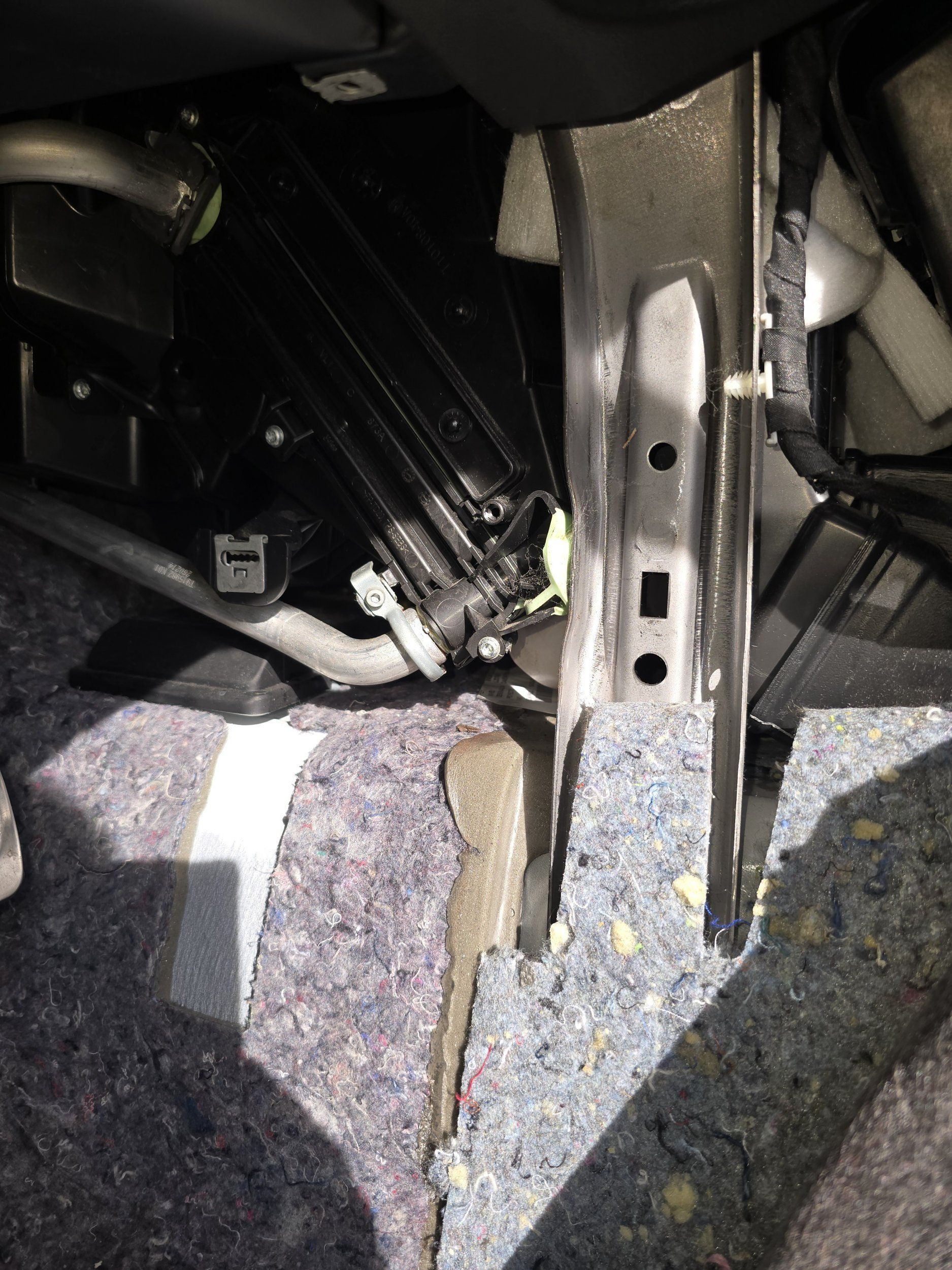

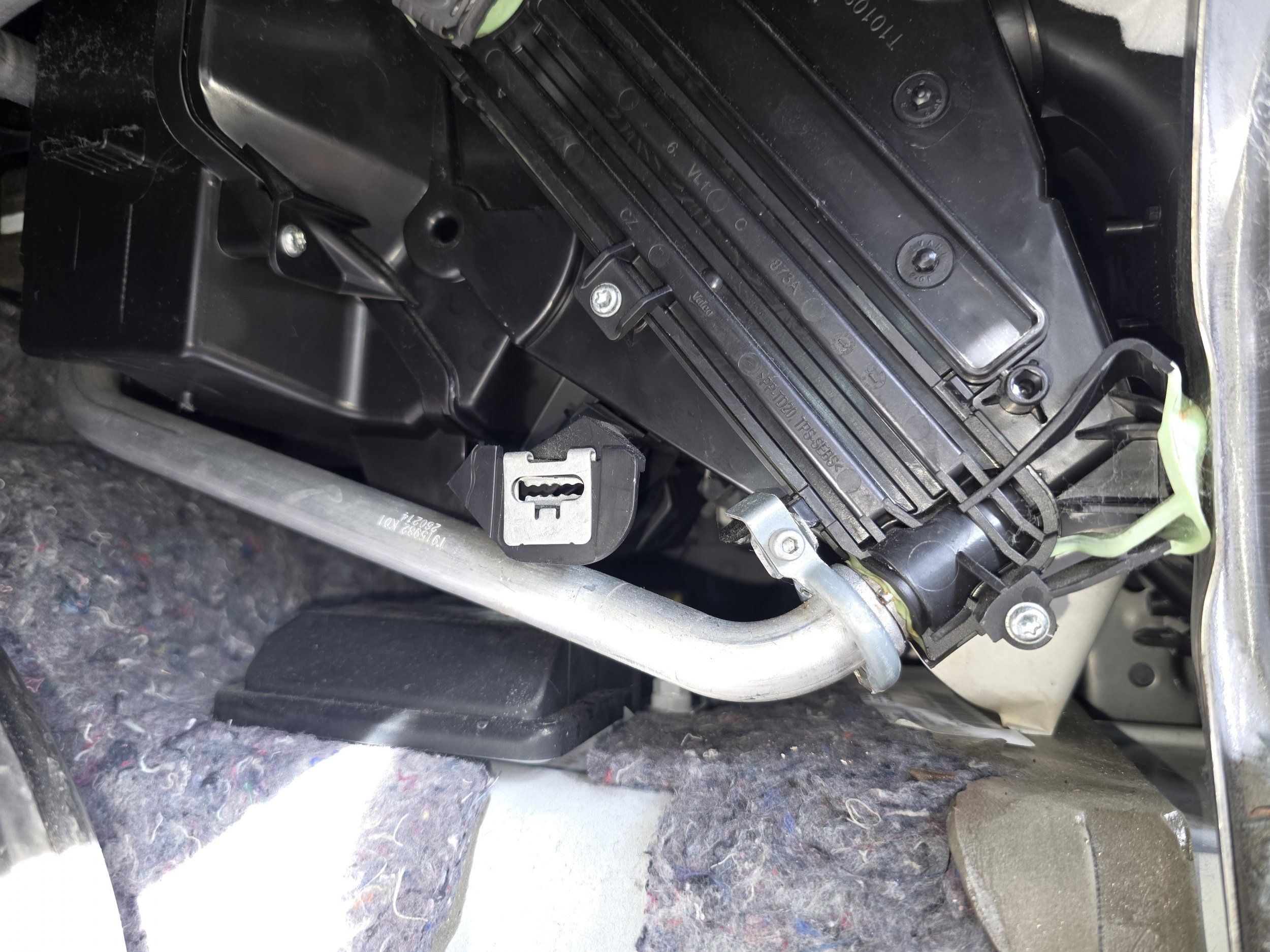

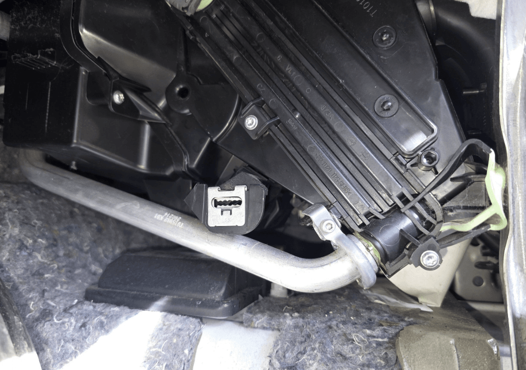

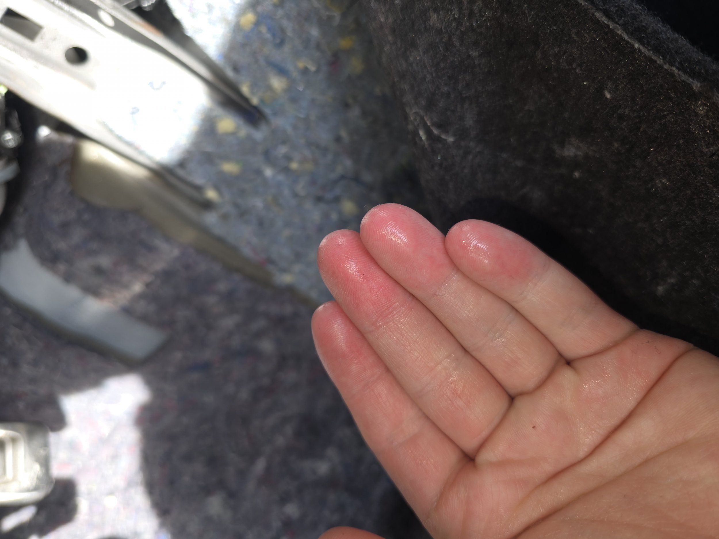

My Seat Leon 5F 1.6 TDI's got a problem; the carpet by the gas pedal is oily. I took off some panels and kinda figured out where it's leaking from. Has anyone seen this before? Any ideas what it could be?

Hi Aleks
Coolant from the heater matrix or pipework ?
Pop a clean finger in the header tank and see if it feels the same.
SuperV8
May 30, 2019
1,669
784
Your heater matrix is behind this black rectangular panel. The green rubber looks disturbed so some one has been in there before.
The aluminum pipe feeds coolant (which is red/pink and oily) through your matrix so suspect it would be coolant on your carpet.
Have a feel around the pipes to see if you can feel any leak? There is an o-ring in each fitting which could be leaking.
