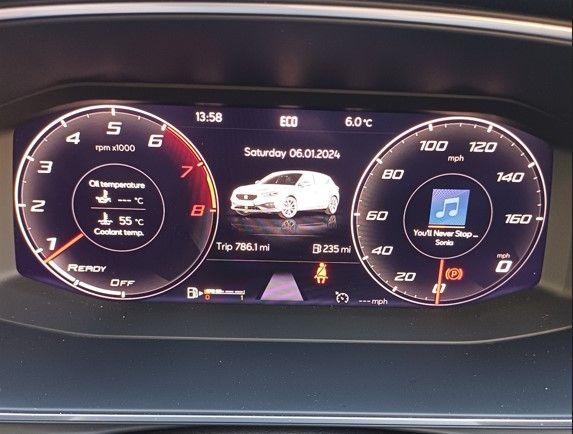

Digital dash - with the top left and right view buttons on RH of steering wheel navigate to the left hand side of the dash. Use the scroll wheel to change the view until oil and water temp shows then press scroll (as ok) to set the view.

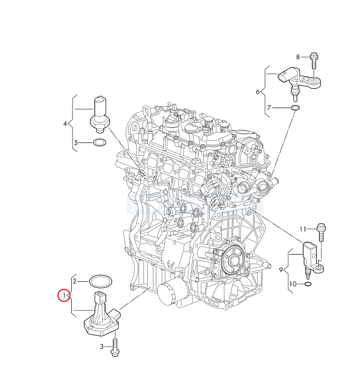

Bottom part of the engine is where is the sensor located
