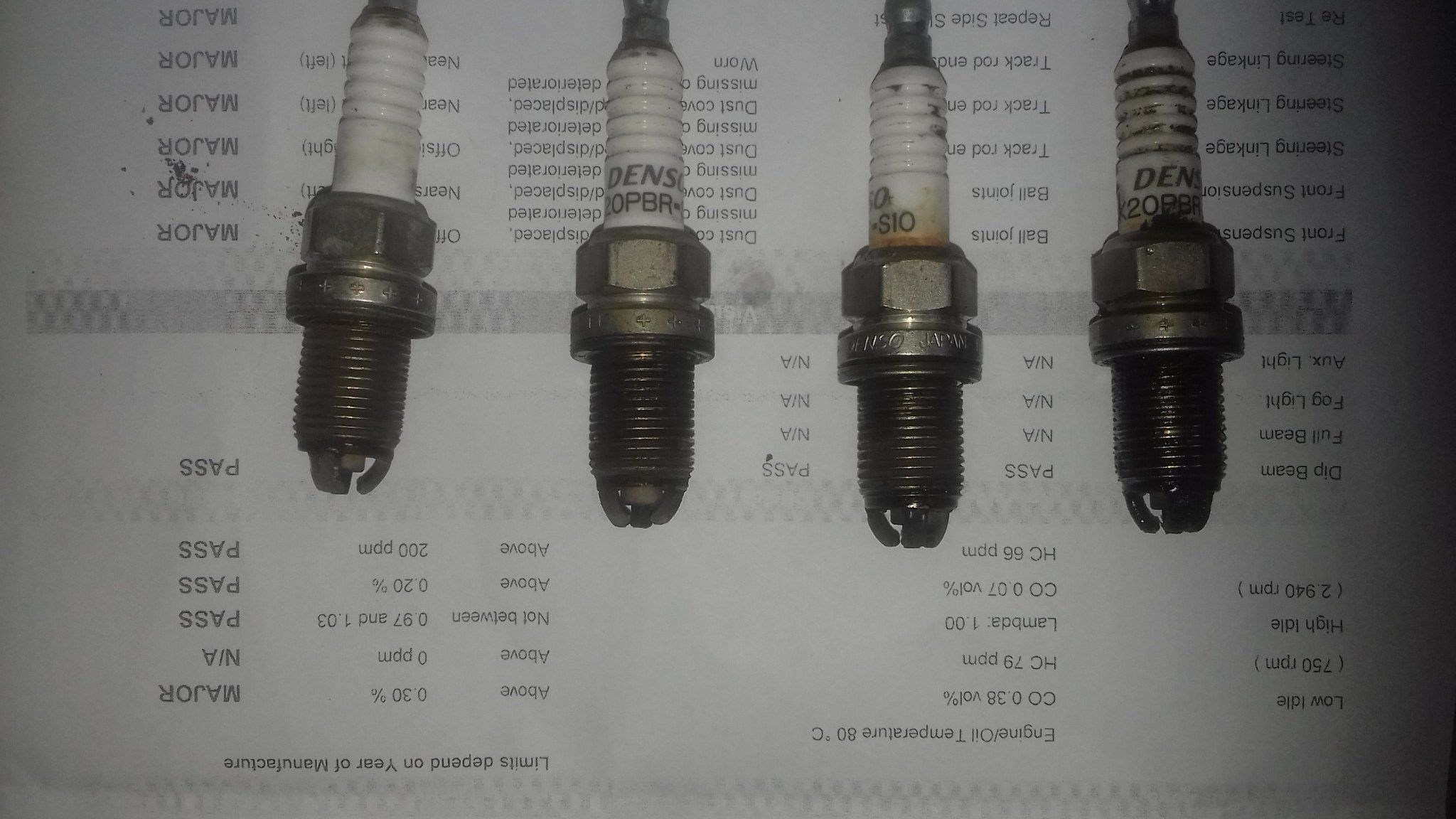

The car was in for the test about 10 days ago, failed on CO at low idle (0.38 when it should be less than 0.30).
I dropped the car into a mechanic last week as there were other issues with the ball joints and track rod ends, and asked him to change the spark plugs as well, and I'm to change the air filter and oil and oil filter this weekend, and give it a good drive to the test center on Tuesday.

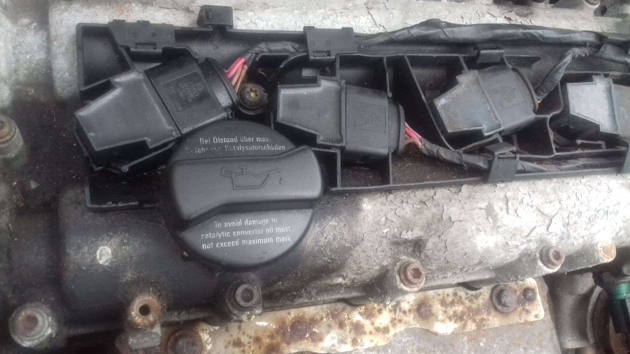

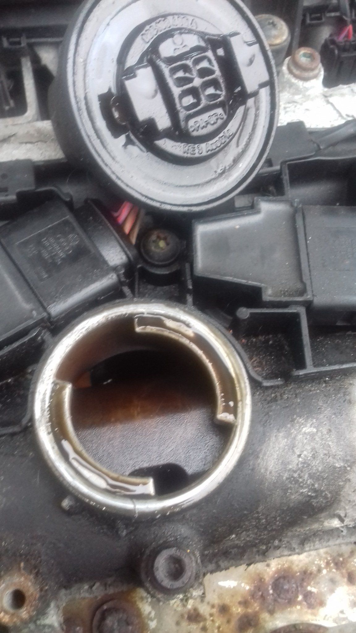

Anyway, the mechanic left the old spark plugs in a box with the other pieces he changed, and 2 of them looked a bit oily, on both the threads and the tip end, and on the ceramic insulator, so not looking too good. But when I had a look at the area of the coil packs, there seems to have been oil leaking from the filler cap into two of the spark plug wells. Now, I don't know which wells the oily spark plugs came out of, but I'm wondering if oil is leaking down there, I can see it getting to the ceramic insulator, but will it leak through to the threads and tip of the spark plug from there?
I've driven the car for the past 45k miles, haven't changed the spark plugs, and don't know when they were last changed, but have changed the oil and filters 3 or 4 times. Would oil getting in there be a reason for the high emissions?
Also, that plastic thing that the coil packs are sitting in, is it easy to remove that after taking out the coil packs? I'm thinking I should give it a good clean, and try to get as much oil out of there if possible.
I don't know if the oil cap is faulty, does that happen? Or maybe I was a bit careless pouring oil in on some occasions.

I would say just give it a good drive to the test centre get it nice and hot, then hope that the new plugs and air filter make a difference. With a stronger spark and better air flow, you may squeak through. High CO could be burning oil, but more likely it was unburnt fuel. Good luck, ,let us know how you get on

It’ll be the rocker cover gasket or someone spilt oil around the fill hole and didn’t clean it.

Had the car in this morning, and after changing spark plugs, oil, oil filter and air filter, the car passed ok, the CO at low idle dropped from 0.38 to 0.17. So that was ok.
