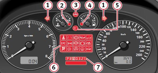

RE the red light and bleeps. - can you confirm what the red light looks like and where its located? sure its not the coolant level light? (is car on a slope?)
see link, is the light number 2? (coolant) or an oil can shape in the centre square?
http://www.diagnostic-world.com/_fa...lish/thumbnails/rev_14//main/1257352.1109.jpg
No slope. The red light looks like an oil can! It's on the right of the handbrake light.
