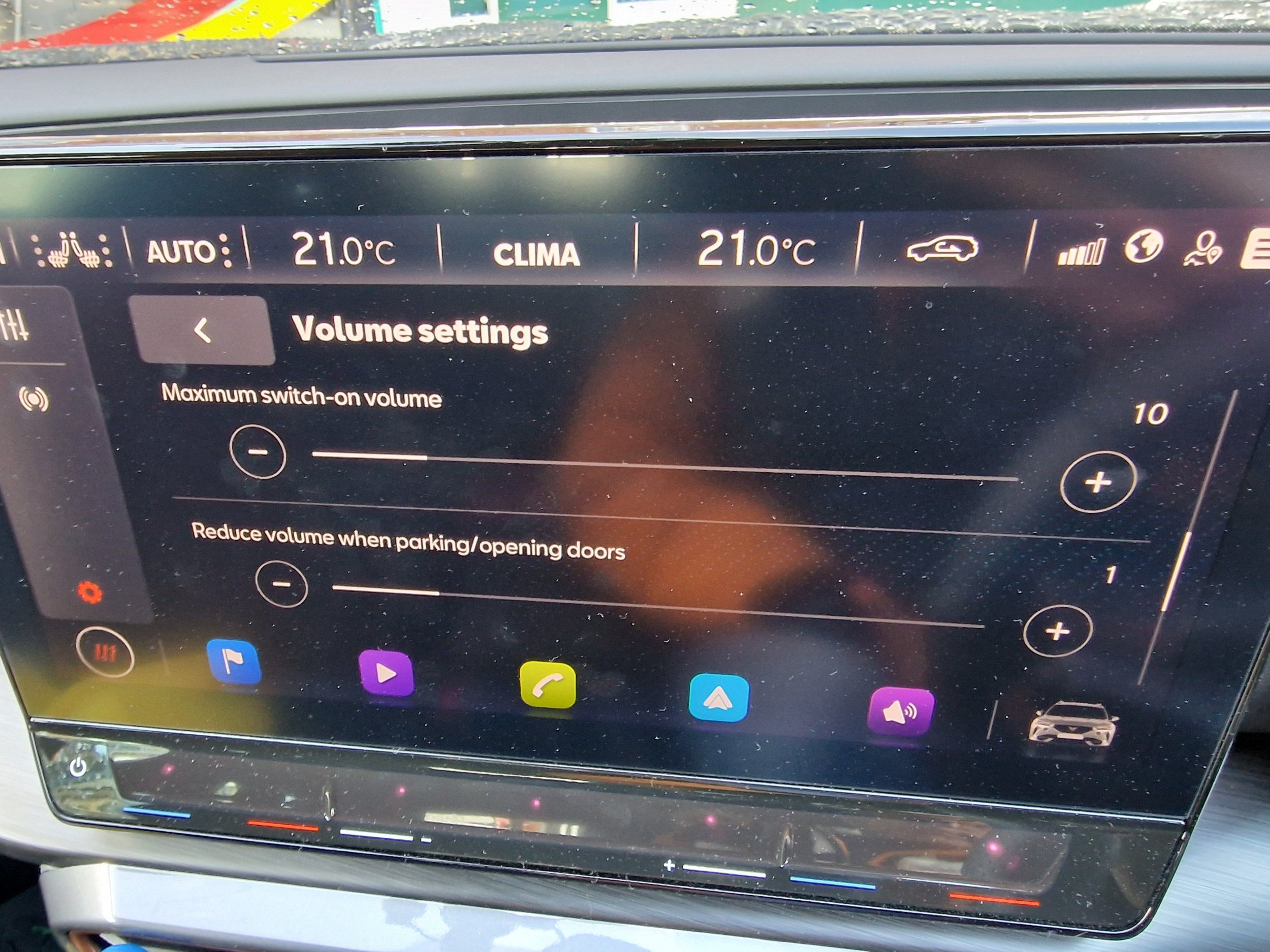

Well so fat mine is working well. Like you said after a long period of being switched off might work again and reset all.
Or just have a quick look in additional sound settings.
