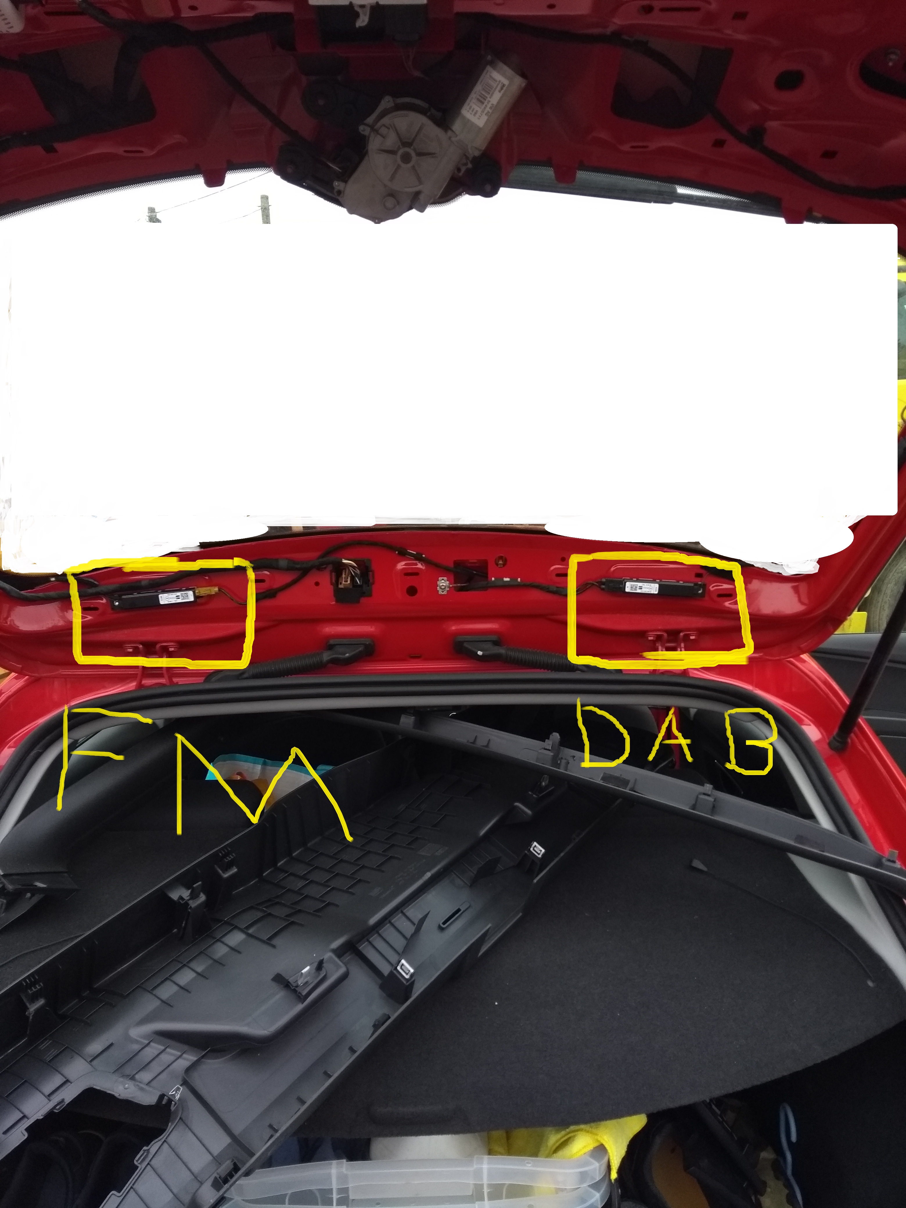

quick update, i tried RUM4MO`S idea, could`nt get cheap dab aerial connector to fit, found out the fm/am , dab , and sat nav gps aerial amplifiers are located in rear boot tailgate, pulled of surrounding plastic trim(no screws) and replaced dab amplfier with second hand unit off ebay...it now works and picks up all dab
stations......fm/am part # 5f4.035.225 dab part # 5f4.035.225 B
