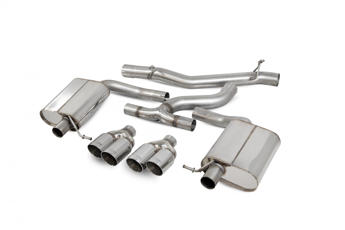

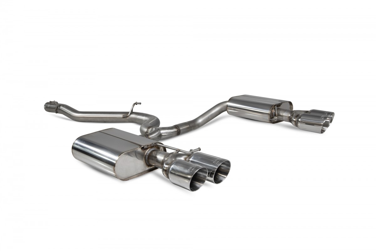

Hello everyone!
Im new to the forum and new to the MQB platforms and need some tips on exhausts for my 2018 Seat leon cupra 300 St 4wd.
I've been looking at the new Scorpion exhaust for the 2018-2019 Golf R Estate (part number SVWS057) and was wondering if you guys thin it will fit the 2018 Cupra St?
From what I've heard the Golf R estate and cupra 300 St 4wd are almost the same cars?
https://www.scorpion-exhausts.com/volkswagen-golf-mk7-5-estate-r-facelift-exhaust-systems
Some pictures of the new cat back for the Golf R estate

Just looking at the two on their site they seem different but best would be to send them a question and see what they say.

As the Carbon and Cupra R ST have the respective Golf R systems, it’s likely the Scorpion Golf R system would also fit until you get to the rear bumper. The rear diffuser will need to be cut.
Some people have fitted the OEM Golf R exhaust to the Cupra and just made a bigger opening.

Like said, it will fit with the diffusor cut, im using the Golf exhaust and did that, otherwise exactly the same dimensions.
