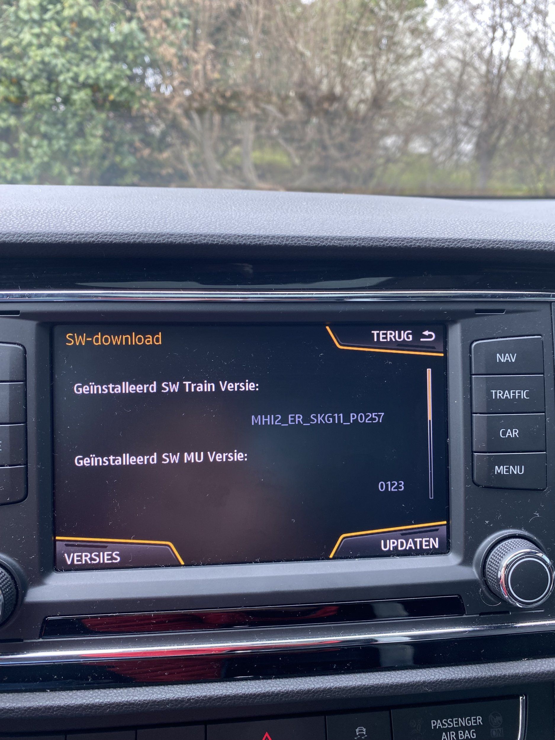

I have a few questions about carplay.
My sw version is very old(2015) i think.
SW train:MHI2_ER_SKG11_P0257 MU:0123.
I’ve read allready that there are a few difficulties with updating to a newer version bcs it’s skoda on seat infotainment. If someone can comment step by step how to do it, that would be very helpfull and thankfull.
If the update works I probably need to retrofit the usb-cable bcs it’s in the glovebox and doesn’t work with carplay.

To my knowledge you can update to the latest MU 1447 (MHI2_ER_SEG11_P4709). I did one of those latetly. But you do need an OBD devices or something like that to change the start up screen. You need to do this because it gets stuck in the update. It basically can't find the start up image and will stay on boot screen.
I would recommend to upgrade to a lower software version before performing the (AIO) MU 1447 update. For instance to MHI2_ER_SEG11_P3240 as this is the lowest version which is available on mibsolution. After this you can update to MU 1447. There is also an AIO MU 1447 which should work and also activate some missing features like Carplay and AA for example.
You can find these firmware versions on mibsolution.one, but like I said to activate al features and perform the update correctly you need an OBD dongle like OBD11 or someting like that. Also, see this thread below:
https://www.seatcupra.net/forums/th...fotainment-system.427280/page-87#post-5069266

I have obd11 eleven so that’s no problem, how do you change the start up screen ?
