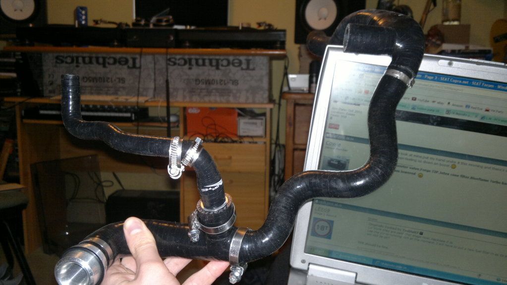

This is the kit I bought from the US
http://i1057.photobucket.com/albums/t399/Clear_Action/20032012237.jpg
So I threw away the suction jet pump, whole pcv system and the Y piece of the brake booster. I put in two bits of 8mm internal diameter silicone vac hose either side of the check valve coming off the manifold for the brake line. The brakes are working just as well as before so I'm guessing those hoses are not leaking.

The kit is a generic pipe for 1.8T engines. My elbow pipe snapped (the fat 90 degree one off the T piece to oil breather). Since all the silicone pipes out there still attach to my broken pipe I found this kit which replaces the whole system. I just had to sort out the brake booster line from the jet pump which is the same as when people install catch cans. the only difference between hose routes is that the T piece with the valve in lays horizontal rather than vertical but they both lead to the nipple on inlet manifold.
