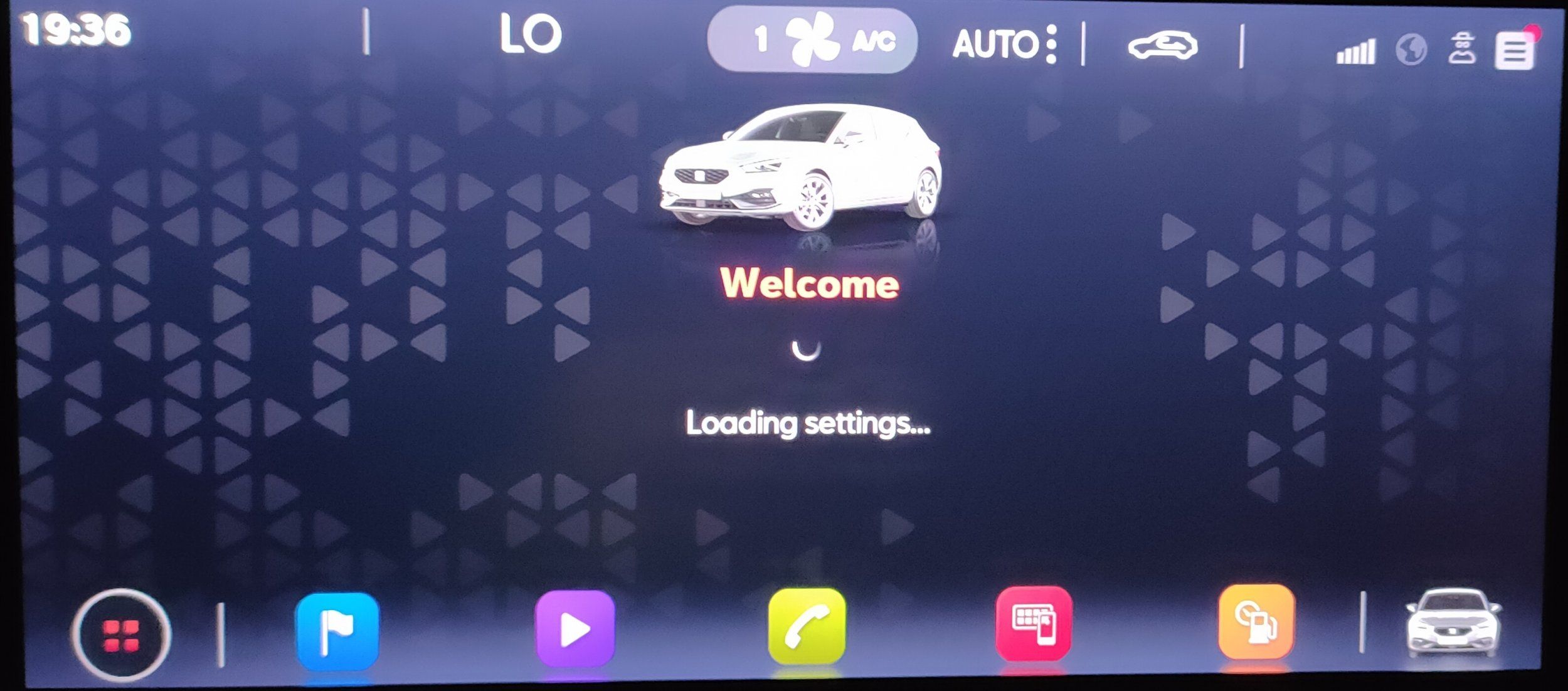

The Infotainment screen In my 2020 Seat Leon seems to have gone wrong. Why, because when I usually turn the cars ignition on the Infotainment screen takes a few seconds to load up and then the screen comes on. But over the last couple of days the welcome/loading settings screen Is permanently on and Is continually buffeting.
I can't use any of the apps at the bottom of the screen Including the built In Sat Nav. But luckily when I tap on the car symbol In the bottom right of the screen the stop start function and the lane control function are still working.
So my question Is please, Is there a way to re-boot the infotainment system and fix this issue myself or will the car have to go back to a SEAT main dealer to be fixed?
This Is the welcome/loading screen that Is permanently on and continually buffeting.
Cheers guys ?

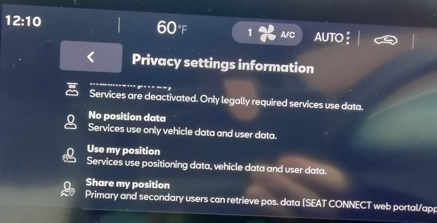

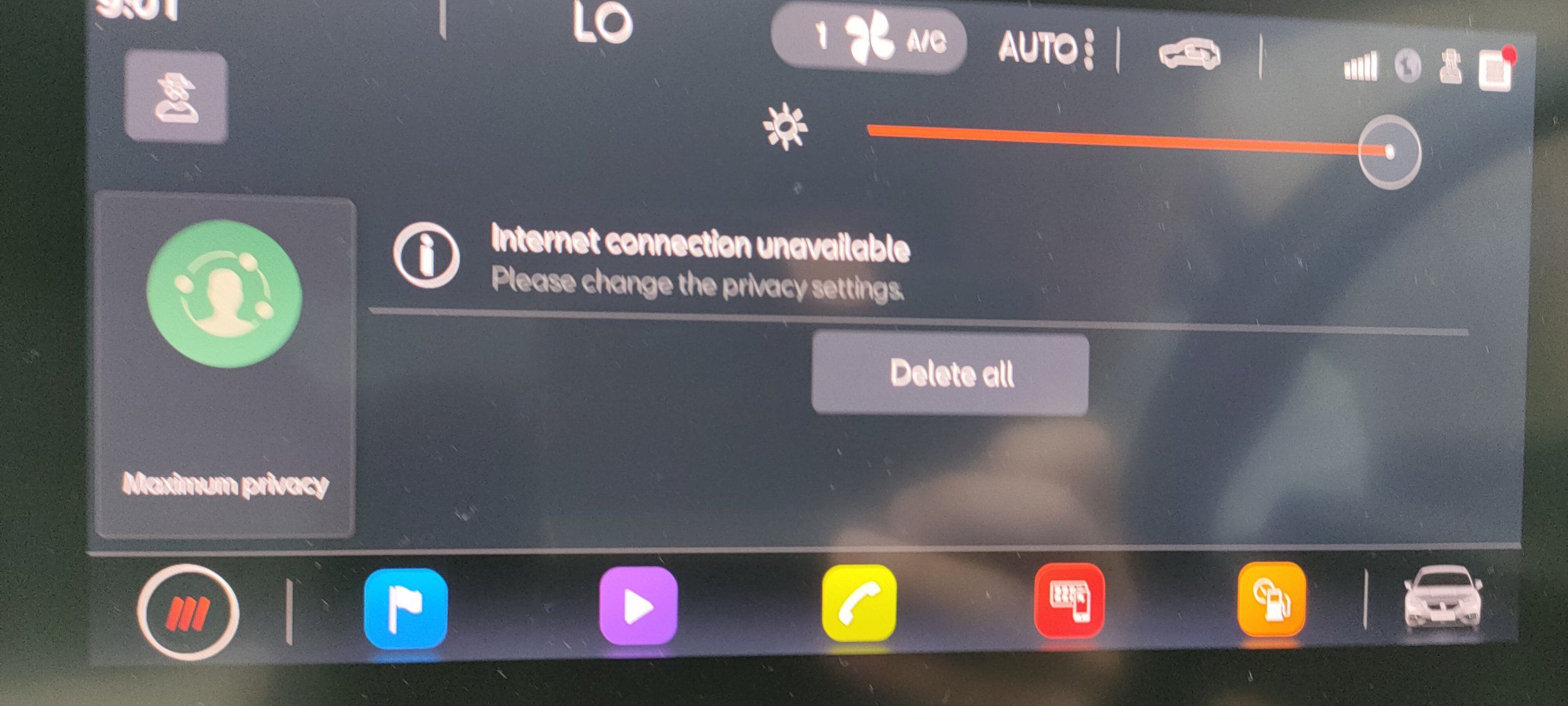

I believe when you have your privacy settings set to maximum privacy, you won't receive small infotainment updates.
Which every version of the system does, doesn't matter how old the software is.
@RoadXY. Thanks for the info. So If I was to change the privacy settings to "Share My Position", will I then receive notifications when there are updates available? Or Is It advisable to leave the privacy settings on Maximum Privacy and just let a SEAT main dealer sort out any available updates?
I changed the privacy settings on my wife’s Arona from maximum to minimum after the dealer had told us the car required an update. Waited for the update (24 hours at most) carried out the update and returned the settings back to maximum. The dealer said that they couldn’t do certain updates

Hi guys.
Cheers guys ?
