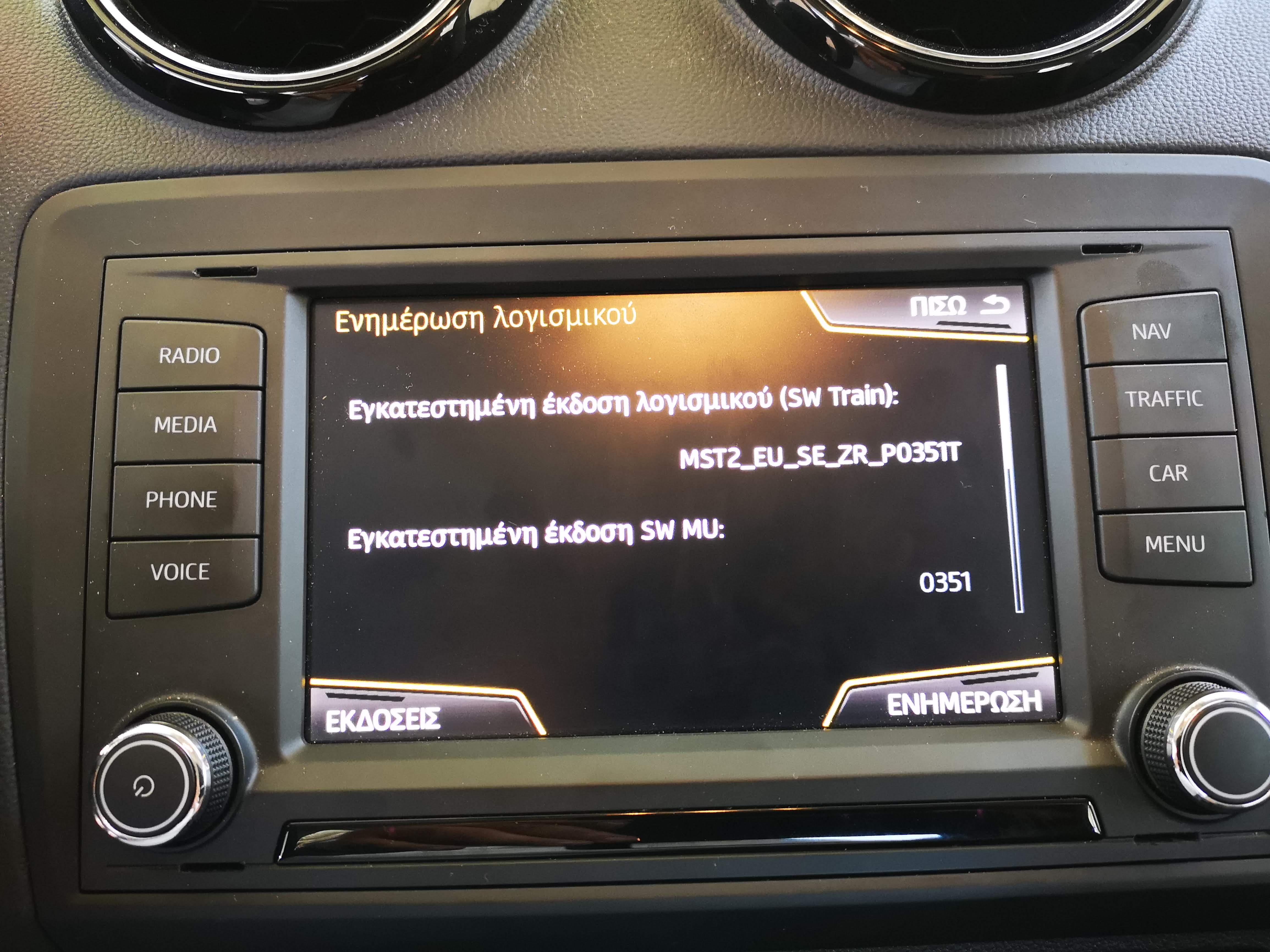

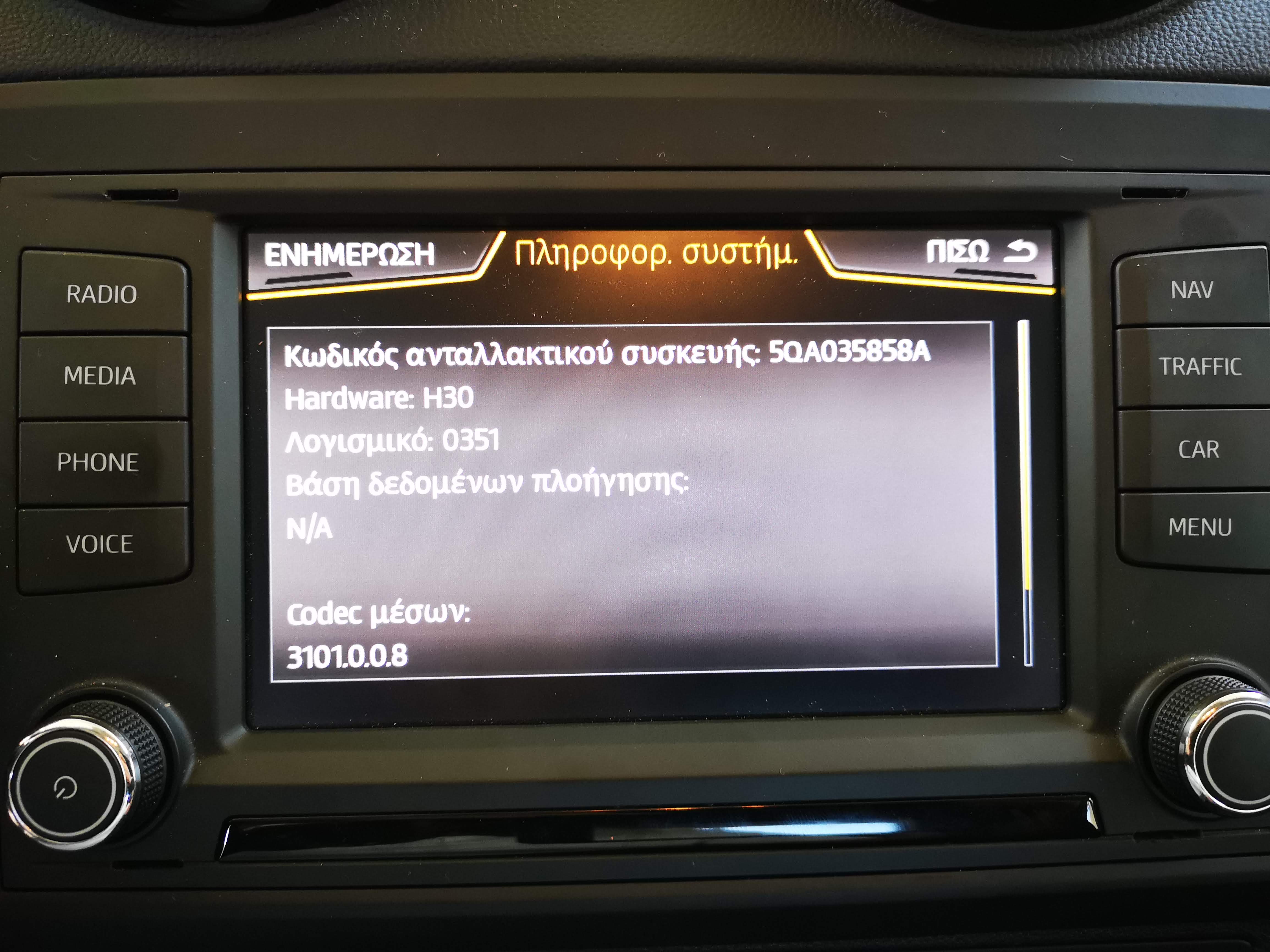

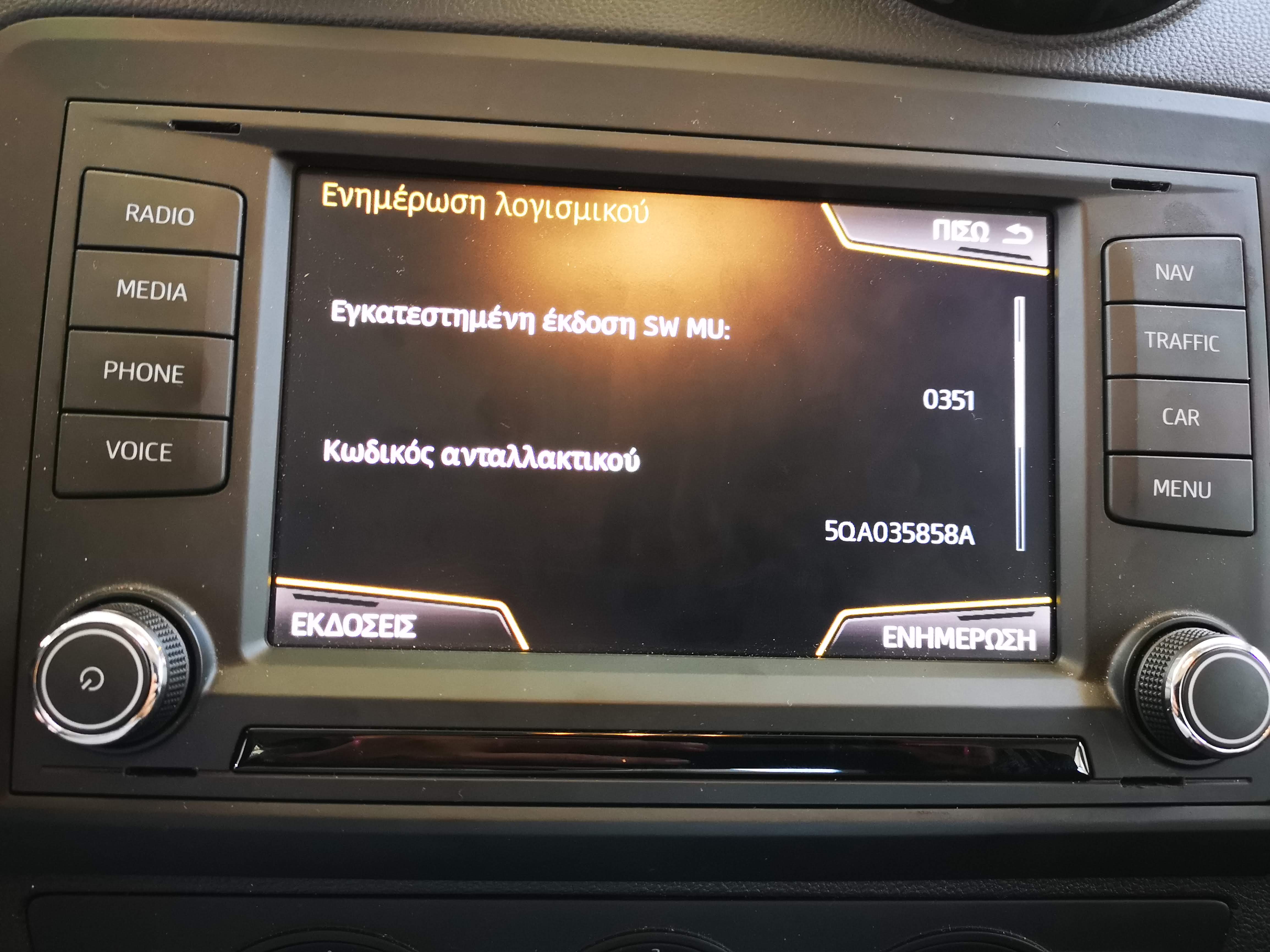

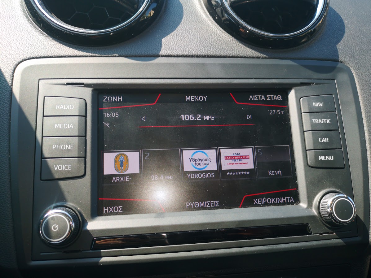

Well I have the car above the title says... I decided to upgrade my multimedia unit because my old unit didn't have Navi or full link ability...
I bought one from Ebay... The unit came with full link ability installed and tried. It came also with the official maps sd card... .
My technician istalled it on my dashboard... Everything look well...
After that I went to the official local Seat dealer for odis diagnosis because the voice was "locked" ... The problem solved... BUT...

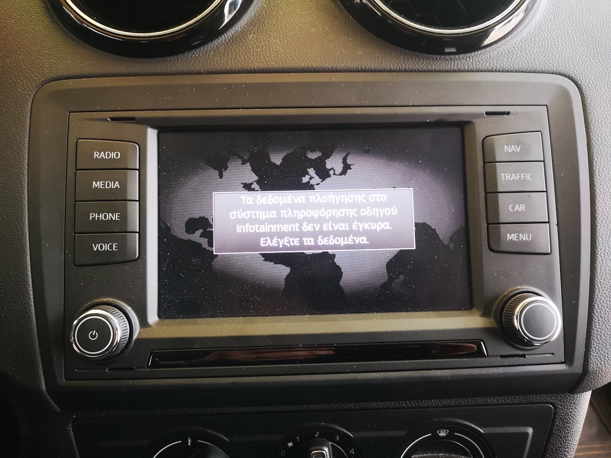

Yesterday, I tried to use it and I saw that some some functions were lost!

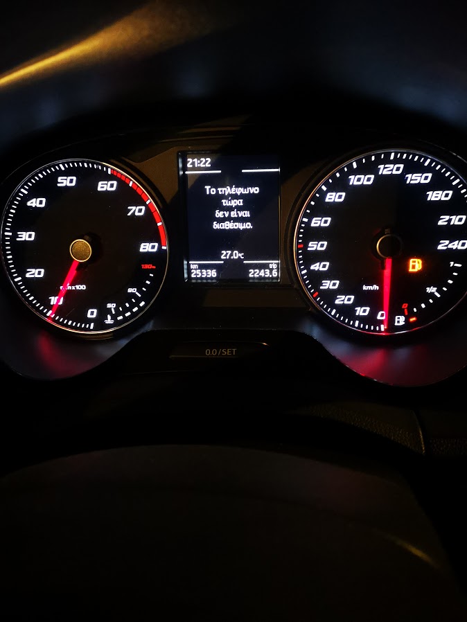

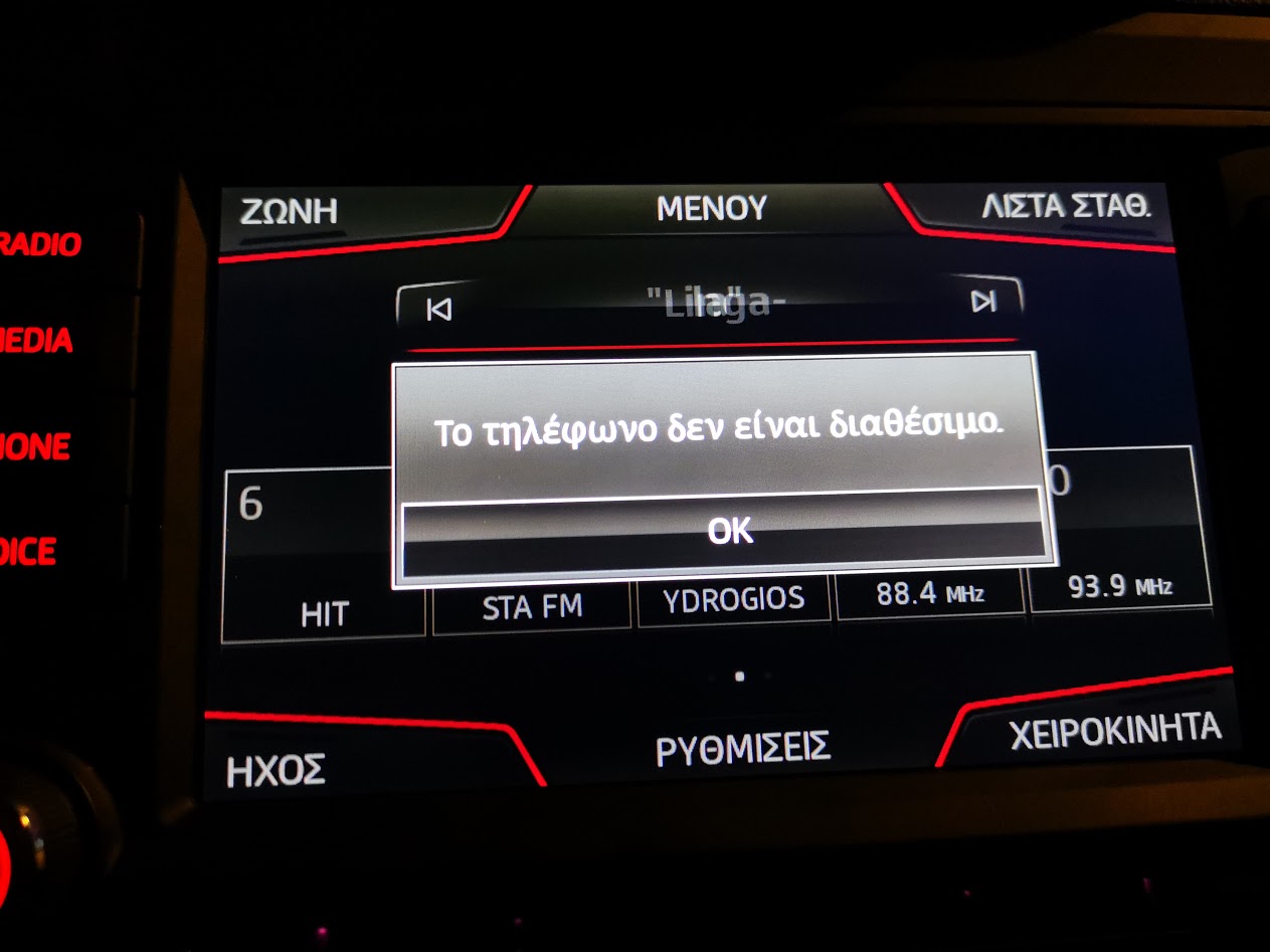

Phone is not available.. .and I cannot find the unit's bluetooth...
Navi is not working... the SD card with maps are in the head unit but it doesn't recognise them any more...

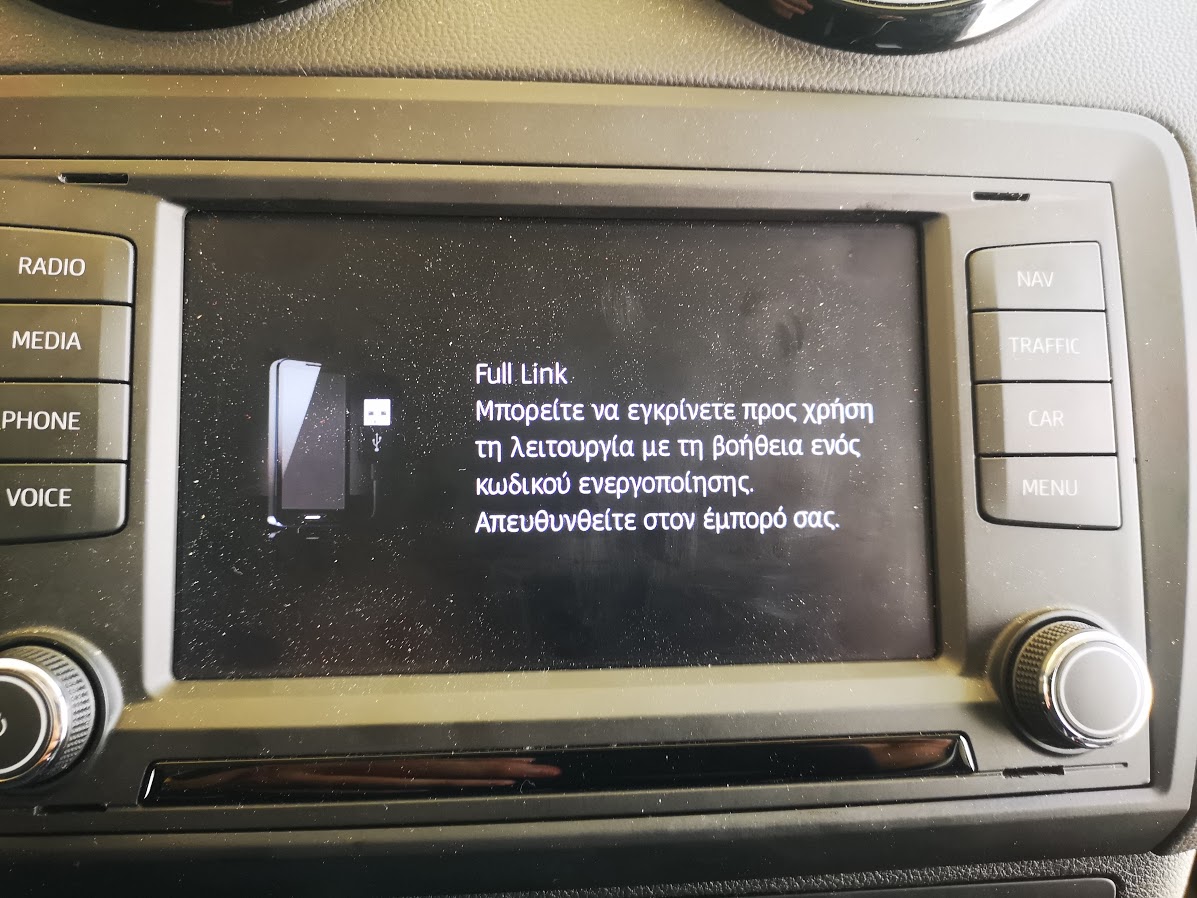

The full link ability seems to be lost also ... and it says that need to obtain it from the dealer!!!!

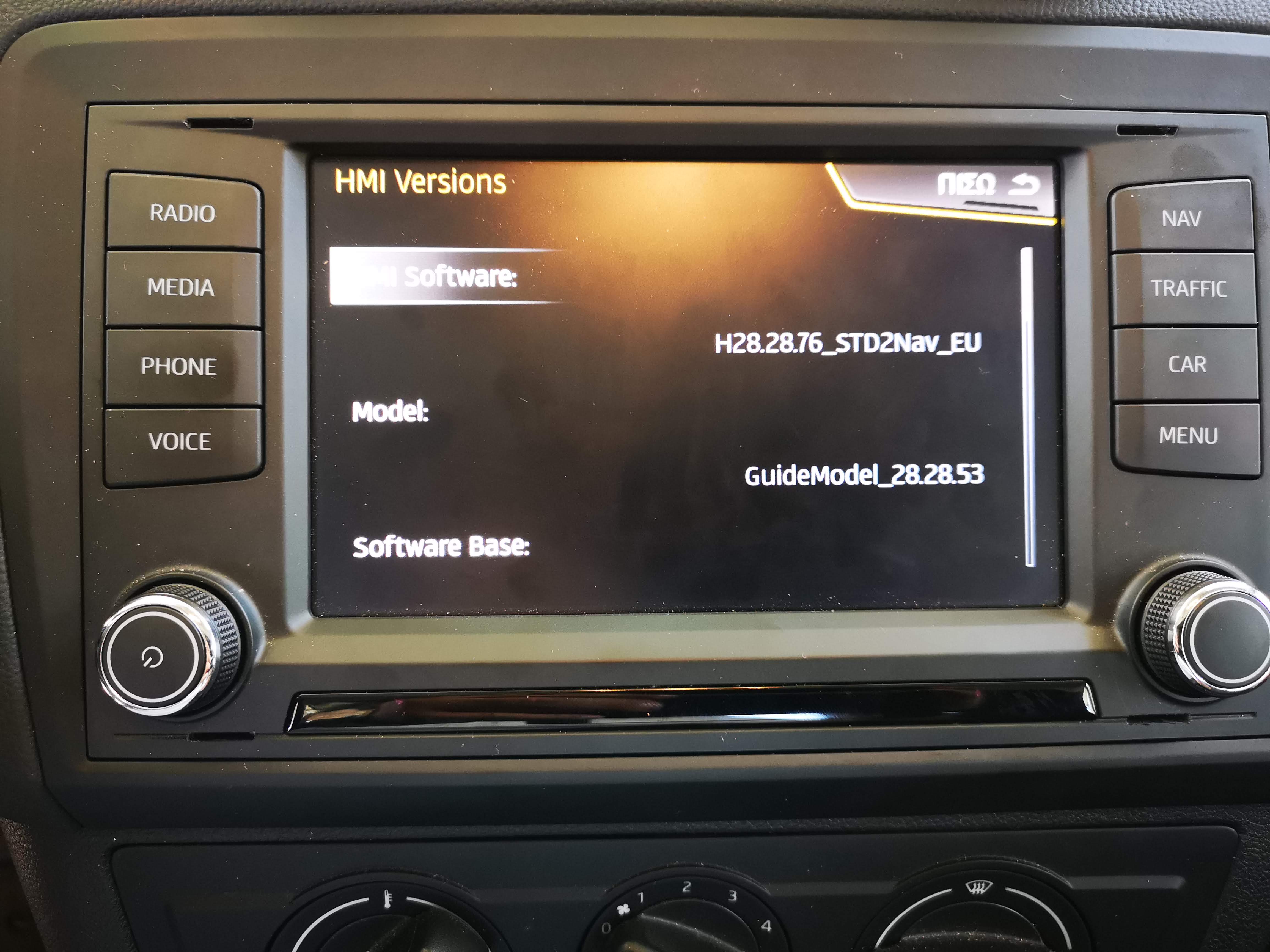

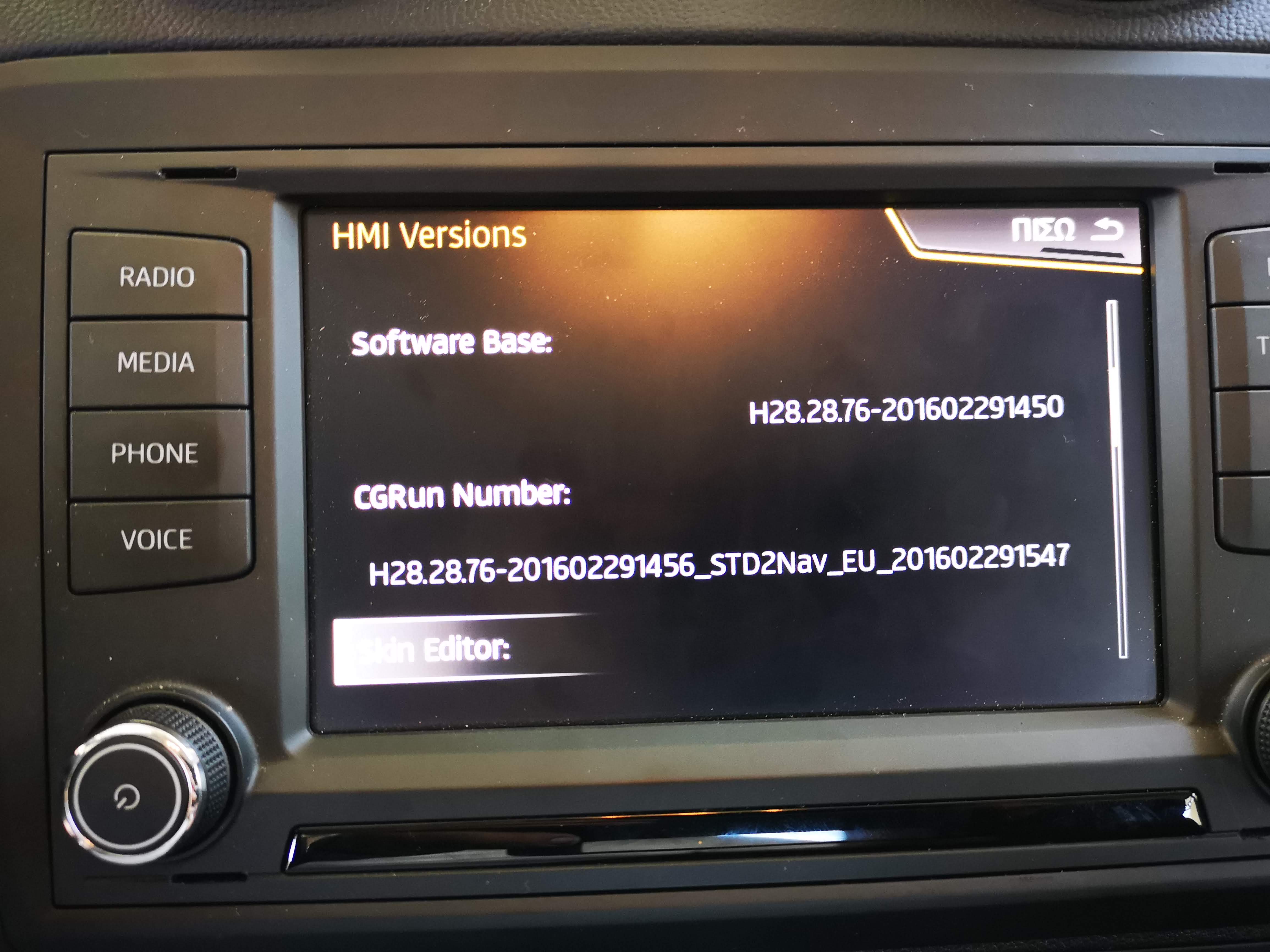

Please check also the photos below ... They maybe help to understand...

Hi, its problem. Firstly your unit was CP locked after connecting to your car because it was paired with different car. Your mechanic choosed bad solution for removing CP and now all licenses are lost from unit. Solution is connect mib unit to different car where all functions are available from factory then via odis online functions restore licenses then remove CP and then connect to your car or you can to buy another unit CP UNLOCKED!

On your car is possible to activate only functions from factory. If you want activate additional functions you need to pay for license or connect mib unit to another car and activate it.

Hi, I send you solution, it isnt possible to activate all functions in your car. You must connect unit to car with all functions activated from the factory and then via odis online adapt functions to mib unit but its possible only if mib unit isnt stolen (It isnt on the vw black list) PL guy is using this solution + then there is aplicated CP unlock

So, IF I want all the functions available in my car's unit, I must find and put my unit in another car which all these functions are activated, and then via the Odis online tool to activate the functions right??? Hmmm ... I don't know if it is possible to find a car in our city with all the functions activated... My unit surely is NOT STOLEN! It's from a damaged car from Lithuania... I bought it from ebay 100% reliable seller. Sorry but ... Who is the PL guy???
