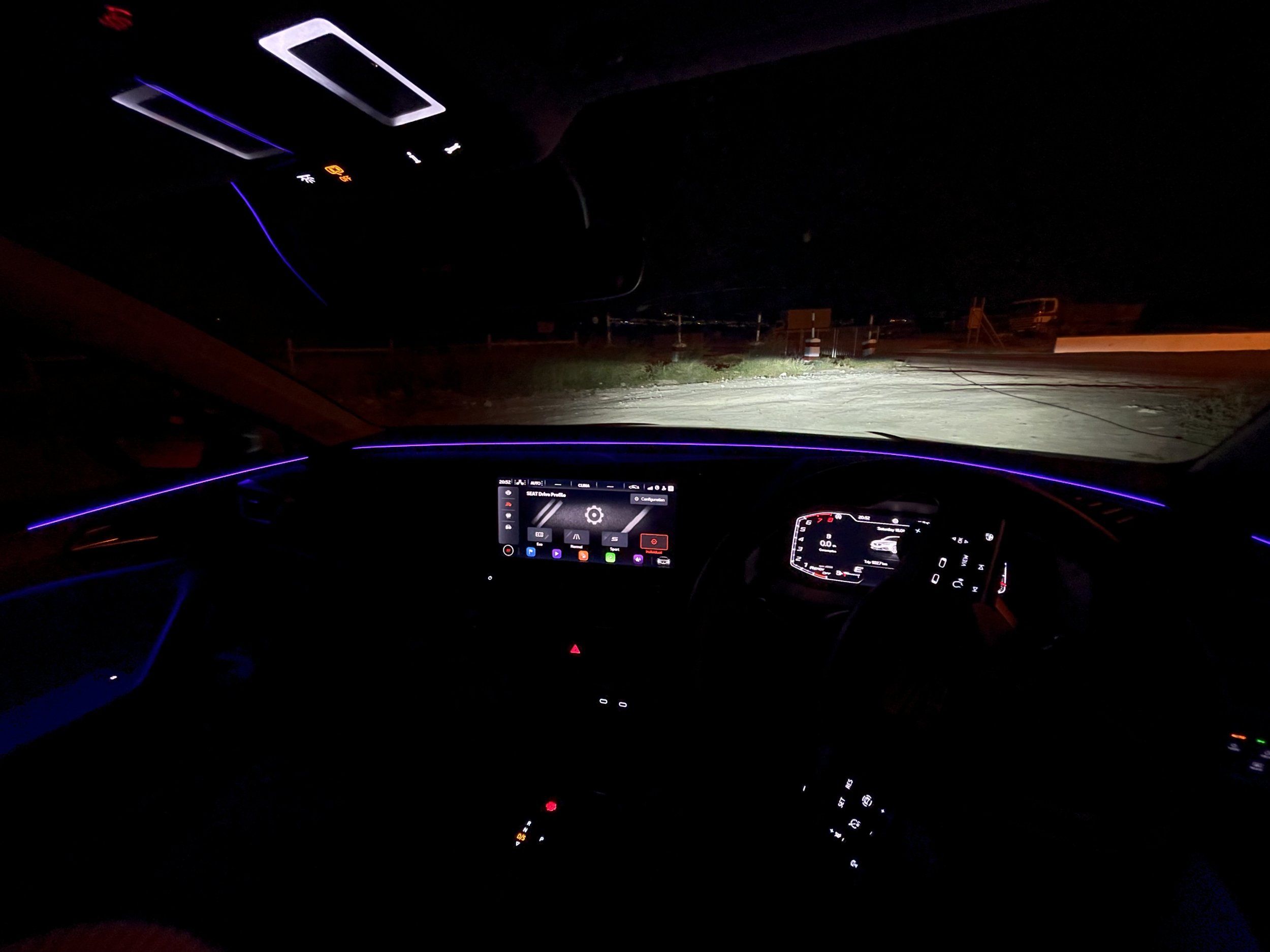

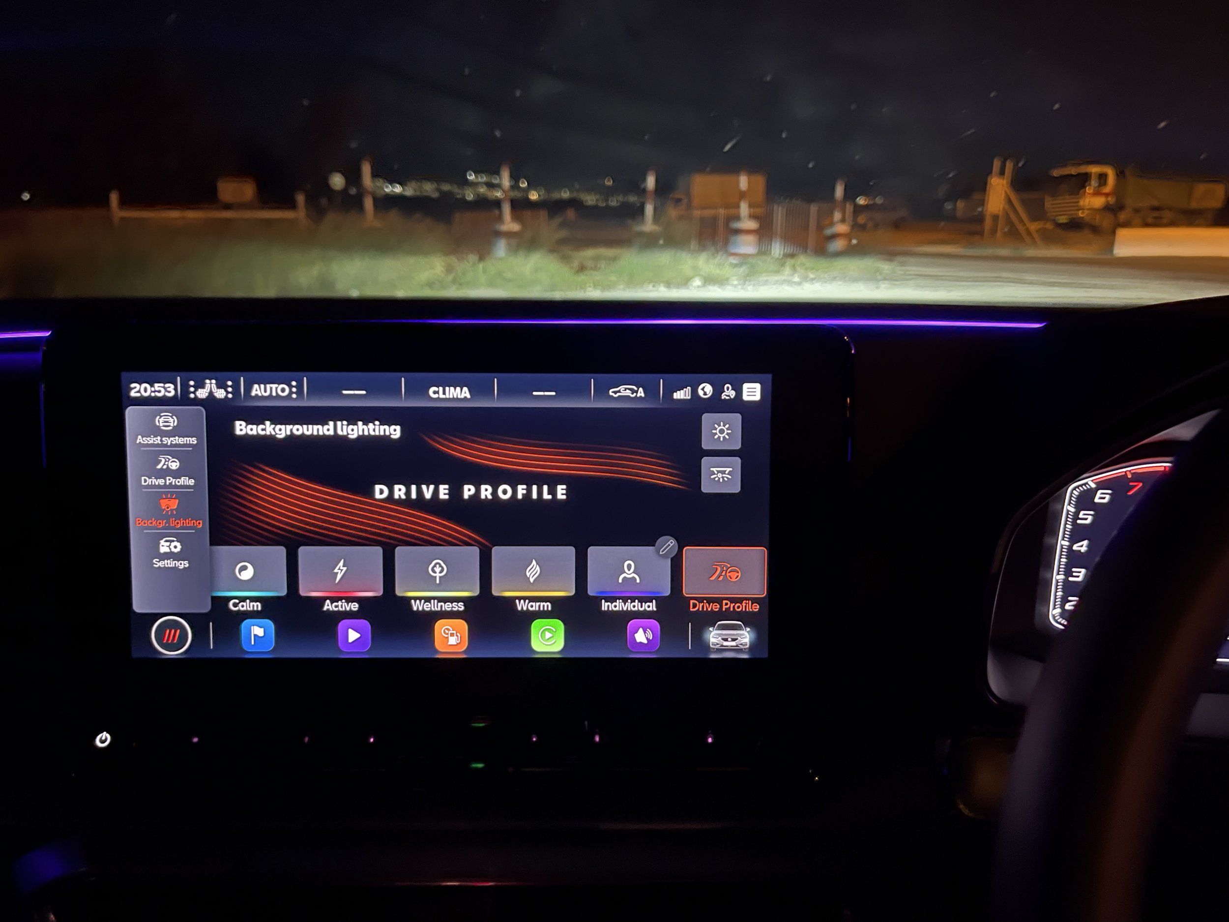

You have to go to background lighting in vehicle settings > select Drive profile as a light preference > then switch to individual drive profile
Thank you very much. Seems like a temporary solution to have access to the purple color for people with a DSG gearbox.
