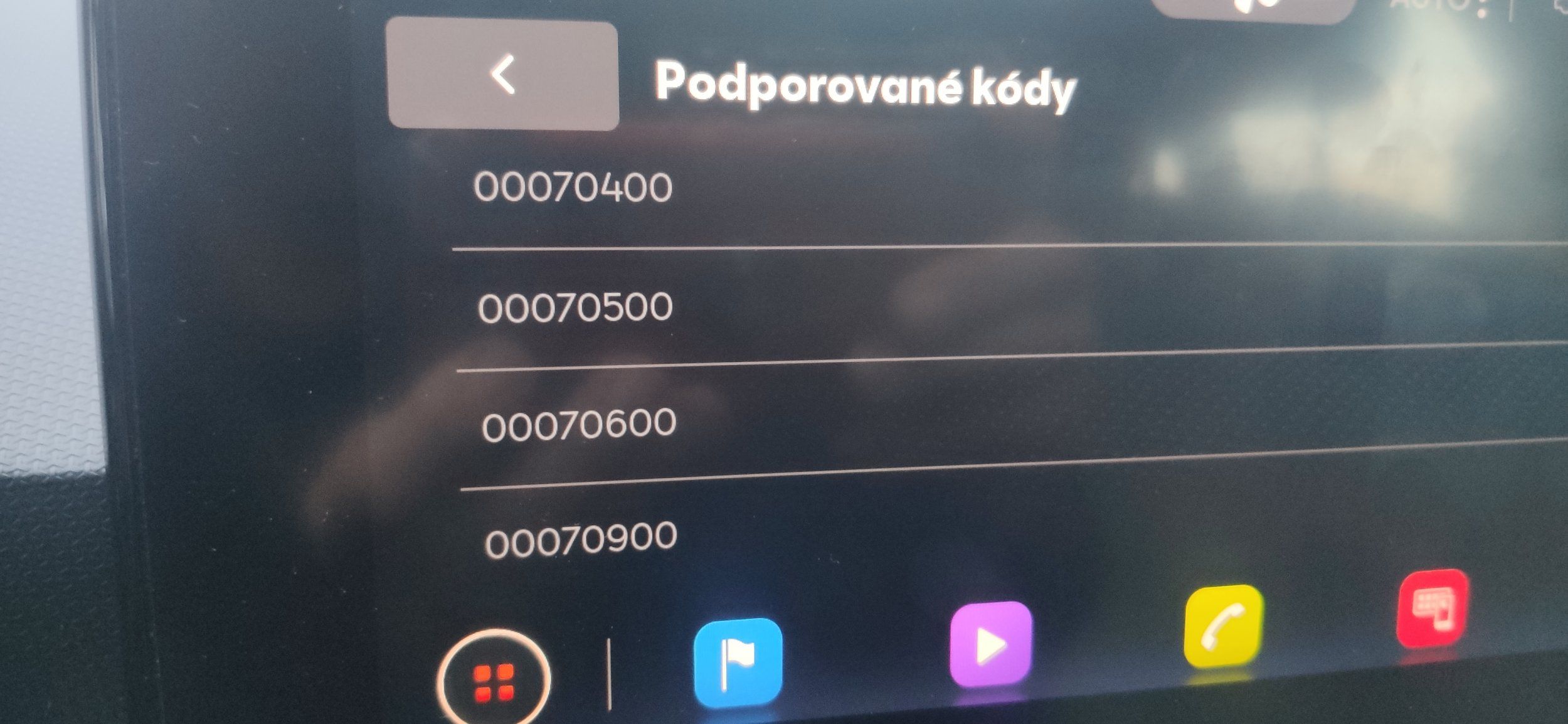

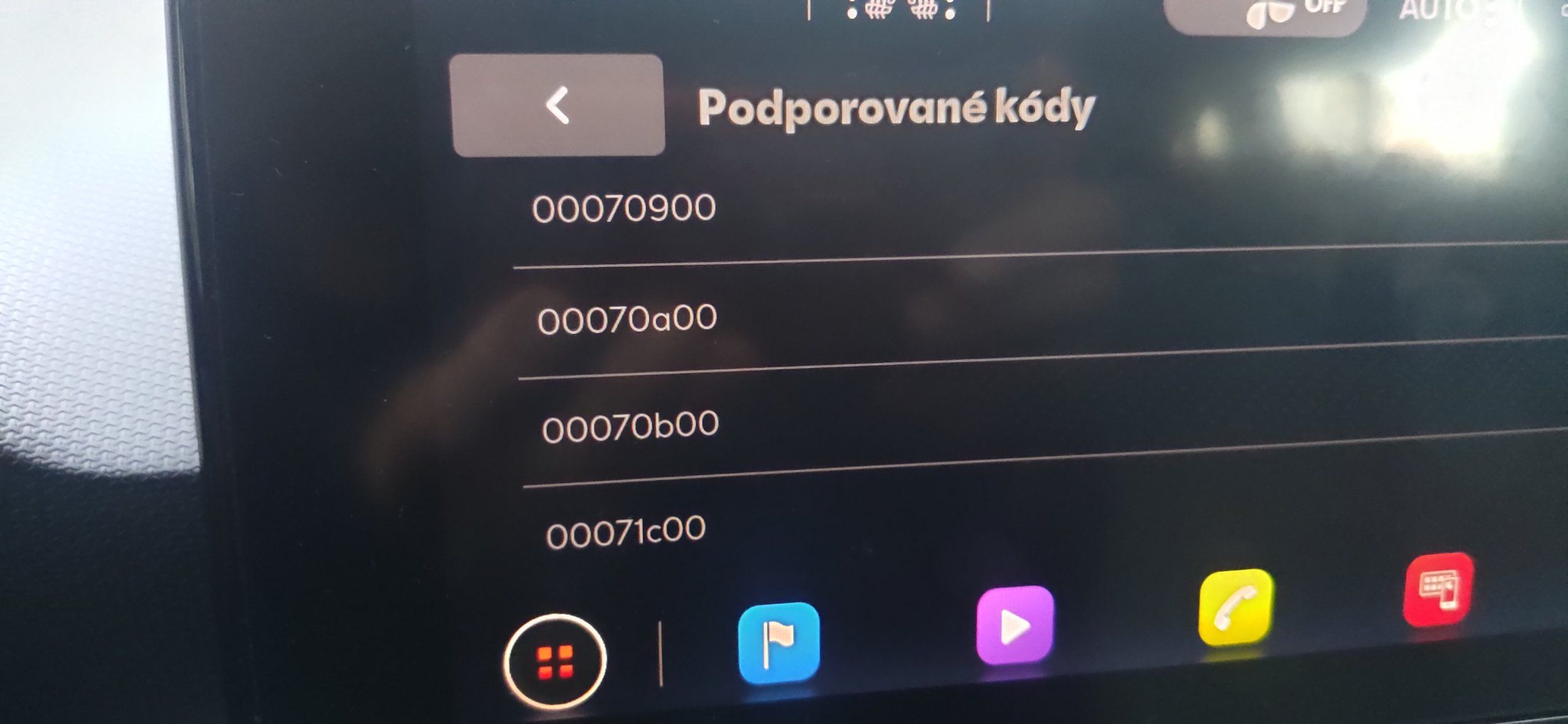

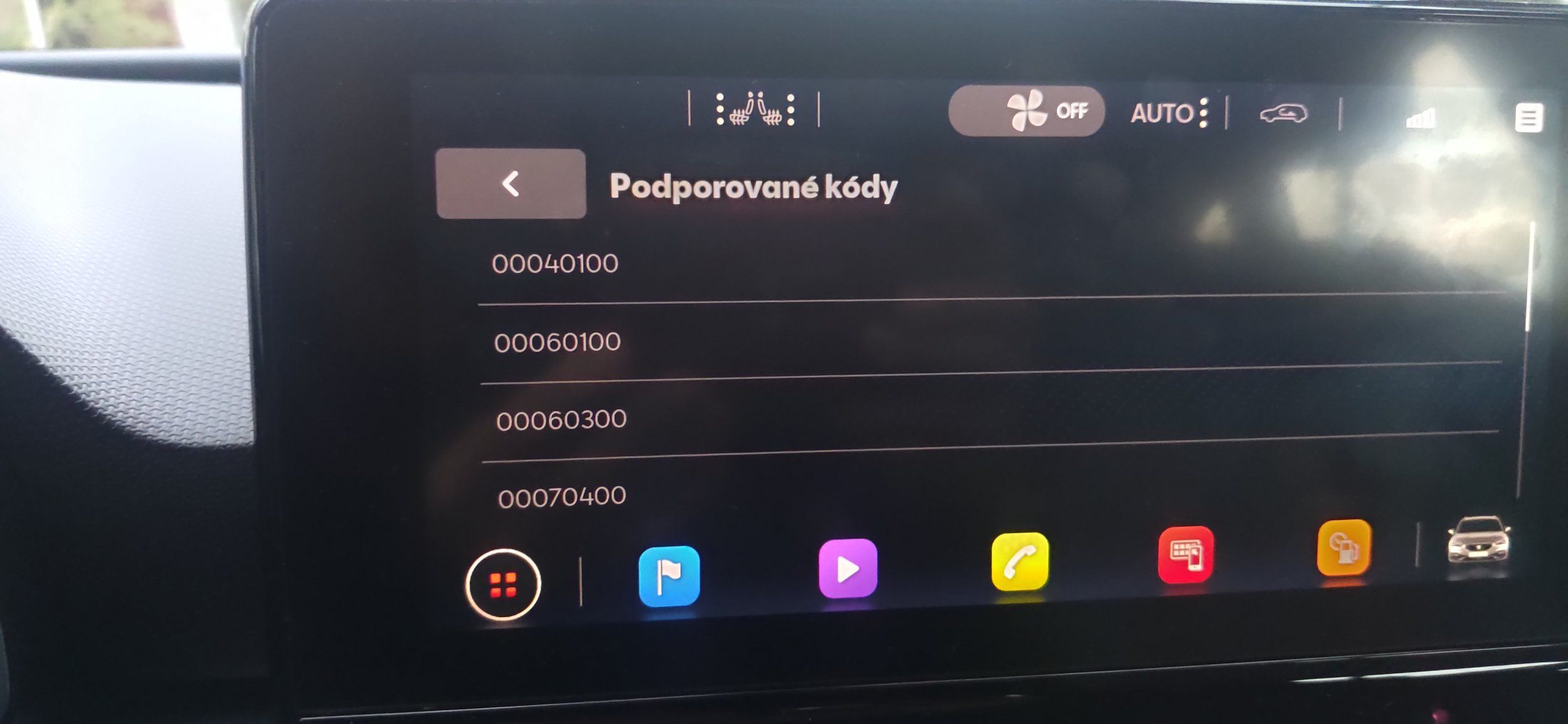

Thanks a lot for your answer. In Attachment are my supported codes. If I understand correctly, it is not possible to activate TSR or ACC on my car. wia SWaP/FoD. Right? Coddes for TSR (100E0F00) and ACC (e.g.10010200) miss.
