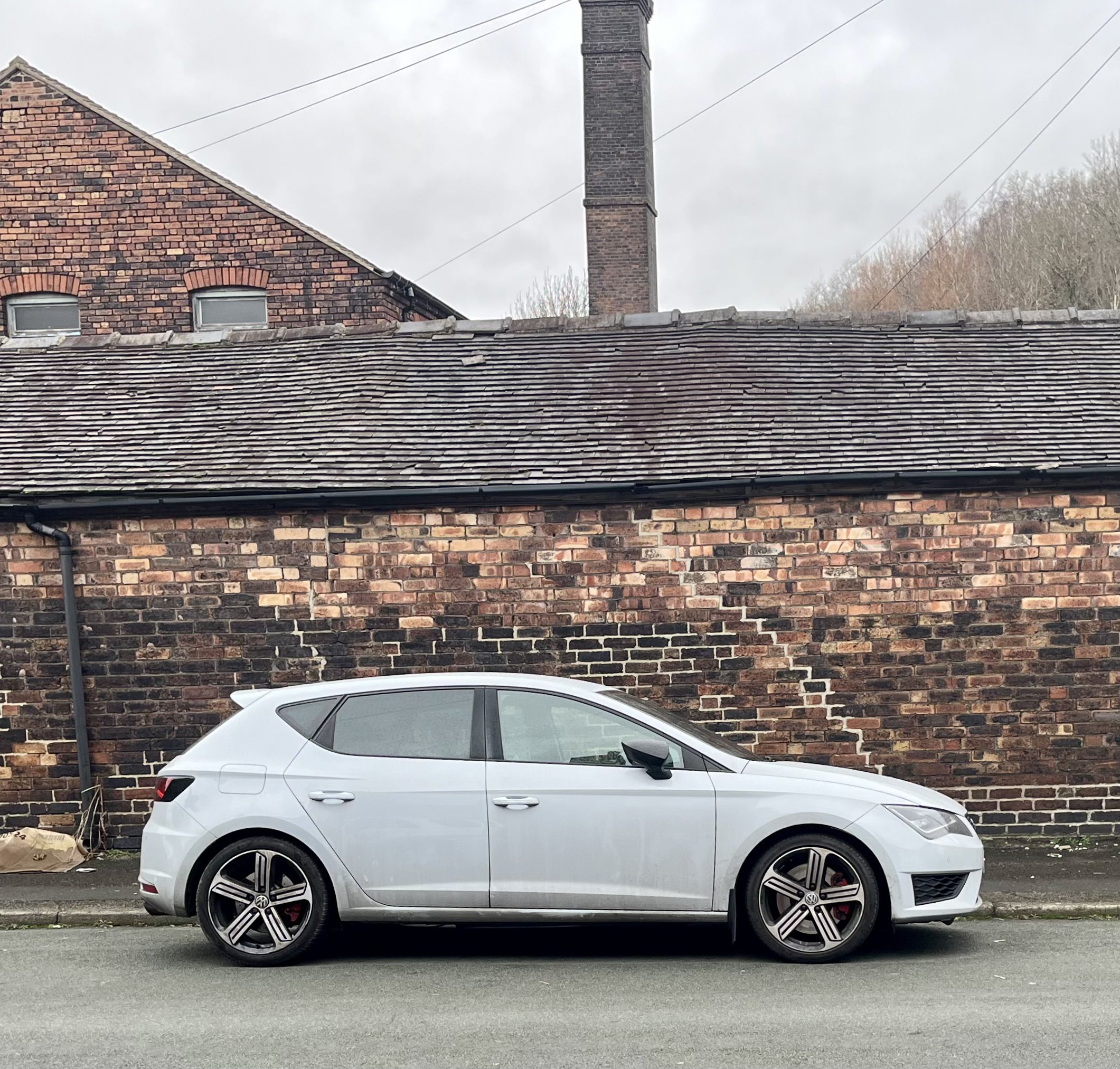

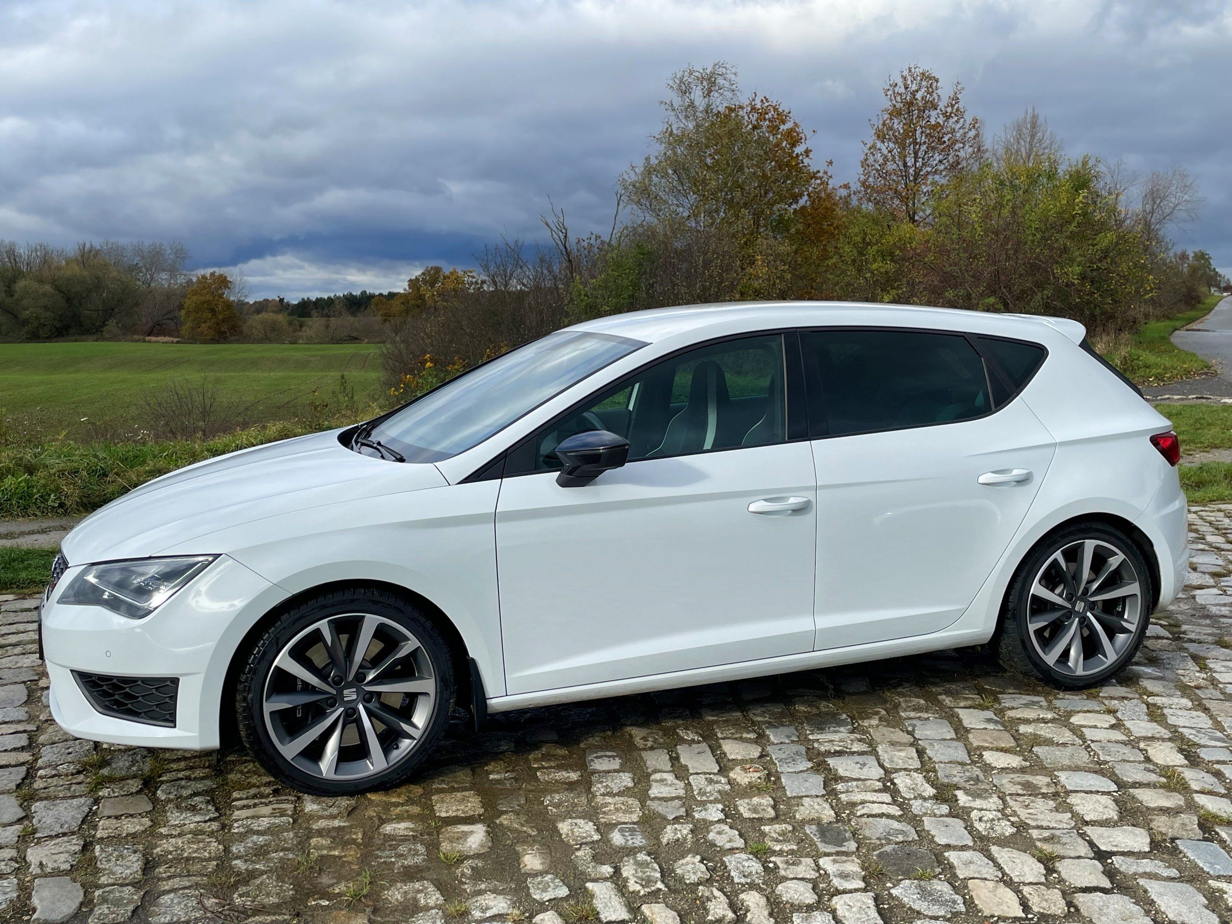

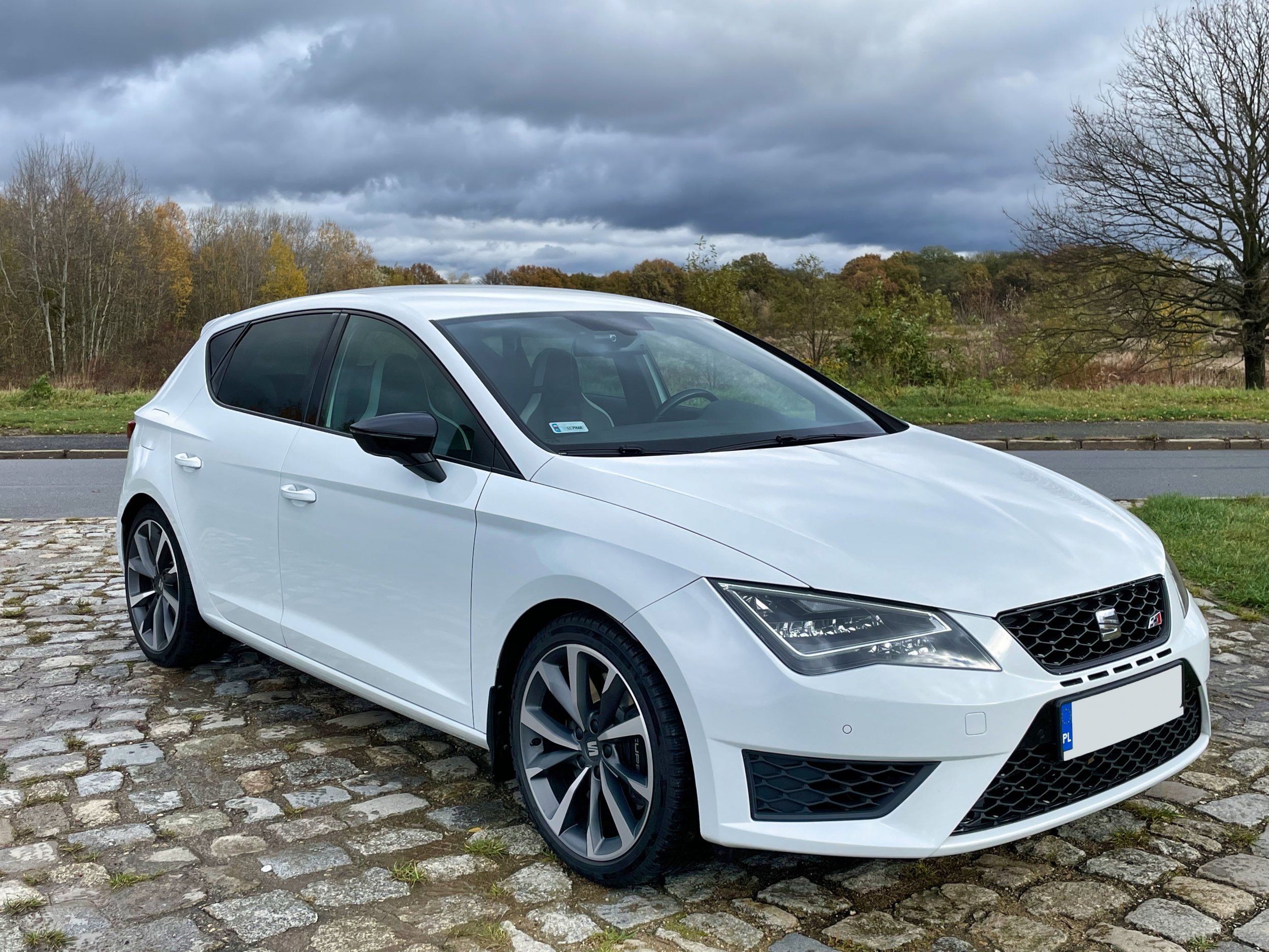

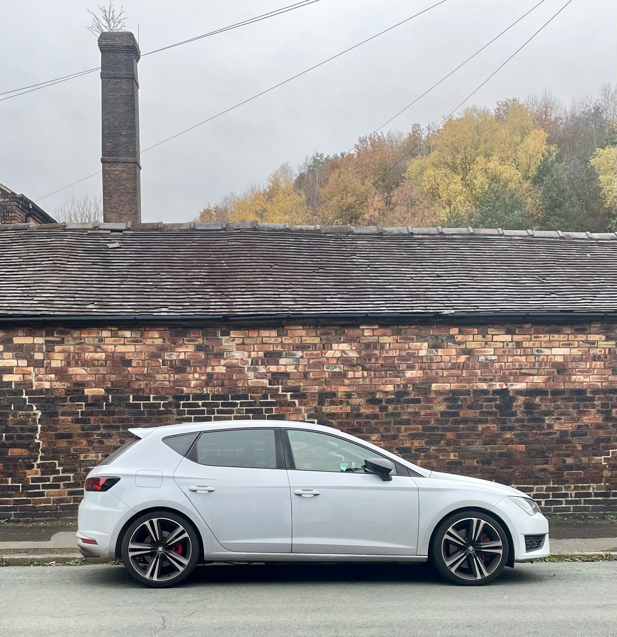

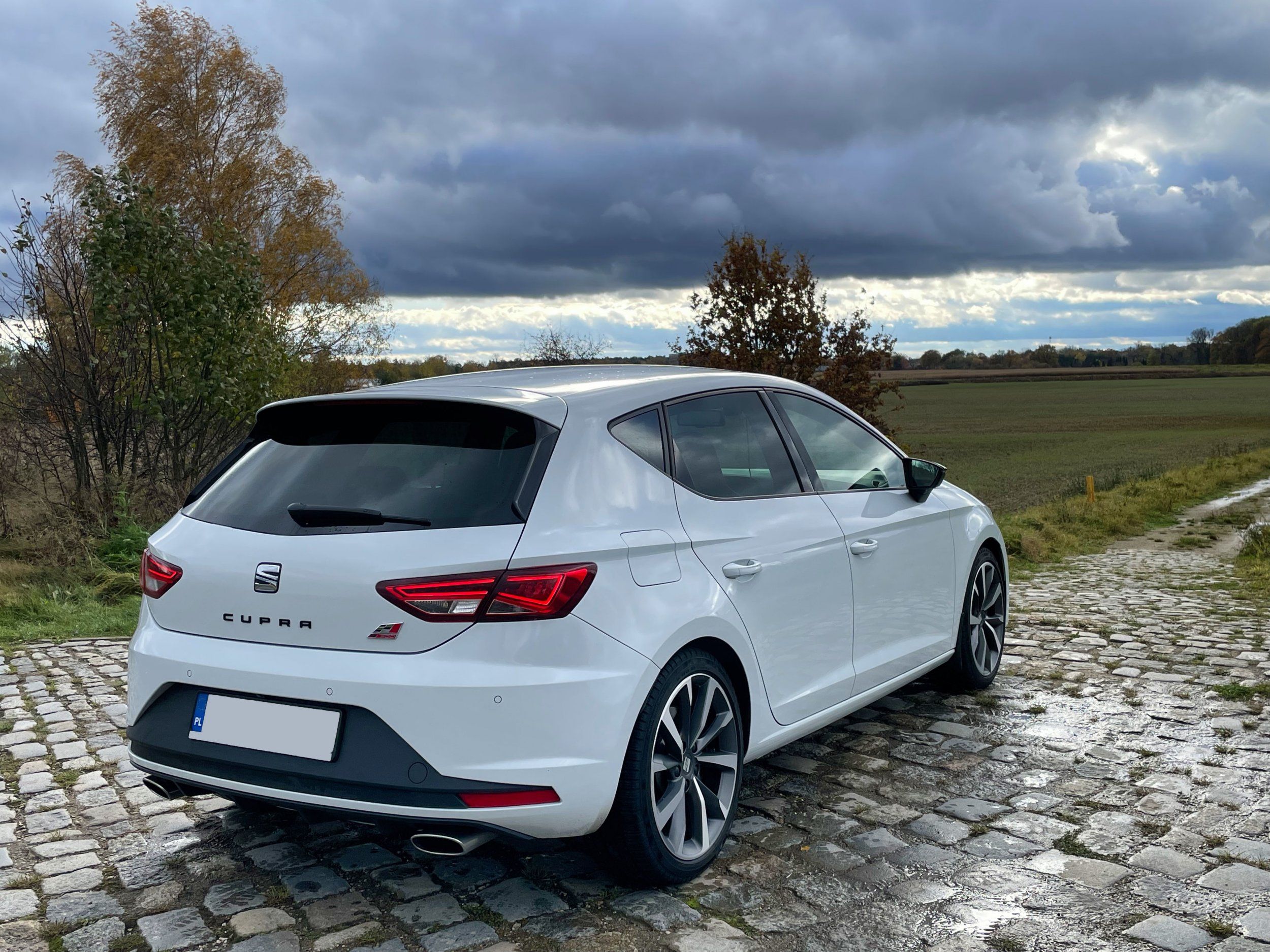

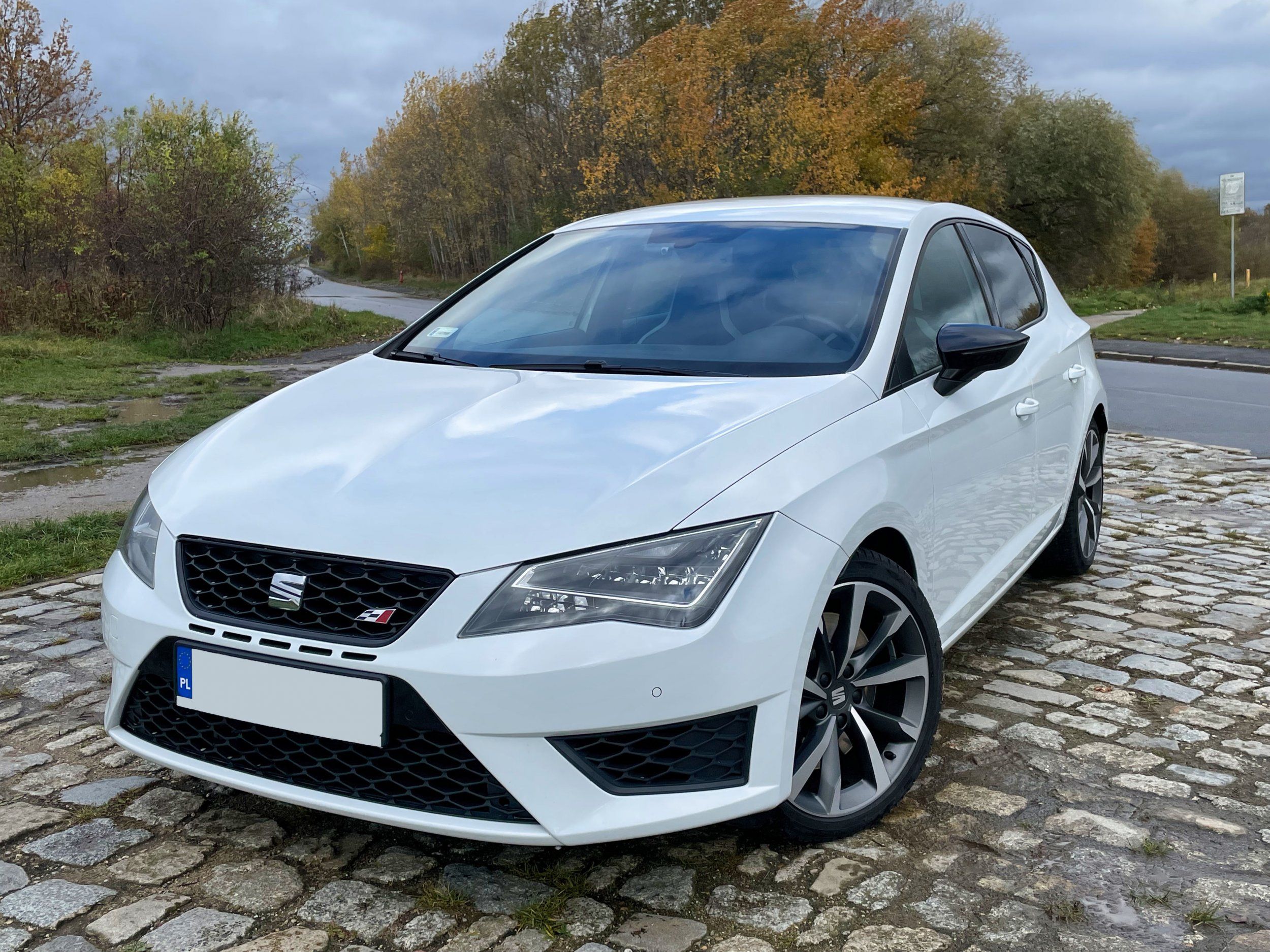

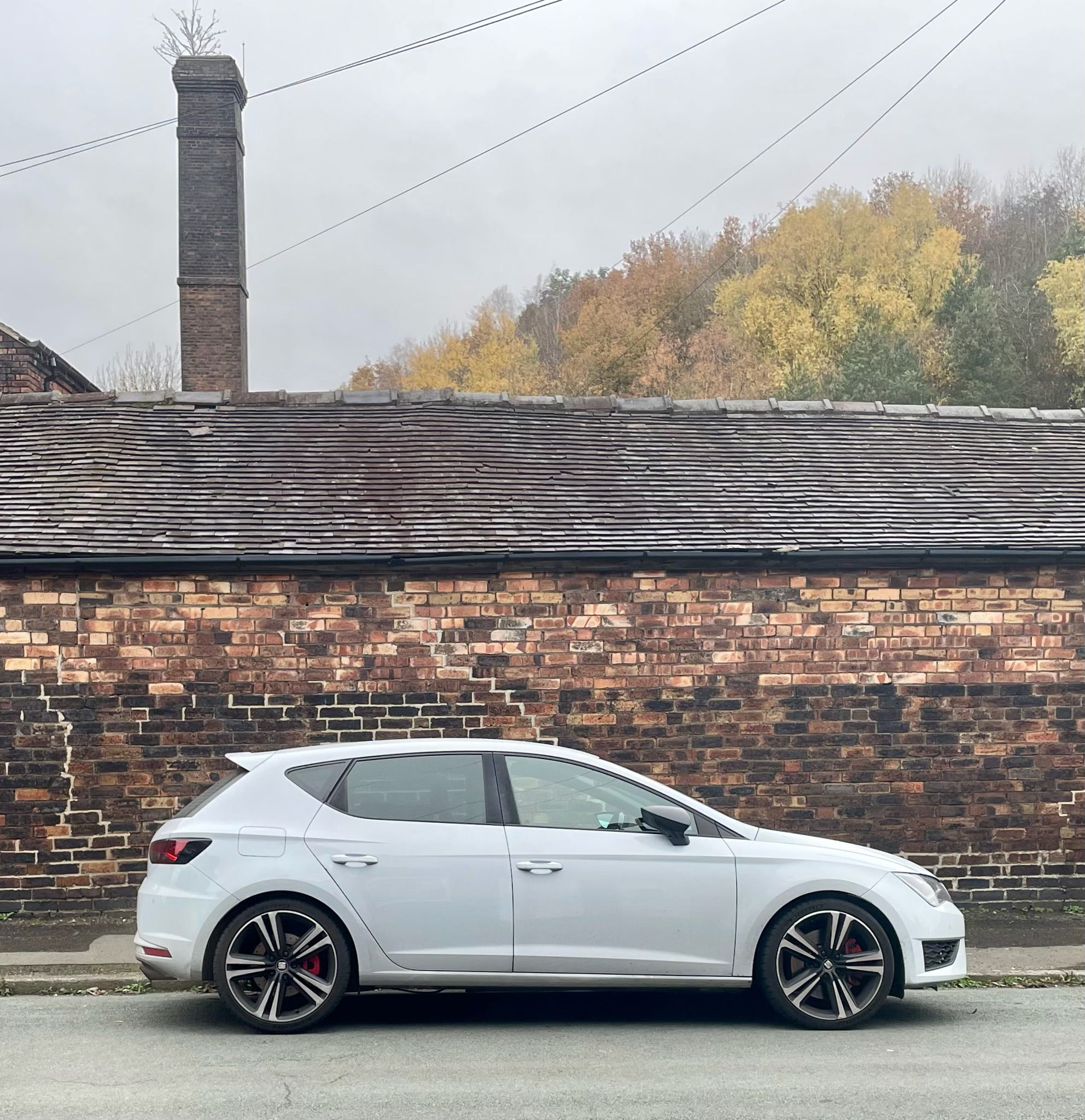

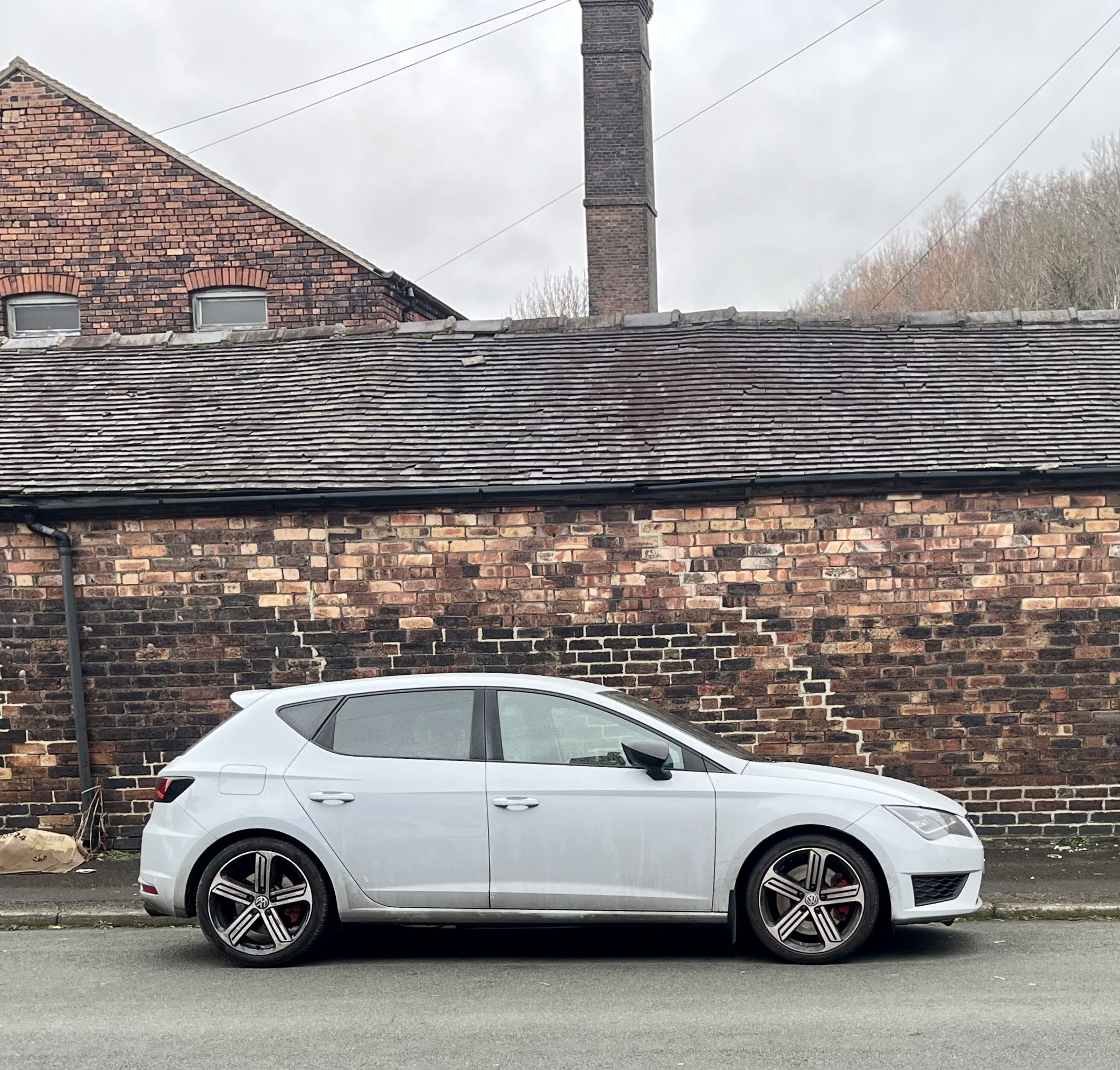

Hello! I created topic for multiple reasons. I'm thinking about purchasing R17 MK4 OEM used set of rims for MK3,5 2017 cupra, but afraid it could be "too small" for the cupra wheel arch, maybe someone have similar experience? Parameters are 17x7,5 et46
Just in case someone searching about "how will look my mk3 cupra with rims from mk4". I used to have my mk3 2015 with winter set of 18 inch tires and rims from regular leon IV. Because of wider rim and slightly more offset than stock mk3 r18 options it looks nice on old gen. 18x7 et51 for factory mk3, 18x7,5 et44 for factory mk4.
Feel free to post your own "retrofit" with 17 / 18 / 19 inches
