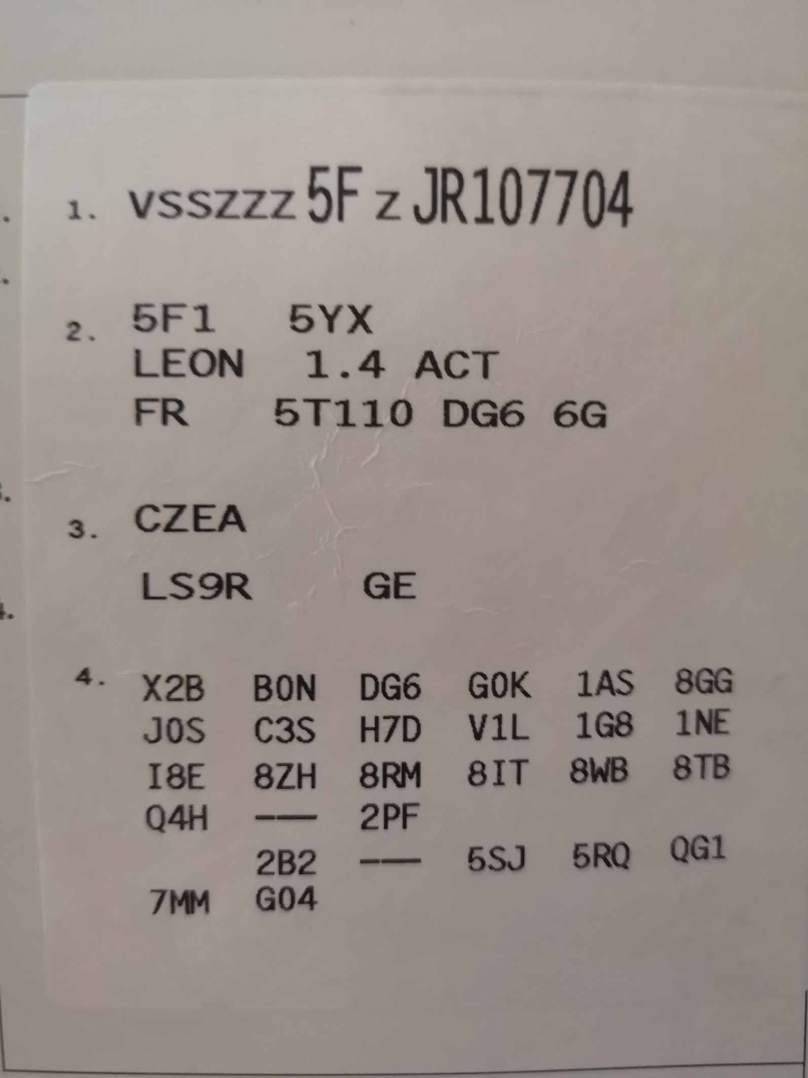

Thanks guys for your information so far, I'm still not 100% sure what size/ brake system is on my car. Looked up all my PR codes, in the handbook, and the brake PR codes are missing.
Does anyone have access to ETKA? maybe this would give me my brake codes.
My vin number is
VSSZZZ5FZJR107704
Thanks in advance

If someone can get any information from the above I will be extremely grateful 🙏

If you are really still unsure about which parts to buy, but want to work this out yourself, then why not head down to your nearest SEAT dealership parts department and ask them if they could please print off a copy of "CAR DATA" for your car, it tends to include more assembly build options that are on your car than the sticky build data label has on it.
After you have that info and found out, hopefully which front and rear brake options were fitted at the factory, then you can continue your "deep digging down" by looking on brake parts manufacturer's websites for their aftermarket kit part or stock numbers, then use that to buy from ECP etx.
Maybe a top tip is, check all the info that you have found online against what ECP is handing over to you BEFORE leaving the branch, doing that might save a lot of repeat visits.
Plus remember, as far as my experience has proven GSF and hopefully ECP have access to data bases that glean info from manufacturer's parts listings, so offering your reg number at the front desk should end up with you getting sold the correct parts, as opposed to you trying to select from their lists of "might fit" from their website.
My vin number is
VSSZZZ5FZJR107704
Thanks in advance
For that VIN,
Your front brake is:
TRW 288X25MM PR:1ZE,1ZJ
Rear brake
ATE 272X10MM 5X112 PR:1KE
