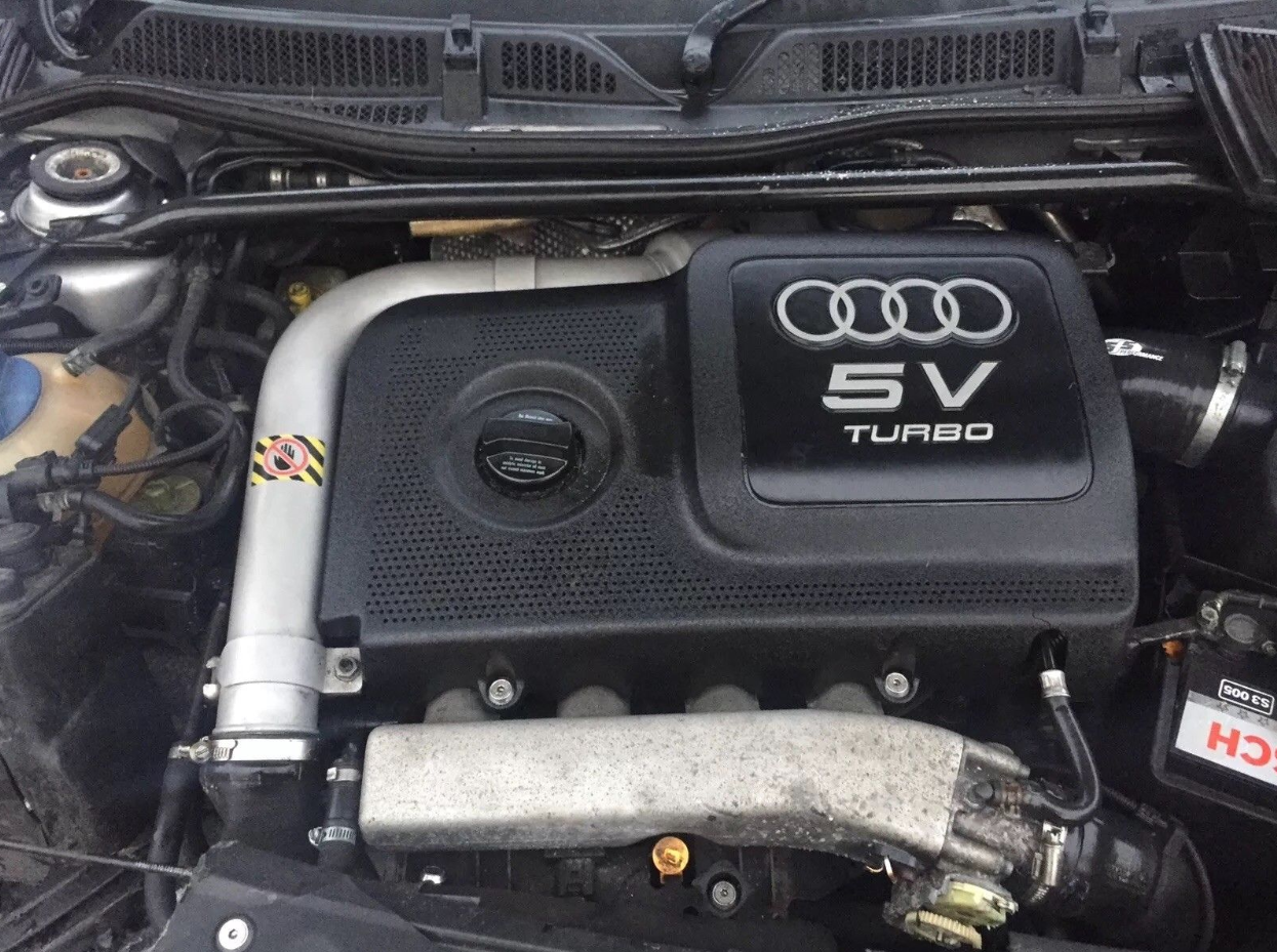

Recently purchased a complete BAM engine off an insurance write off.
I have a EBJ gearbox which I was going to mate to the ABF engine as the ratios were a bit closer and should improve acceleration. Plan now will be to use the standard CDA box and see how it fairs.
I was planning a track day in Feb but might put it off until March and get the BAM fitted in the mean time.

Engine out
Utilise existing CDA gearbox & engine mounts
BAM side engine mount removed and not used
Rear Ibiza mount fitted to engine block
Turbo oil return swapped for 1.8t engine KO3 variant (routed around 4wd transfer box so obstructs when rear Ibiza engine mount fitted)
Air con pump removed
BAM Power steering pump swapped for ABF to utilise existing PAS pipes
Replace aux belt to suit non air con model
QpENG 3” downpipe
Darkside VR6 clutch & G60 lightened flywheel
BAM engine loom spliced to Ibiza loom
Immobiliser delete
To do
Coolant pipe layout
Intercooler set up
Neuspeed ARB’s to be fitted
Loom installed
Engine fitted
Dash rebuilt
Install BAM fly-by-wire throttle pedal
Fabricate exhaust system (outsourced)
Hopefully easy follow for anyone else looking to do the same conversion.
