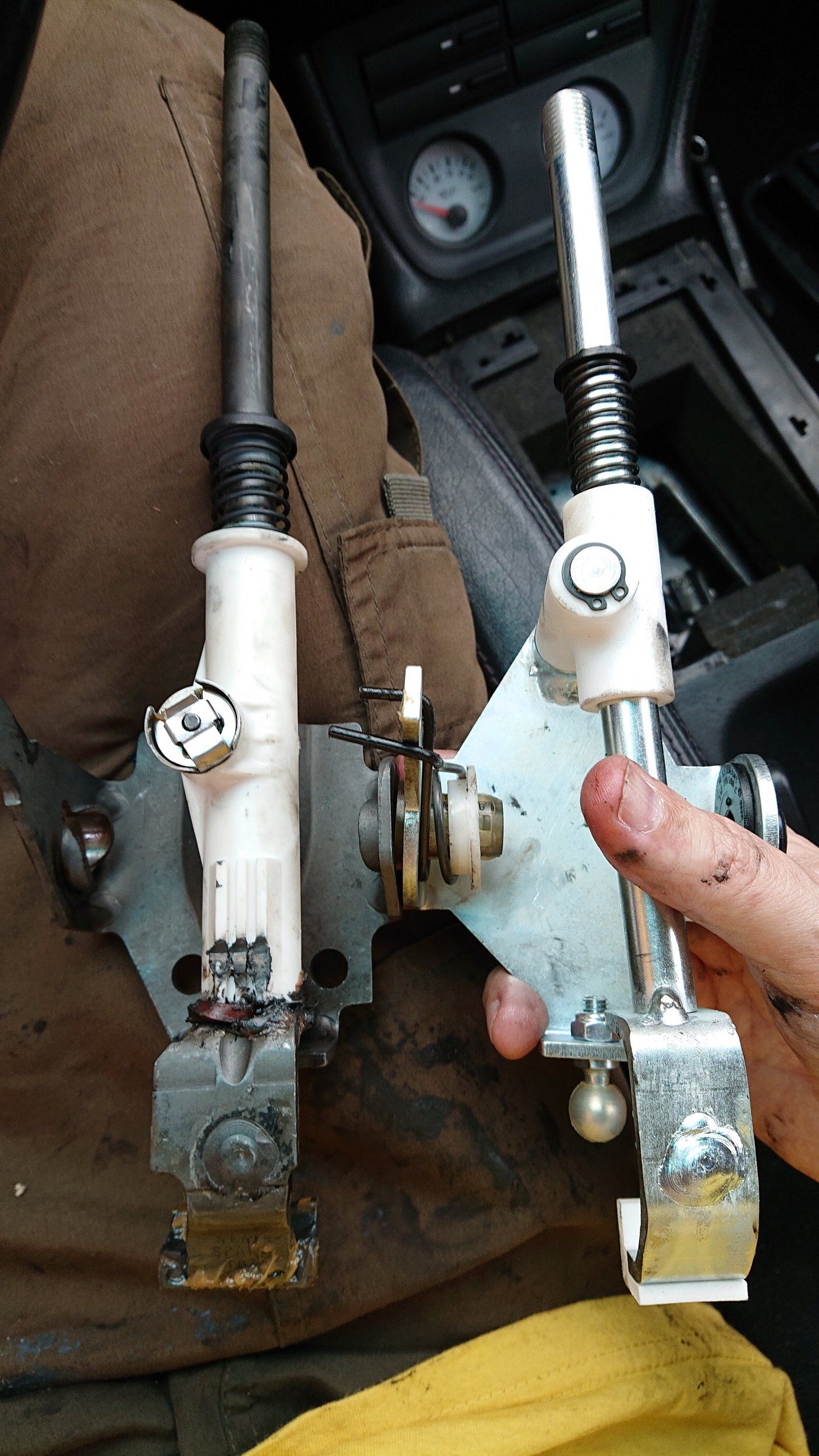

Finally got around to replacing it. It was a bit fiddly, but everything was doable from inside the car, only having to remove the gear knob, plastic cover and rubber cover directly over the gear lever.
There's one golden bolt holding the long rod in place. There are two bolts holding the shift assembly in place - those need to be loosened, to get the right angle to pull out the long rod. There's one metal clip holding the wire in place at the bottom of the stick.
The new stick is a lot shorter, and the anchor point sits a lot higher, resulting in very short shifts. Due to the shorter stick, I had to cut off part of the rubber cover. Ideally I'll need to make a new leather cover as well, since there's a lot of excess material - and the faux leather has mostly disintegrated by now.
I've posted a side-by-side comparison of the two units. The new one is on the right. The spring and plastic inserts were transfered from the old unit.
At the bottom of the old unit, there was some rubber band which had broken - I wonder if that was the main culprit behind the lousy shifting.
I didn't get to test drive the car yet, but the shifts feel a lot more precise now - getting into 1st gear is no longer a problem, but finding 5th seems a bit tricky. Also takes a bit of pressure to get into reverse, but I'll live with that.
