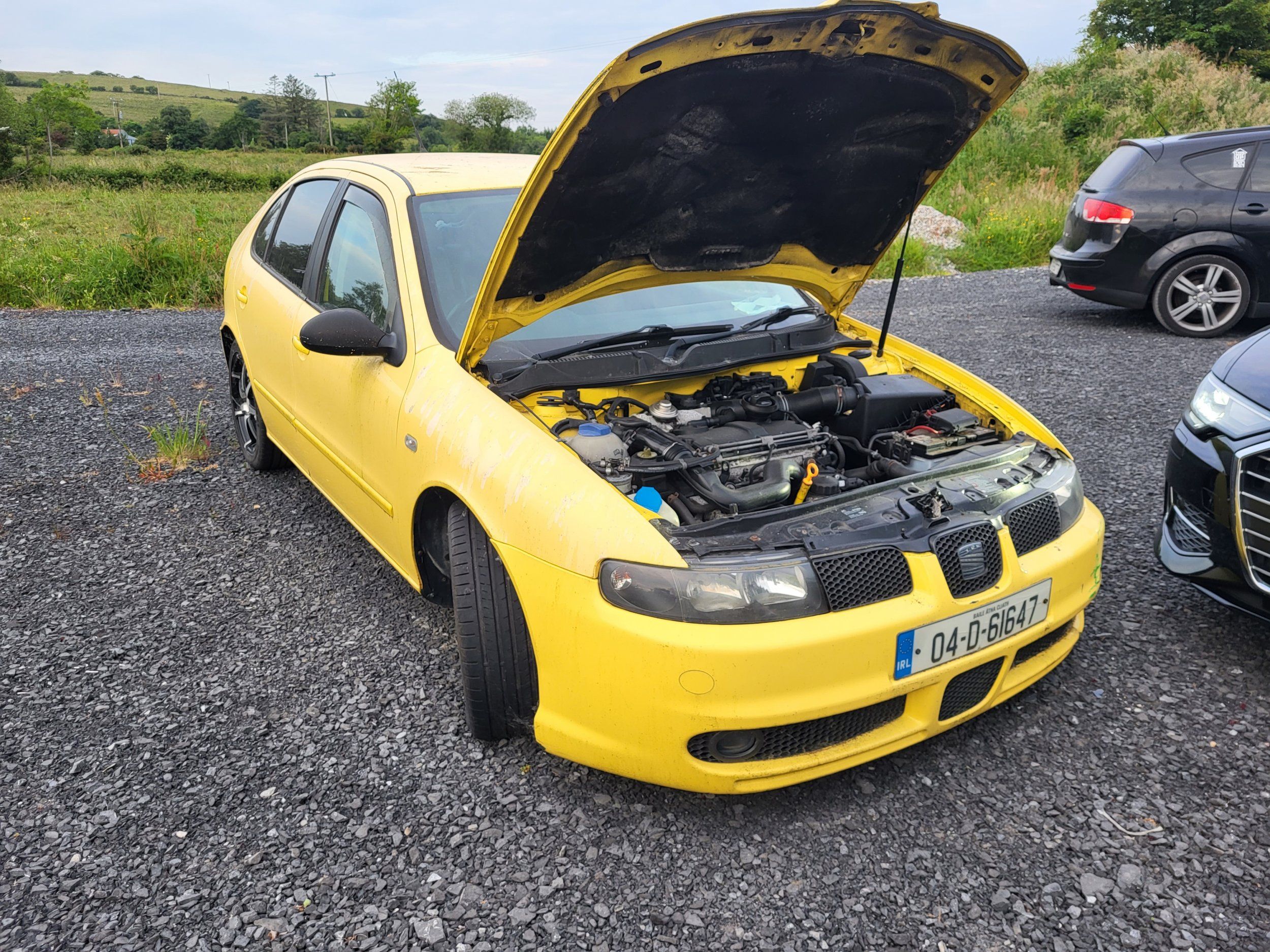

Hello everyone
I just recently joined (about 5mins ago as I'm writing this) and I want some help/suggestions
I think I might've scored one of the rarest barn finds when it comes to SEAT cars in Ireland. I have found a MK1 Seat Leon FR Topsport with the PD150 ARL in Yellow for a price I just couldn't resist, yall know how that goes :ROFLMAO: . I know there was a blue one in the country up until 2 weeks ago (yes the only one) but was wrapped around a tree so there isn't any left sadly.
This car has been parked up for 3 years (it is very clearly obvious) but it runs well and literlly everything works. (other then a burst boost pipe but thats a common issue and I have one on the way. I will eventually replace it with a full airtec intercooler that has solid pipes so it will never be an issue.
My plans for it is to have eventually a fully built engine and it making around 350-400bhp. I'm kinda digging the rat look of the bad paint but I'll probably get it fully undercoat protected and painted as well.
Some suggestions I'd like to ask for -

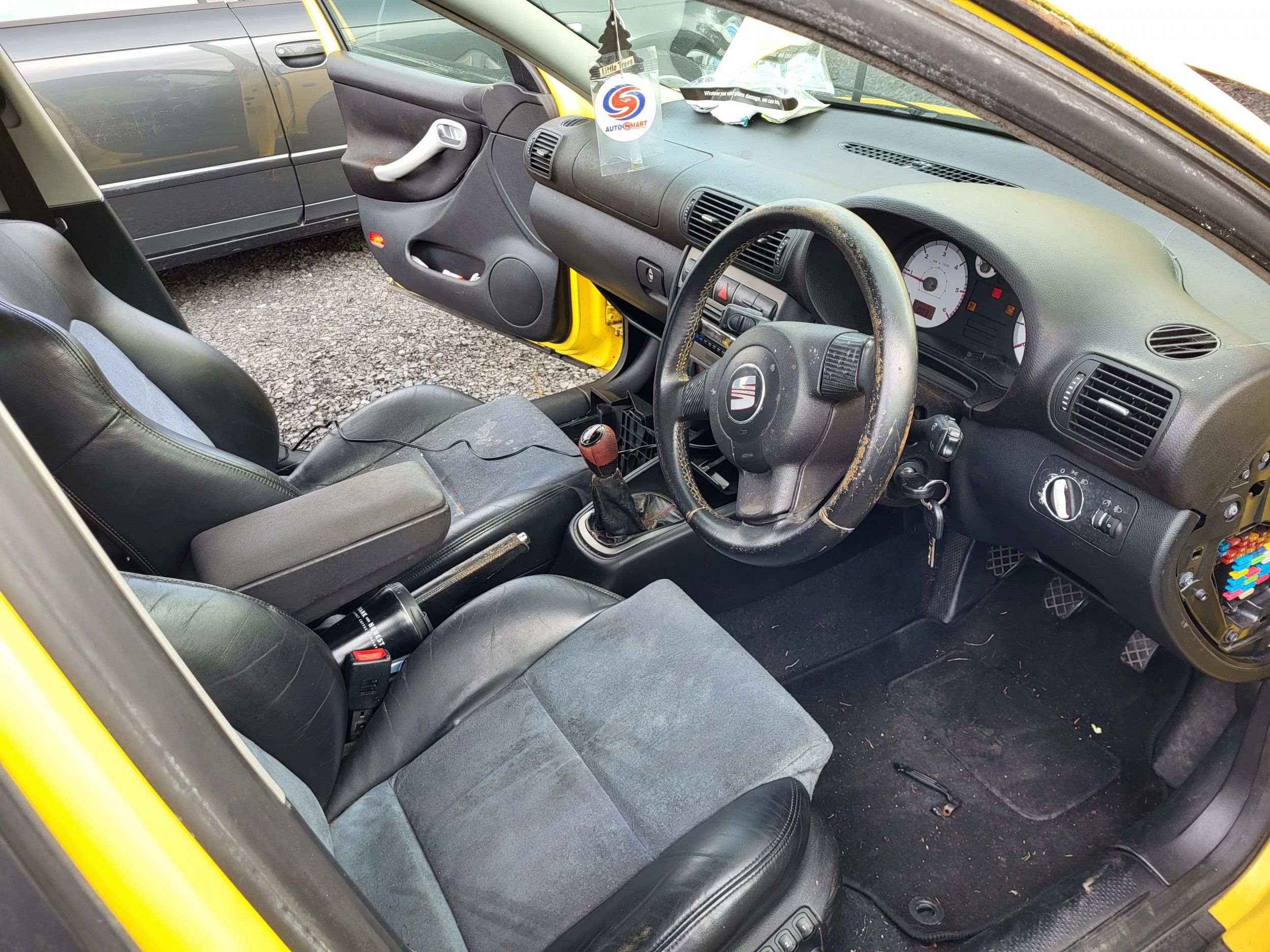

1. The steering wheel is from a mk2 leon. Although it is nice, I want it to be period correct so any suggestions for steering wheels or maybe if anyone has a mk1 steering wheel just taking up space, I'd be more then happy to take it from them.

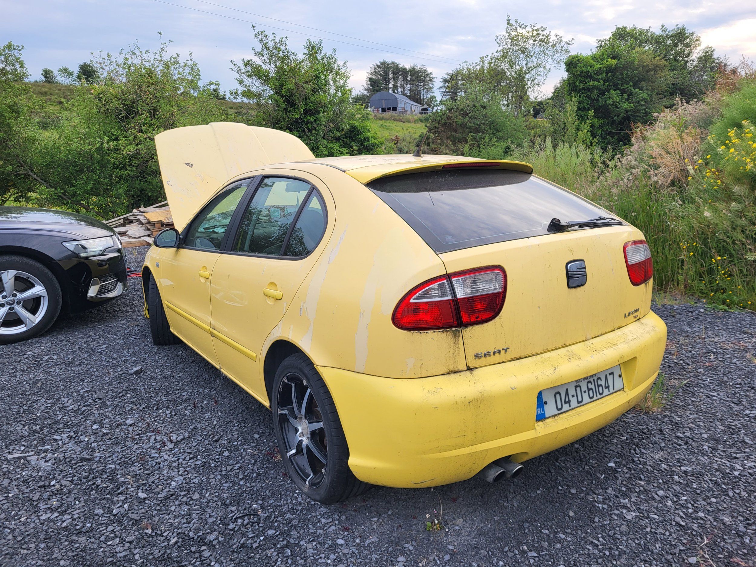

2. The wheels are horrid and terrible in everyway, so I'd like some suggestions. I'd like the wheels to be either 17", 18" or even 19" and needs to be able to take a good wide tyre, something in between 225mm - 255mm in width. I'll roll the fenders eventually anyway because I'll be lowering it so don't worry about that.
3. I have a bucket list of suspension parts. I have a fair idea for shocks and lowering springs I'd want, same goes for a polybush kit for the car. The shocks would be some bilstein shocks (Front - BILSTEIN 651860613970) (Rear - BILSTEIN 4025258614720) and the lowering spring kit is from Eibach, I believe , their sportline kit, 50mm front and 30mm back. I have a kit from eibach on my current car and it has been very nice so I want to stick with them, unless someone has any other suggestion. Same thing goes for the shocks, I have a very nice set from Bilstein and they have been very nice too so I want to stick with them as well. I don't want coilovers because I think they are stupid for road use and not neccassery. A nice good set of sport shocks and springs I think are much nicer for road use. Again, I'd love to hear other peoples opinions and suggestions for those. For a polybush kit, I am kinda stuck but I have found one kit that I think will be nice. However, I'd like some suggestions for a full kit.
4. If anyone knows a friend, family member, cat, dog, I don't care who but I want and need a Curpa R front bumper. If anyone knows where to get them because I have surfed, waved, slid and searched all over the interwebs but have yet to find one, maybe here someone can find one or knows someone who has one, or someone here might even have one. But if anyone can point me to the direction of one, I swear I'll offer one of my kidneys for it:ROFLMAO:. And along with that, if anyone has or knows about the sideskirts for a Cupra R and rear bumper as well, I will be very greatful too.
5. Are there any things that I should look out for and do as preventative maintenance? I do know rust can be an issue with these cars from time to time but this car is really mint from underneath and for now, it won't be an issue. I was looking back on some recalls SEAT had for the car and I saw there was a recall for the bolts that hold together the high pressure pumps. I'm gonna get new bolts anyway to be safe and get new seals while I'm at it too so that won't be an issue but anything from people who have experience with common issues or just know things to look out for, I'd very much appreciate it
For now, this is all I can think about to ask, if there is any more, I'll probably make a new thread and link this one to it.
Thank you in advance to everyone here for helping in the past for me as I found random threads!!
