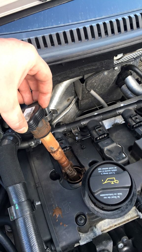

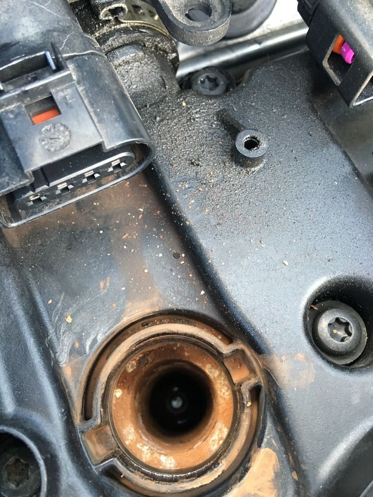

So today I decided to change the plugs and when I removed the coil pack on cylinder 1 I was presented with this!
At first I panicked and thought it was something like a head gasket so after a quick call to my mate, he said that when the seal goes on the coil pack that water gets in and does that.
I changed the plugs and moved the culprit to cylinder 2. Cleared the faults and went for a run. It logged a misfire in cylinder 2 so it's the coil pack. I'll pick a new one up tomorrow and hopefully I'm back to normal!
OldManPooley
Jul 9, 2015
187
Hopefully an easy fix then mate.
Are you running with no engine cover because water has been getting on to that coil pack from somewhere?
Cammy_
Dec 6, 2014
39
Running with an engine cover. Any water would have got in round the oil filler somehow I reckon.
I do have an evoms intake coming this week So the cover will be gone.
It looks like this coil has been changed before as it's different to the rest. It's probably just a cheap one.
OldManPooley
Jul 9, 2015
187
have you got a mouldy bonnet lining? And are you aware of the water that gets in from the plastic part of the bonnet?
