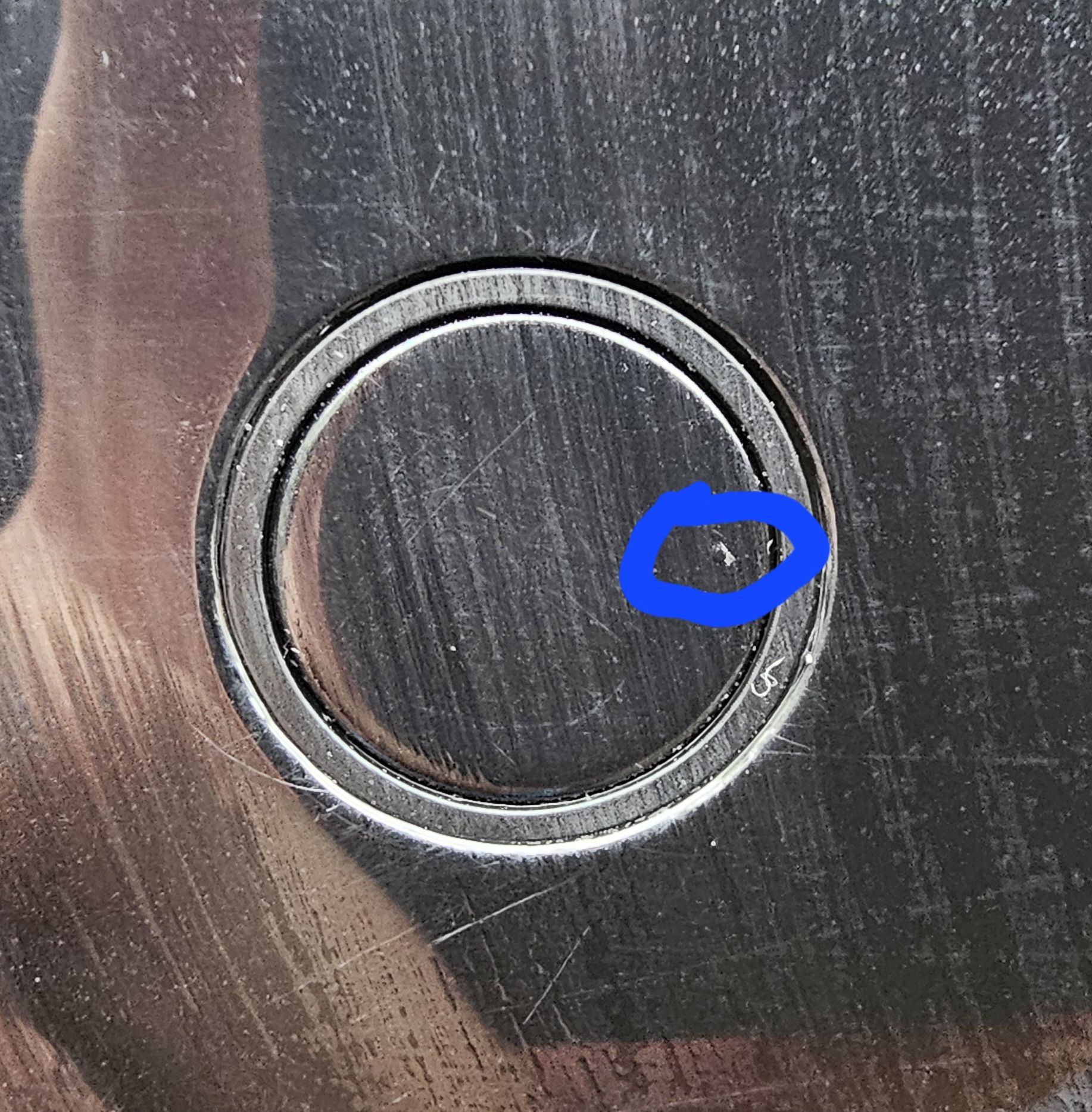

After five week wait for check on parking sensor at rear one found to be faulty, very smal mark size of pin ***** on N/S sensor, difficult to know how this happened. The hard part to deal with is cost £111.00 plus painting, fitting and vat becomes £320. My point to raise is quality of sensors, surely outside surface should be hard enough not to be affected by small mark and sealed to prevent water ingress as mentioned by other owners. Good to have but not at such high replacement cost

Oh I have the exact same tiny pin ***** of damage and had the exact same shock at the repair cost.
Perhaps we can combine forces and show that the sensors are not fit for purpose.
I've done over 200,000 miles in vehicles with parking sensors and never had them fail - until now.
I can maybe understand front ones going with debris hitting the car but a rear one, that is what gets me. What kind of stone bounces backwards onto a car?!

I have to accept small pin sized damage as there were hair line scarch marks in area now polished out, cannot think where this could have happened, can only imagine parked near hedge or bush. I agree with your thoughts, sensors not to high enough standard, outer surface requires to be harder and sensor water resistant, have noted issues regarding water igress. All garages pressure wash cars when in for service or pree delivery.
My other point, if dealer had sensor in stock when car being inspected I would have probably agreed to replace.
Has to be ordered, painted and dissembled again to replace, double labour cost.
