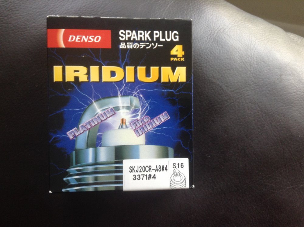

https://www.briskoda.net/forums/upl...mb.jpeg.adddbefe22671d4939436279c29417d1.jpeg

I was just passing general comments about engaging with a main dealership's workshop, I am not a 1.4 Twin Charger owner so know nothing about spark plug choices for standard engine, but there has been a lot written on this forum, and lately on the Skoda forum on how to minimise risk of engine damage by maybe at times using parts other than what SEAT say should be used/fitted.
Although, in your case, if getting a SEAT dealer to service your car, I'd be inclined to leave the choice of spark plugs up to them and let them supply all the service parts as in the event of a major engine issue later down the line, SEAT would probably cast this "customer supplied the spark plugs" which will appear on your bill, that is all.
So using these Denso plugs would probably be best left until you get the car back - Denso is also a supplier to the engine plants, I can't say if that includes this engine - though for some reason I tend to check if NGK is an option in the VW Group spares listing for my engines, and if so buy them.
