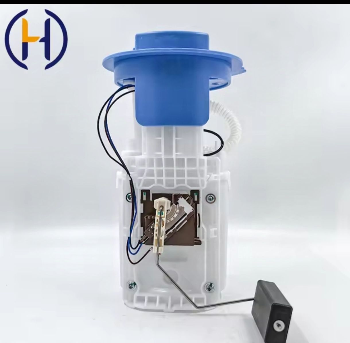

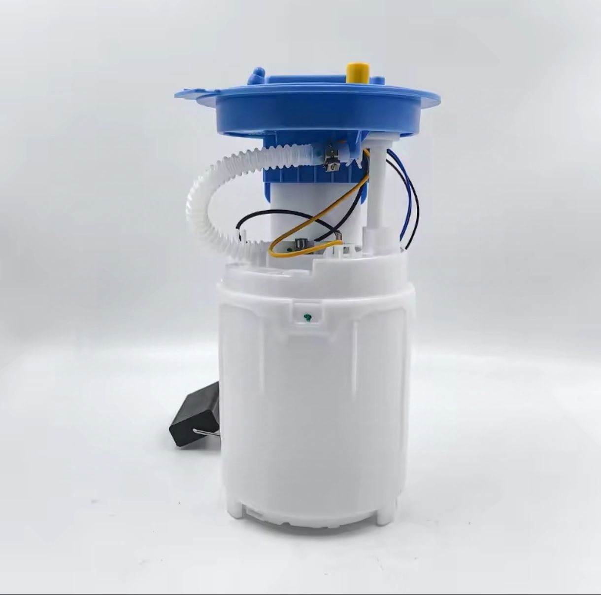

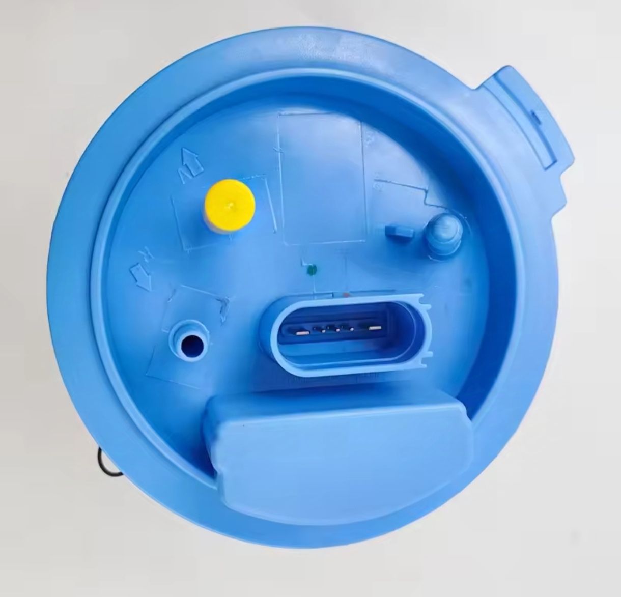

Hello to everyone, this will be my first post on a forum ever, so as the title tell i have a question about LPFP assembly (basket type).

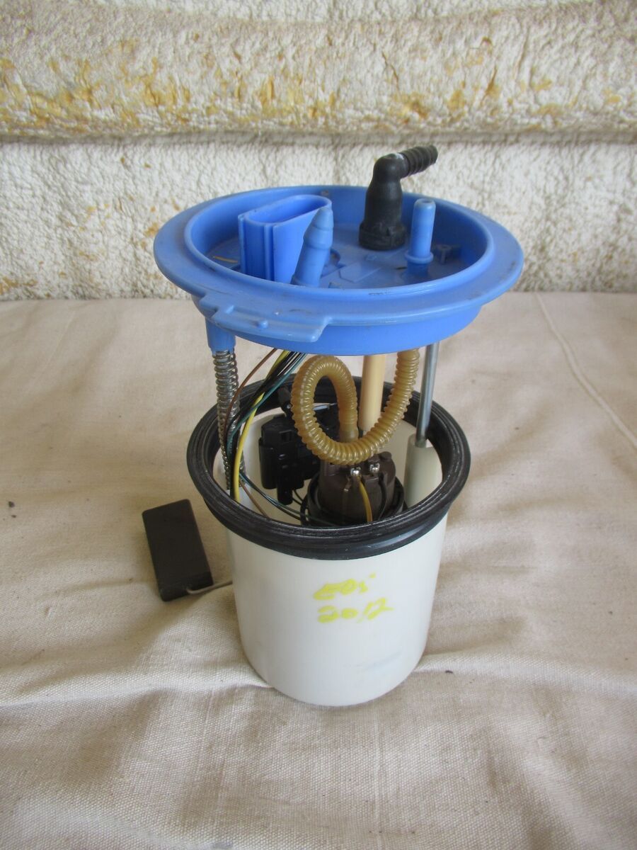

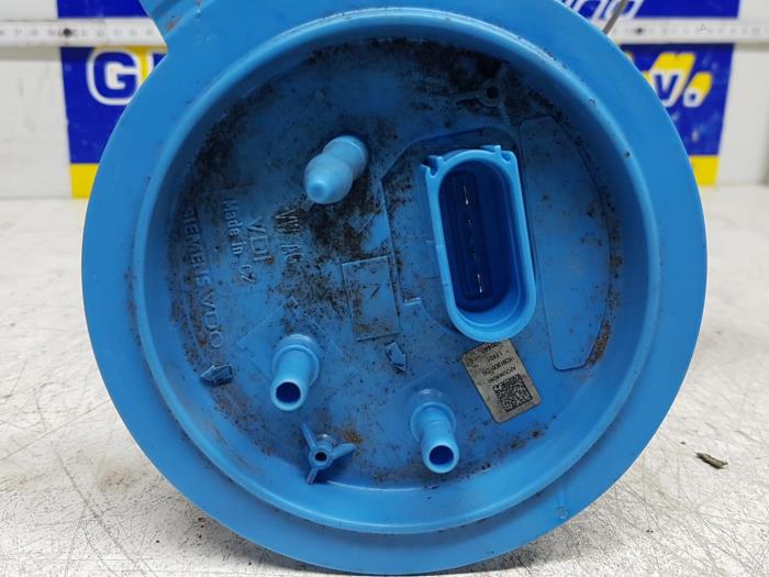

I have a 2009 leon cupra BWJ engine, i want to upgrade my LP fuel pump, i saw that theres different types of pumps for different types of baskets, my fuel pump assembly part number is **a2c53165911**, its the one with the shroud plastic around the pump itself that you need to break to switch pumps.. i saw a pump basket that easier to work on and could accept the bar-tek fuel pump, its part number is **1k0919051ap**
I was wondering if i could use it, since it easier to work on and there is not much modifying needed as the one that i have..
Ill try posting some pictures of the pumps so you would see what i mean,
Thank in advance for any help, and sorry if i posted in wrong category or something.
Pump number - a2c53165911
Pump number - 1k0919051ap
