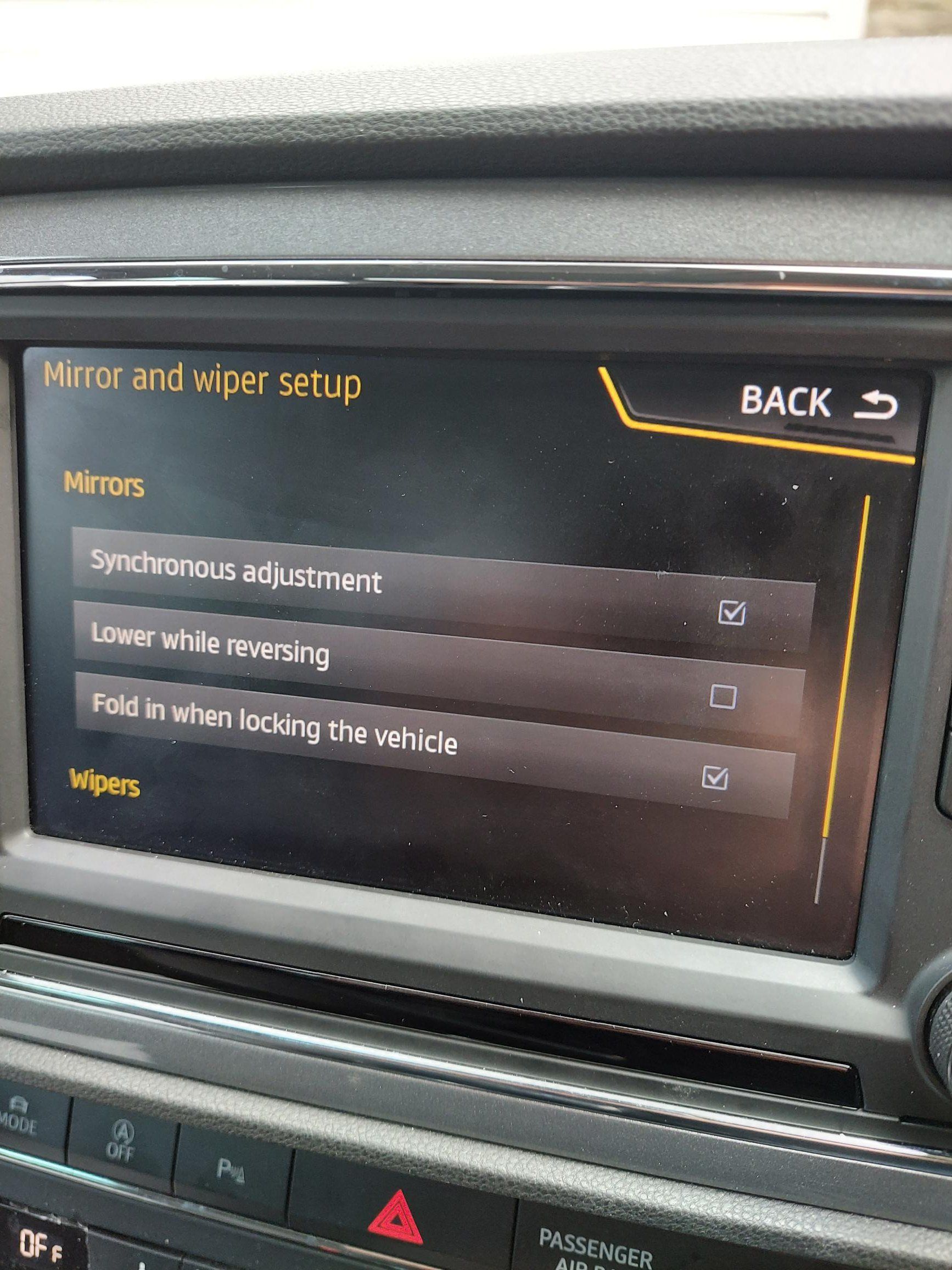

lower while reversing menu remove ?
how can i code this out it never worked properly as no memory seats, i have checked all coding and and turned it off but still shows on the screen.

pure guess but pre facelift cars the instructions show for control unit 09
Adaptation
6 - Access control 2
7 - Menuesteuerung Spiegelabsenkung - (Change value to Activated) so i would guess you change this to off
on facelift cars
5 - Adaptation
6 - Spiegelverstellung
7 - Menuesteuerung Spiegelabsenkung - (Change value to On) again I am guessing this removes the menu item.
I would also do a full power reset (I think you hold the off button for a couple minutes) to pick up the changes if it dont work straight away.

cheers in vcds ? which module ?
well i am a hybrid :D
prefacelift car
facelift mib2

cheers in vcds ? well i am a hybrid :D
prefacelift car
facelift mib2
just have a look at the BCM and see what it shows you under control unit 09 its either access control 2 or Spiegelverstellung either way the menu item is the same name.

that worked cheers

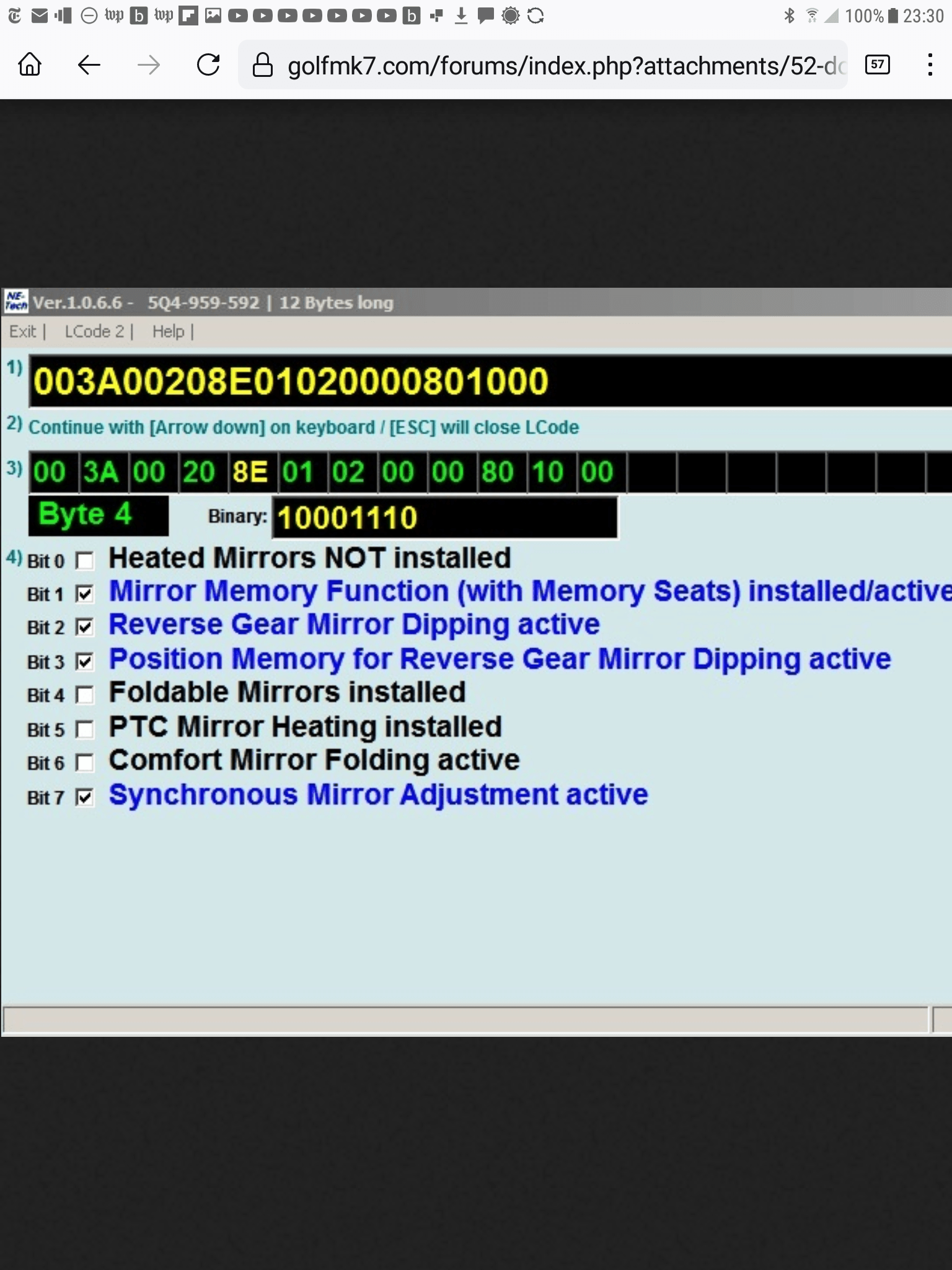

Tell
There is a bit of extra code in the long string for memory seats:
In this bit of text:
Coding. Get the bit codes into byte 04. To get "long coding" entry method hit top right slider 0-1 to 1 for coding input screen. Byte 04, toggle on bits 2 & 3. Save, check mark. Green tick. Note that for memory seats enable bit 1 if you don't have memory seats don't enable it.
In here:
That's with Obdeleven coding so just find the long string and twiddle with it. I converted VCDS to Obdeleven for that... mind I got top view it was really for training and Atecas were never fitted with the proper motors so mirror dip drifts with repeated use.
Sounds like you had it coded for memory seats, that pesky bit probably.

I have a 2014 motor and no memory seats but have a read of this post by Don (the god DV52) you need to have memory module for this to work
Tell
Yes I Christened it the Don test and tell everybody on here who does it when they shouldn't 🤣. Basically they come from Leon 3s to Ateca, want it and it won't do it.
But that memory bit for memory seats may be why the dip wasn't working. Something different. The driver door has the memory seat coding in the long string that changes for mirror dip. Just how it works out.
There isn't universal coding for mirror dip it varies in that bit. So the likes of one click apps get stuck if they don't take that into account or publish mods don't or swap them using the wrong version etc. I suspect Leonlad may have the memory seat version of the mod, when they need that bit changed. VCDS you might have to do some fancy hex stuff to work what I said into VCDS terms. Obdeleven Pro you move along that string and toggle the right bit. You'll find it in VCDS mods... Like this:
The other coding suppress the mirror dip menu but if the wrong coding is in the car it might just need correcting @leonlad leonlad

Cheers i am pretty sure i tried all this in the past apart from that memory checking part. Think i will try it another day the mib upgrade took more time than it should already :ROFLMAO:
Tell
Whilst looking at it you can check whether it's got the correct positioner by doing the Don test
The wrong motor means it drifts doesn't mean it doesn't work. Reckon Leon 3s all have motors capable of doing that, later it was some Seats they fitted different ones one.
It's the live data side of Obdeleven tells you that from the positioning feed back which you read off. Pass on how you do that with other coding devices. No feedback if it's got a motor in it that doesn't support mirror dip. Like a servo that repositions the mirror accurately.
