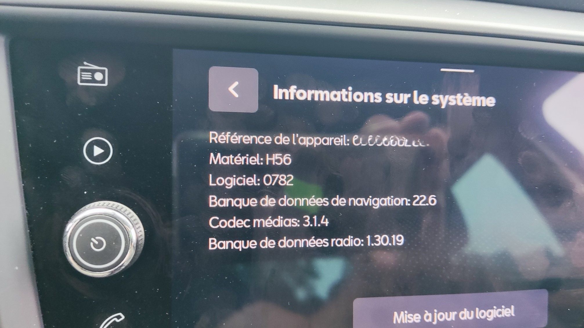

Hi,I bought seat ibiza 2021 one week ago.
Thanks to thread I understood how to proceed with upgrade, but I'm still confused about version to use.
I'm currently using version 782
Seat offical site says latest is 841 (https://www.seat.co.uk/owners/seat-connect-app/ota-software-updates/ibiza-arona-ateca-tarraco.html)
mibsolution.one says latest is 870 (https://mibsolution.one/#/1/9/MOI3/LG/Seat MIB3OI 0870).
mib-helper.comsays latest is 890 (https://mib-helper.com/index.php?train=MOI3_EU_SE_R7820L#details)
Can someone clarify this point?

not sure to get your point.
in what I listed all are 0XXX.
Any way, I can't find 890 so only remains 841 or 870.
and if I understood correctly the saver way is to spent about 70€ to enable 1 year "Seat Connect" and been able to use "OTA" upgrade.
Thanks
Tell
