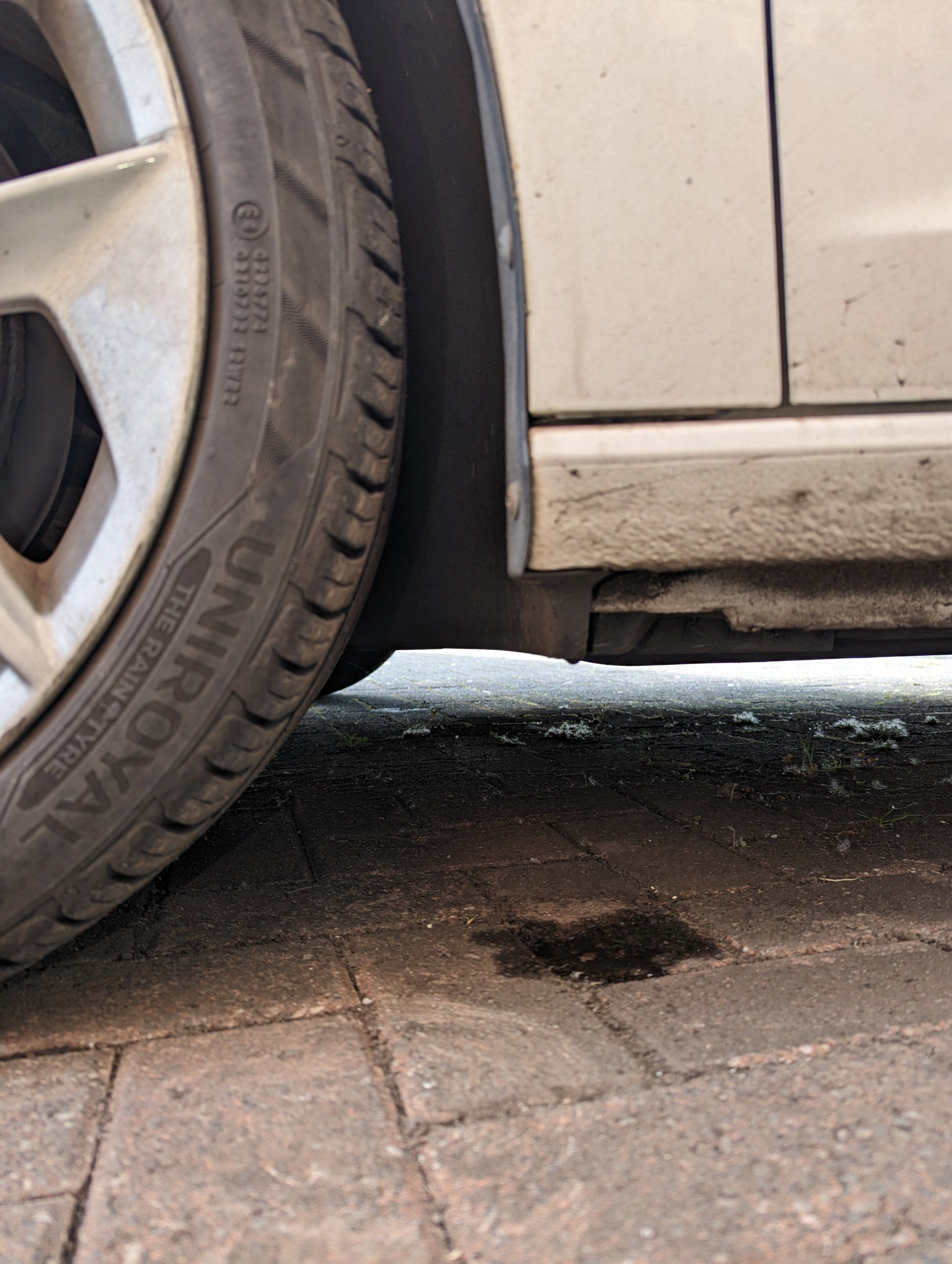

Hi All,
Had the issue of the rear wiper not working for a few months now despite the motor working.
Boot connection fine, passenger footwell connection fine, connection from water bottle is also fine... however I have a drip when I press rear wiper at passenger wheel arch.
My question is where exactly is the connection near the wheel arch that could be causing this please and is it easy to get to?
Weirdly I still do get one tiny spittle of water at the rear washer when I press it but its only a micro amount.
Thank you very much for your guidance in advance

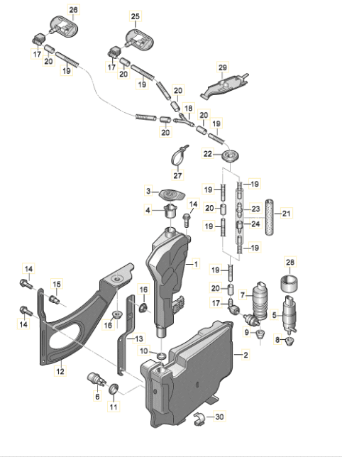

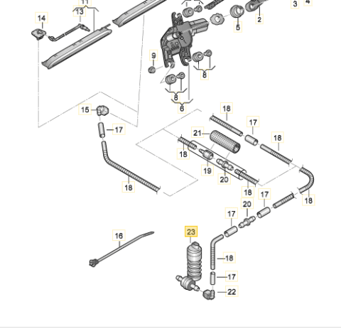

I can't see/don't know where these connections are.
I would take out the wheel arch liner and follow the tube from the pump. Would guess a split hose/leaking joint or someone's put a wheel arch liner screw threw the hose?
Number 7 pump 1K6955651 is for cars with rear wash wipe.
Wiper and washer system for / rear window
18 1J0955751D Corrugated pipe 6X0,75X10000MM
17 2D0955962 Hose 3,8X2,1X1300MM
